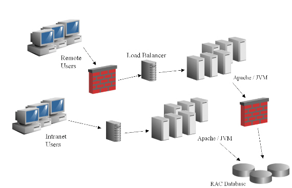

Performance issues can potentially occur across any or several different areas of the Technology Stack, or may be restricted within Functional Code. For example (but not restricted to)
  • Architecture issue (e.g. high latency WAN, firewall)
  • Operating System problem or resource constraint
  • SQL or general RDBMS configuration issue
  • Database Deadlock
  • Apache Listener

These are the more complex issues and will normally require additional information (and patience) to resolve.  We will need the same information as listed above, but also:
  • Description of your System Architecture and network diagram
