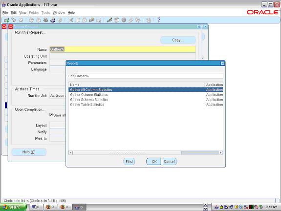

gather schema/table statistics:
Back to Gathering Database Statistics
When gathering the statistics for the entire applications database, we must use the Gather Schema Statistics concurrent program.  Only the Gather Schema Statistics and Gather Table Statistics should be used. Do not use the Gather Column Statistics program.

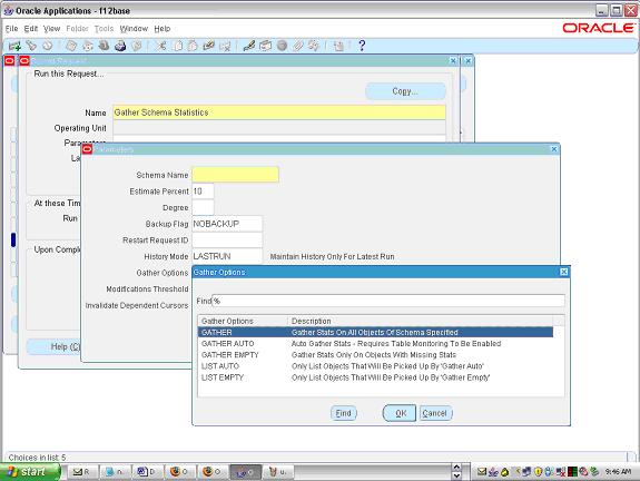

gather auto:
Although there are a number of options that you can set, we recommend selecting  the GATHER AUTO option.
