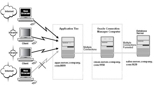

Oracle Connection Manager OCM example architecture acting as a firewall
For example:  Granting and denying access to the a database is crucial for a secure network environment. You can configure Oracle Connection Manager to function as a firewall, where it grants or denies clients access to a particular database service or
a computer based on a set of filtering rules.  In the diagram above, Oracle Connection Manager has blocked access to the fourth client from the Internet.
