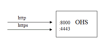

For example, given the following conditions for your Oracle E-Business Suite Oracle HTTP Server listener configuration:
- HTTP requests use port 8000
- HTTPS requests use port 4443

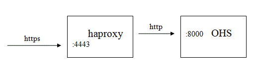

Then, you may perform the following:
- Shutdown the Oracle HTTP Server HTTPS listener (port 4443)
- Install, configure and start HAProxy to listen on port 4443
