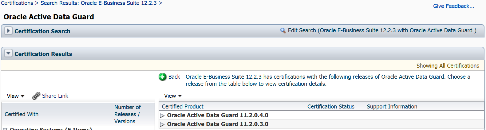

We’ve recently added Oracle Active Data Guard as a searchable product for certified combinations with Oracle E-Business Suite. That’s good news for those of you that are looking for the latest information on certified combinations of Oracle E-Business Suite and Active Data Guard.
From the Certifications tab on My Oracle Support, you can search for certified combinations of products, such as Active Data Guard, with specific Oracle E-Business Suite versions. For example:
Step 1. Log in to My Oracle Support
Step 2. Click on the Certifications tab
Step 3. Add your search criteria. For example: Add Oracle E-Business Suite to the Product List, add Release 12.2.3 to the Release List and optionally add your platform to the Platform List.
Step 4.Click Check certifications with another product
Step 5. Add Oracle Active Data Guard to the Product List and optionally add the version to the Release List
The above search will list all versions of Oracle Active Data Guard currently certified as shown in the following screenshot:
