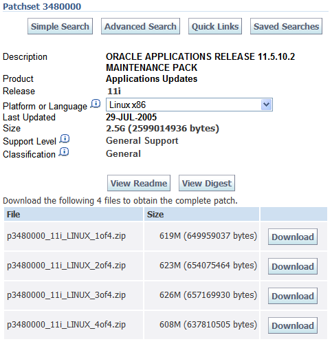

Premier Support for Oracle E-Business Suite Release 11.5.9 ended in June, 2008.  If you are currently running 11.5.9 or earlier and your immediate plans do not involve an upgrade to Release 12, then it’s a good idea to move up to the terminal release of Apps 11i:  11.5.10.2. This will ensure you remain supported and can make the most of any technology stack and functional upgrades.  A lot of what you do as part of an upgrade to 11.5.10.2 will also ease your transition to Release 12, so this upgrade can be considered as a Release 12 prerequisite exercise, too. Critical patch updates, roll-up patchsets (RUPs) and new technology stack certifications are still being released for Apps 11.5.10.2, and the more up-to-date your system is, the easier it will be to apply these when they come along.  This article takes you through some of the best tips from Oracle Support to ensure a successful upgrade to EBS 11.5.10.2.

The main part of the upgrade to EBS 11.5.10.2 is performed by the upgrade driver supplied in patch 3480000. This should complete without error — no jobs should be skipped or ignored. If you find yourself having to skip jobs without a very good reason, this suggests something that should have been performed earlier has been omitted or has failed.  Skipping a job may have consequences for subsequent jobs as data or objects may be accessed by several workers during the upgrade driver. Accept the default number of workers unless you have a good reason not to. Substantially increasing or decreasing the number of workers you use may affect the performance of the upgrade driver.  While it may be a worthwhile exercise to experiment with the number of workers you use, you should always use the default number as your benchmark for performance.
