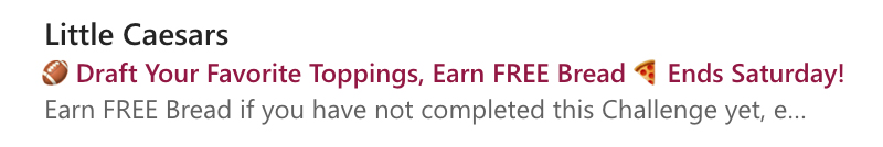

 Emojis and special characters. Many emojis and special characters have names that don’t roll off the tongue very well. For example, Siri reads the following subject line as “Football draft your favorite toppings, earn free bread pizza ends Saturday.” The reading makes it sound as though Little Caesars has a new offering called bread pizza.
Example of how emojis can affect how an email subject line is read by a voice assistant

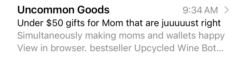

Onomatopoeia. Voice assistants don’t always correctly interpret sound-based words like “Grr” and “Psst,” especially when they’re embellished in any way. For example, Siri reads the following subject line as Under 50 dollar gifts for Mom that are jue-ust right. That’s confusing and distracts from the rest of the message that follows.
Example of how creative spellings can confuse voice assistants

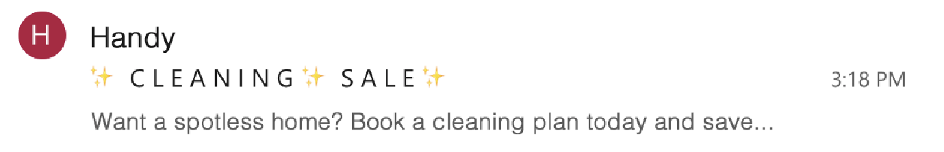

Irregular spacing. Particularly in between the letters of a word, extra spacing can cause voice assistants to not recognize words. For instance, Siri reads this subject line as Sparkle sea ell ee ay en eye en gee sparkle ess ay ell ee sparkle.

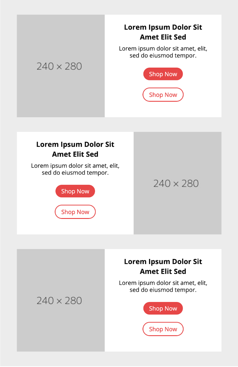

Voice assistants read content blocks and table cells sequentially. If not properly accounted for, this can cause content to be read out of order.
In the example below, for the desktop version of the email, the modules have been arranged into a common S-curve design that guides the subscriber down through the message in a back-and-forth pattern that’s engaging. To get the images to all be above their corresponding text for the mobile version, S-curve designs are often coded using RTL directional attributes so the image on the right can move to the top on mobile devices.
Example of how to code an S-curve design so it's accessible
However, this causes issues when a voice assistant or screen reader processes the content, as it will be out of order. That can be confusing. The solution is to use a mobile show/hide image instead, where the mobile image is hidden above the text on desktop and the desktop image is hidden on mobile. This creates the same visual experience on both desktop and mobile without the confusing experience for listeners.
