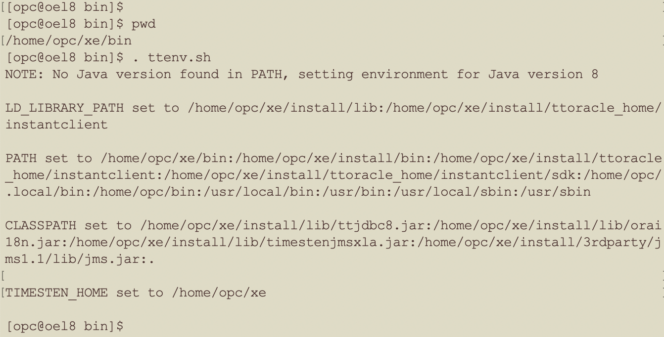

Set the TimesTen Environment
This blog assumes that TimesTen XE has been installed in the users home directory, eg /home/opc/xe
You need to set the TimesTen XE environment before you can use the TimesTen XE utilities.
cd ~/xe/bin
. ttenv.sh
eg
ttenv.sh

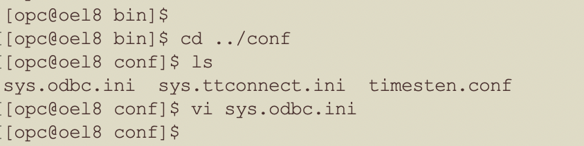

Edit SYS.ODBC.INI config file
The sys.odbc.ini file is in the $TIMESTEN_HOME/conf directory. eg /home/opc/xe/conf/sys.odbc.ini
edit sys.odbc.ini

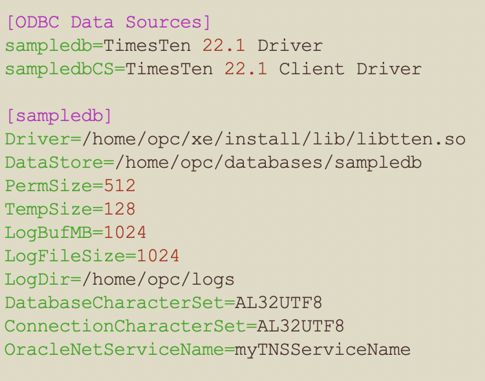

Edit the sys.odbc.ini file to use the following values
  • Data Source Name sampledb
  • DataStore /home/opc/databases/sampledb [make this the same as the Data Source Name]
  • Driver /home/opc/xe/install/lib/libtten.so [This path is generated by ttInstanceCreate]
  • PermSize 512      [This is arbitarily small so that not much RAM is need for your initial TimesTen XE database]
  • TempSize 128      [This is a small value. It could be many GB for large aggregations with many users]
  • LogBufMB 1024   [This is a good default value]
  • LogFileSize 1024 [Make it the same size as LogBufMB]
  • DatabaseCharacterSet AL32UTF8   [Use the same value as your Oracle database for cache, else use AL32UTF8]
  • ConnectionCharacterSet AL32UTF8 [Use this value unless you have a good reason not to]
  • OracleNetServiceName myTNSServiceName
This trivial example will require about 2 GB of RAM [512 MB + 1024 MB + 128 MB + extras] for a tiny TimesTen sampledb database.
Larger databases, ie larger values for PermSize will require more RAM.  Unlike most databases, TimesTen does not use a buffer cache to get data blocks from disk as needed.  All of the data needs to be in memory all of the time.  This is a space-time trade off. TimesTen XE will tend to be about 10x faster than any traditional database, but will tend to need more RAM.
sys.odbc.ini
The data source name [DSN] is sampledb.
The DSN is the parent object and the set of attributes [eg Driver, DataStore etc] below that all belong to the DSN.

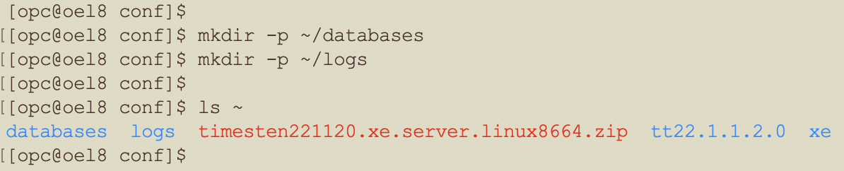

Create the directories for the data files and redo logs
mkdir database logs
The directories for the DataStore and LogDir attrobutes in the sys.odbc.ini file need to exist. eg
mkdir -p ~/databases
mkdir -p ~/logs
  • The DataStore directory needs to have the capacity for at least 2x PermSize
    • The checkpoint file is an exact copy of the shared memory segment
    • There are two checkpoint files, so the disk space needs to be greater than 2x the PermSize value
  • The LogDir needs to have the capacity of about 1x PermSize
  • The file system for LogDir needs to be fast enough for the TimesTen [redo] transaction log files
  • As IO from both redo and checkpointing can occur at the same time, care must be taken to not slow down the TimesTen XE database
    • Either the LogDir and DataStore should be on separate SSDs
    • or the both LogDir and DataStore can be on the same [high bandwidth] NVMe storage device

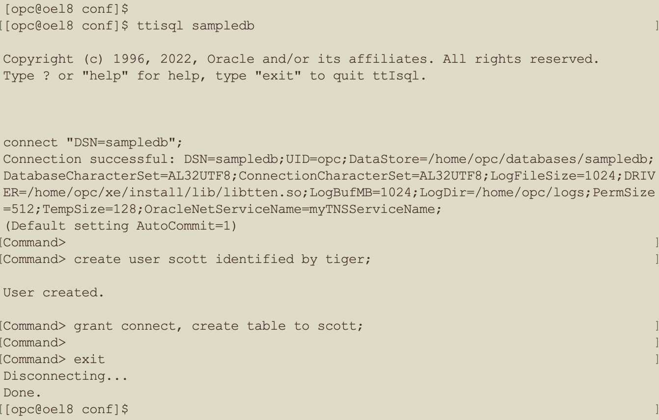

Create the database
The Linux OS user [eg opc] who installed TimesTen is called the Instance Administrator.  The Instance Administrator has extra database privileges [like SYSDBA for Oracle].
The ttIsql utility is a SQL shell like Oracle sqlplus.
Create the sampledb database via ttIsql as the Instance Administrator Linux OS user. eg
ttisql sampledb
create the database
  • You connection to a TimesTen XE database by using the Data Source Name, eg sampledb
  • As sampledb does not yet exist, the database will be created as a side effect the first time that you connection to it
  • Connecting directly to the DSN is like connecting to an Oracle database as SYSDBA
  • You want to create a user [eg scott] with minimal priviledges and create tables as that user
  • The default SQL Profile was used

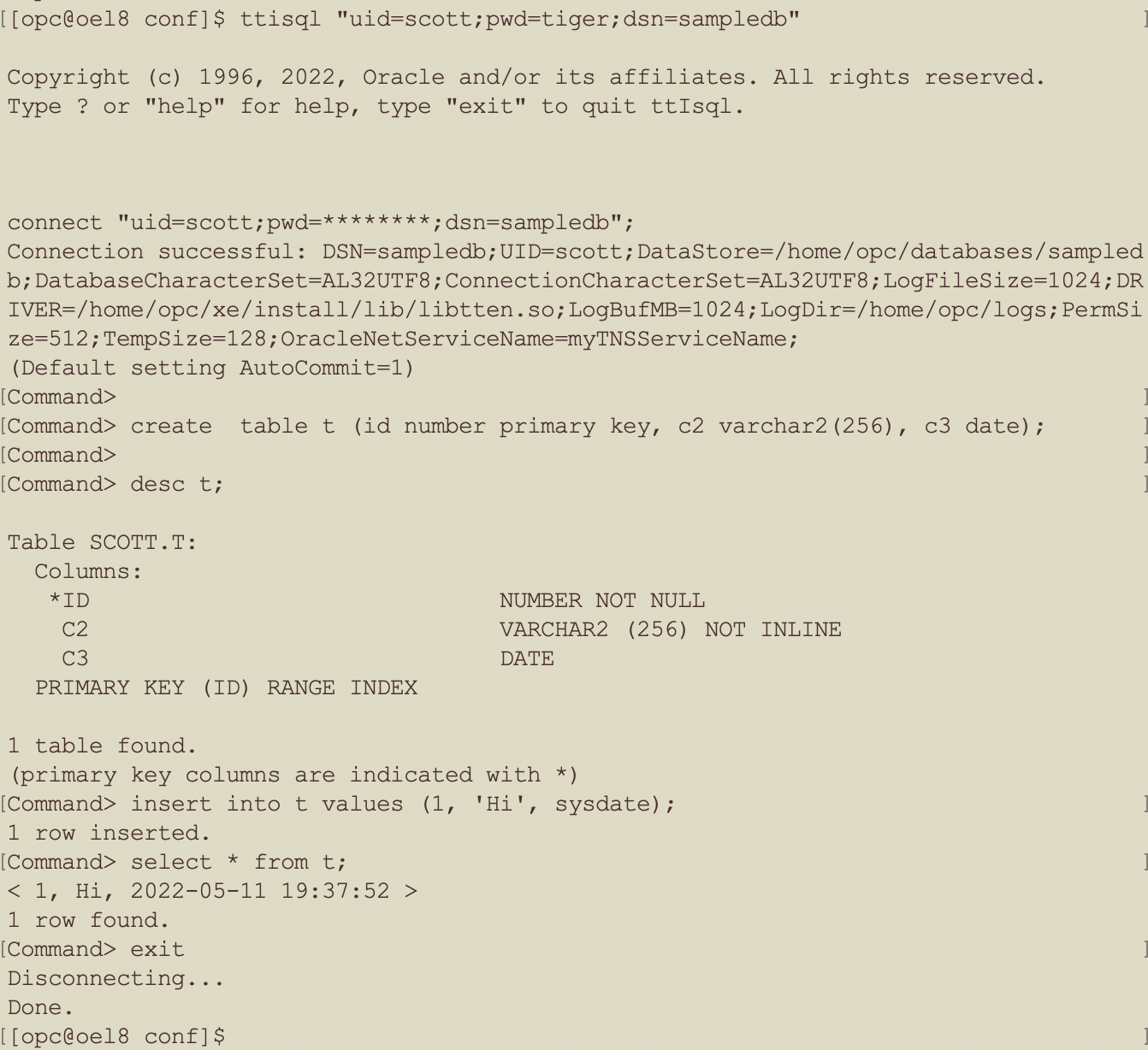

Connect as user scott
This example did the following:
  • Connected as user scott with password tiger to database sampledb
    • ttisql “uid=scott;pwd=tiger;dsn=sampledb”
    • This ODBC syntax with UID, PWD and DSN is equivalent to sqlplus. eg
      • sqlplus scott/tiger@sampledb
  • A trivial table was created
  • The table was described
  • Some data was inserted
  • The table was queried
You are now ready to do some more SQL with TimesTen XE.
