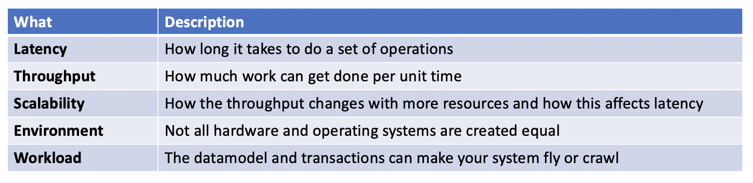

Database performance is really about five things:
Environment

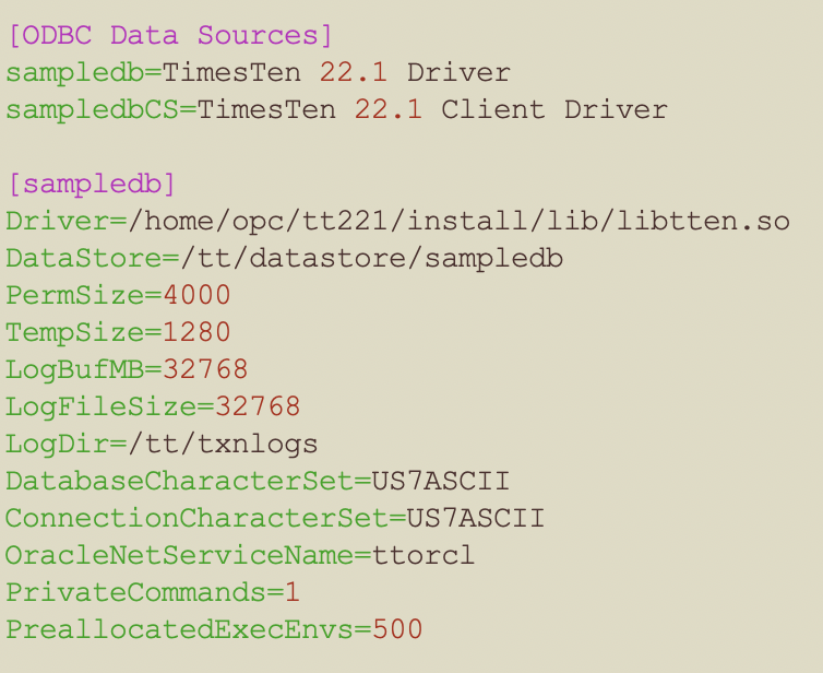

The TimesTen XE database configure file [sys.odbc.ini] was:
Both the database files [/tt/datastore/sampledb.*] and redo log files [/tt/txnlogs/*] were on a Linux ext4 file system using OCI block storage, ie NAS using iSCSI.

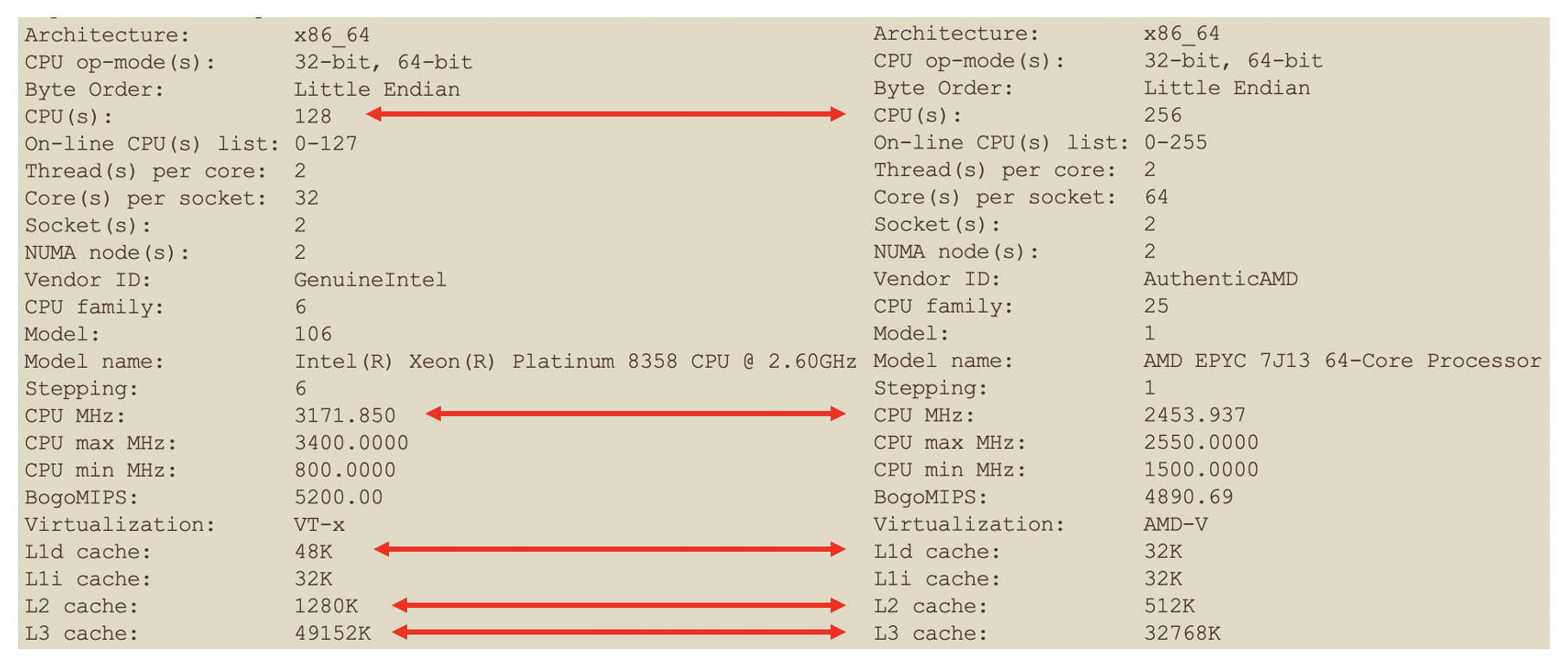

lscpu output
- The above image shows the output of lscpu for both the Intel Xeon and AMD EPYC CPUs that I used
- The red arrows compare the Intel Xeon Platinum 8358 and AMD EPYC 7J13 CPUs
- The Xeon has a higher base and max frequency than the EPYC
- The Xeon has significantly larger L1, L2 and L3 caches than the EPYC
- The Xeon has half the number of CPU cores of the EPYC

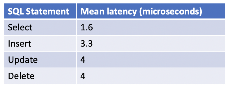

Latency
- The mean latency for 89 million executions of the TPTBM SQL select, insert, update and delete statements were used
- The benchmark warmed up for 30 seconds and ran for three minutes
- Running the benchmark for longer, [eg 30 minutes] gave the same results
- An even distribution was used to minimize L3 cache effects
- There were 10 million rows in the VPN_USERS table
- A random number generator was used to generate an even distribution of primary key values for the Select, Insert, Update and Delete statements
- This means that there was a 1/10,000,000 chance of each transaction using the same row
- This working set was large enough that L3 CPU cache hits were not a factor. ie a smaller working set could have skewed the results by using L3 cache rather than DRAM
- Inserts, updates and deletes take longer than selects as the database needs to deal with the undo/redo as these are ACID transactions

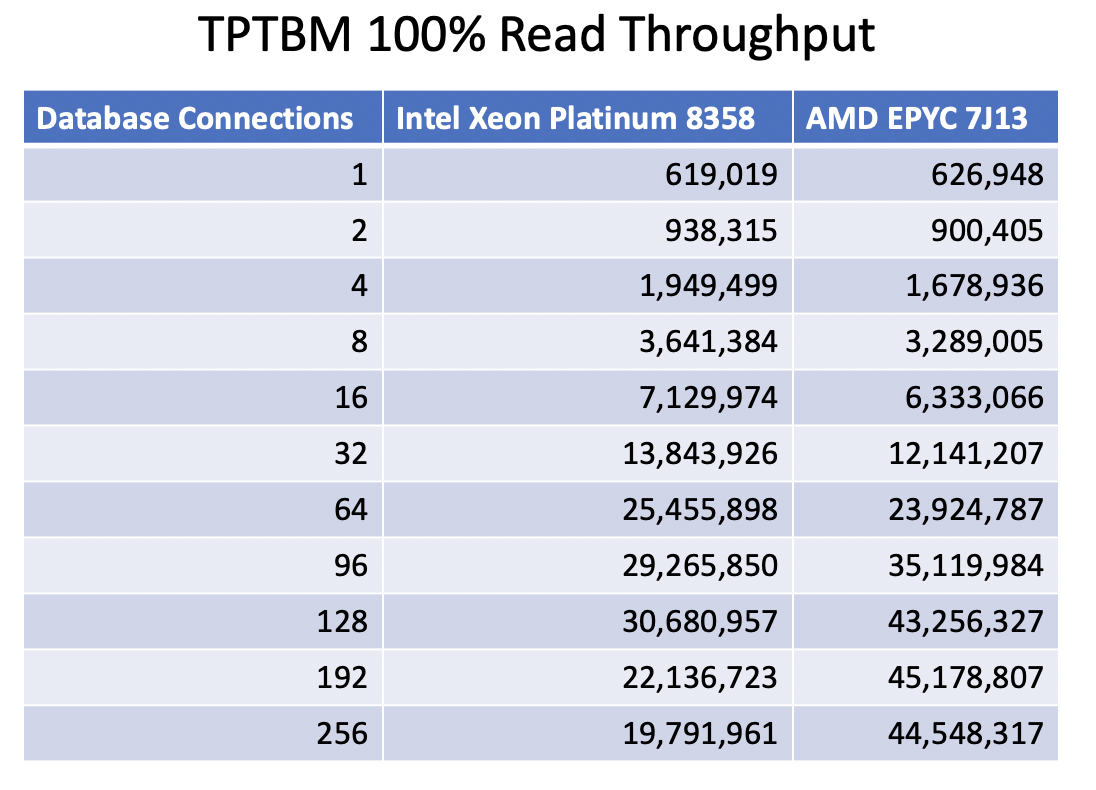

Throughput

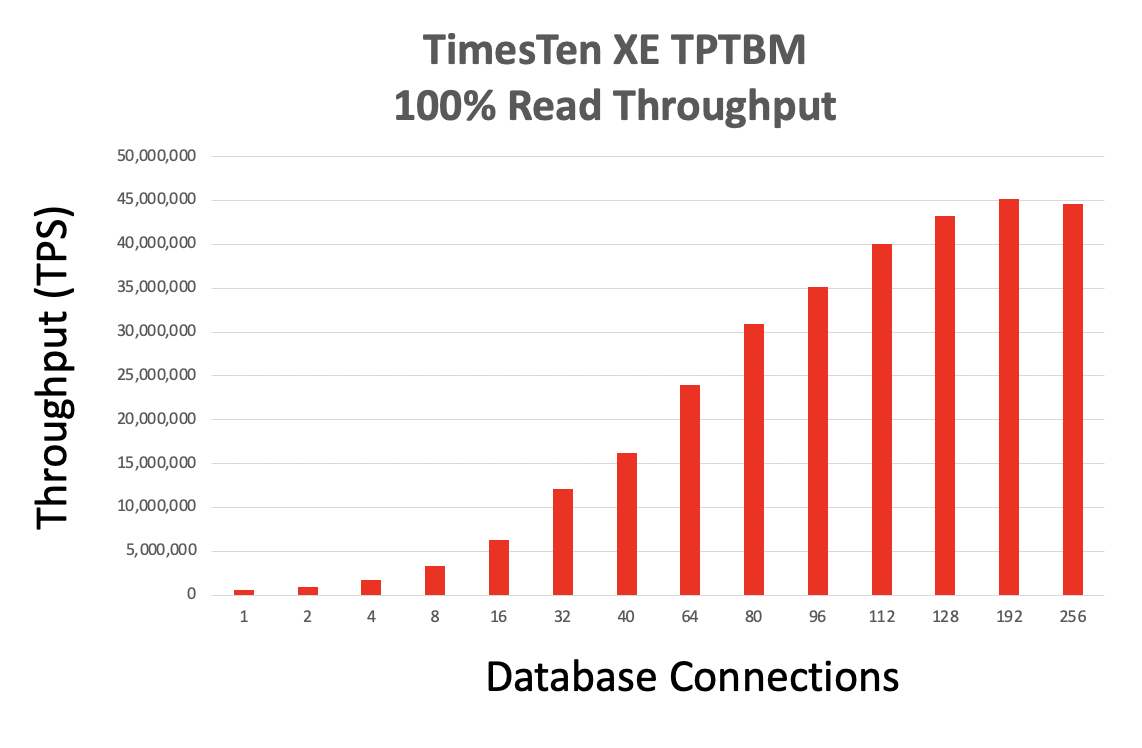

Read only throughput
- Using the Oracle Cloud bare metal BM.Standard.E4.128 compute node which had two AMD EPYC CPUs, a 100% read workload could scale to 256 database connections
- At 192 database connections, TimesTen XE was executing 45 million primary key lookup per second on a 1U Linux server
- Doubling the number of database connections almost doubled the throughput
- As TimesTen XE is an in-memory database, if TimesTen XE is well tuned then it will tend to be neither be network nor disk IO bound
- This means that TimesTen XE will tend to be CPU bound for direct link benchmarks
- Direct linked applications run on the same machine as the TimesTen database and do not use a TCP socket to communicate with the database
- If client server connections over a TCP socket were used, you would need thousands of database connections to make the TimesTen XE server CPU bound
- TimesTen XE will tend to scale to the number of CPU cores for read workloads

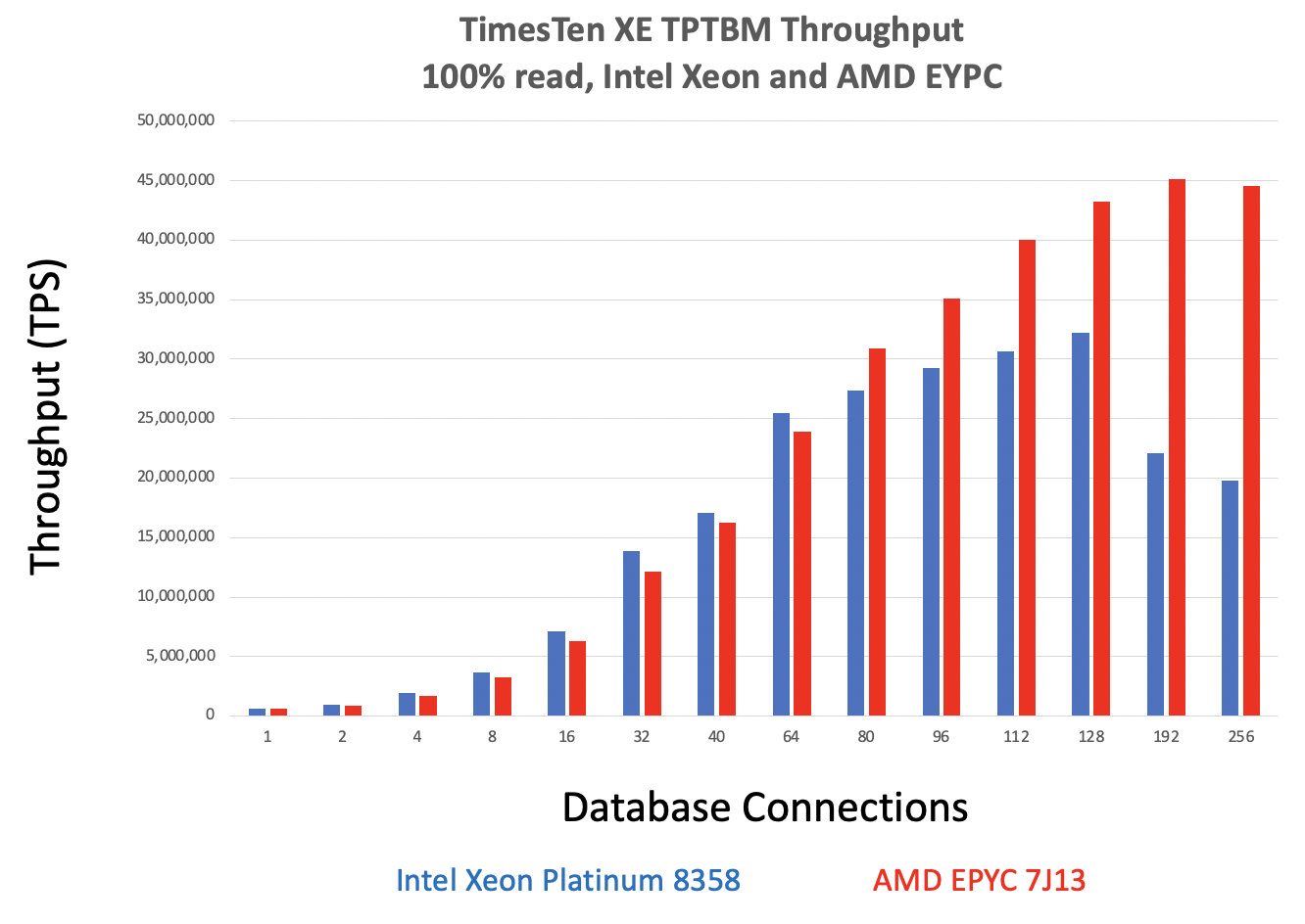

- The above table shows results for both Intel Xeon and AMD EPYC CPUs
- The number of CPU cores, the size of the L2 and L3 caches and CPU frequency will tend to determine the TimesTen XE performance
- This chart compares the throughput of TimesTen XE for both Intel Xeon and AMD EPYC CPUs
- The tables, data, workload and TimesTen XE versions are the same
- The variable is whether an Intel Xeon Platinum 8358 or an AMD EPYC 7J13 CPU was used
- For 1-64 database connections, the Intel Xeon CPU tends to give better read throughput than than the AMD EPYC CPU as it has a higher CPU frequency
- For more than 64 database connections, the AMD EPYC CPU has better read throughput than the Intel Xeon as it has more CPU cores
- Both the Intel Xeon and AMD EPYC CPUs show their server scalability curves for TimesTen XE
- The read throughput on the Intel Xeon CPU decreases when there are more database connections than CPU cores
- The AMD EPYC CPU was not CPU bound as it did not use more database connections than CPU cores

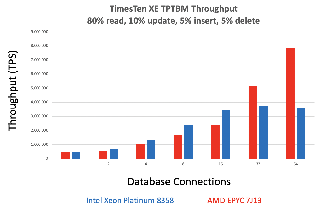

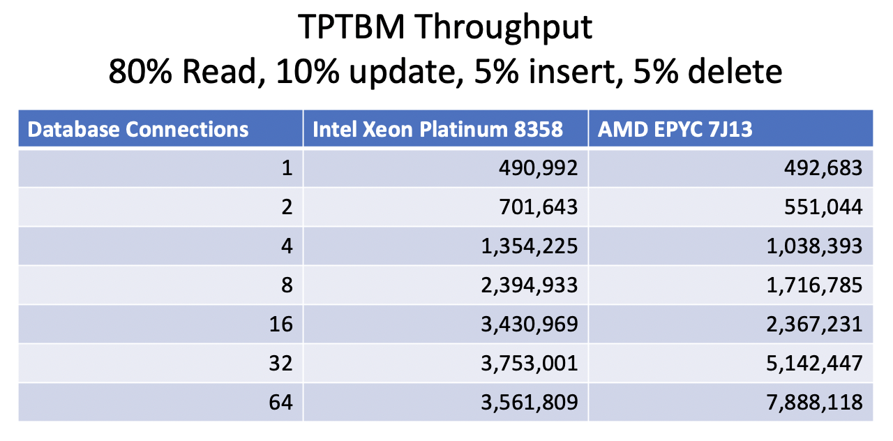

Read write throughput
- When a read/write workload is used:
- The AMD EPYC CPU scales to 7.8 million transaction per second using 64 database connections
- The Intel Xeon CPU scales to 3.7 million transactions per second using 32 database connections
- Eventually the read/write workload become IO bound for both the Intel and AMD CPUs
- The redo and database writes are all going over the network as the storage is NAS with iSCSI
- Using fast local NVMe storage would likely have given better write scalability
- This read/write chart shows that the Intel Xeon CPUs tends to give better throughput up to 16 database connections
- The AMD EPYC CPUs tend to give better read/write scalaiblity for 32 to 64 database connections
