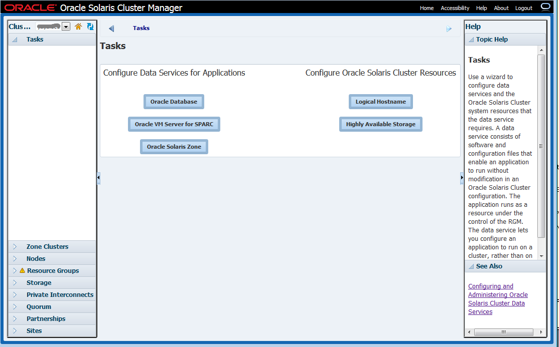

Launching
the wizard
Once
you are authenticated to the Oracle Solaris Cluster Manager browser
interface, you can launch the wizard by clicking on the
Oracle
VM Server for SPARC
button in the Tasks page.

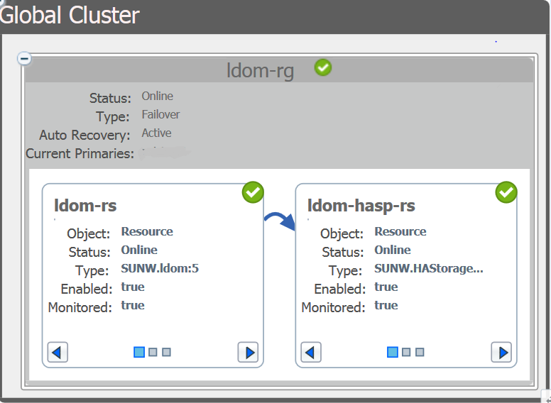

Resource group topology view
The
Resource Group topology view
below
(Topology
is
a tab on the Resource Groups page)
displays
a failover SPARC guest domain that is created by the wizard. This
shows a failover configuration using a single resource group.
The
arrow depicts an
offline-restart
dependency
between the resources.
