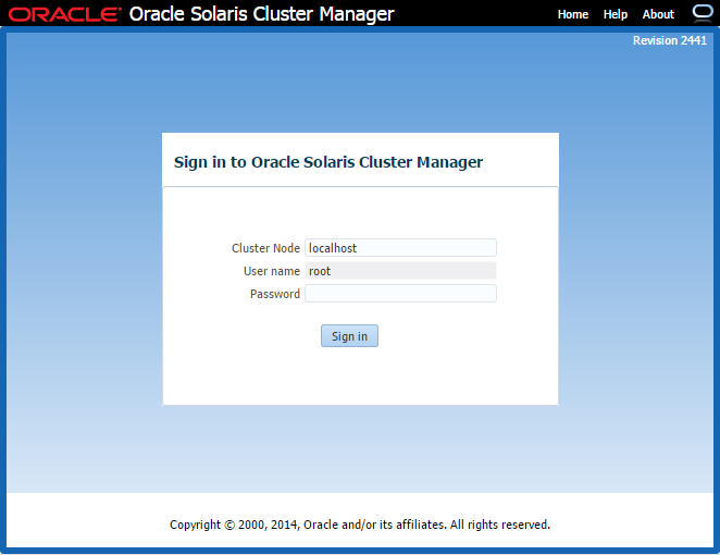

The
address will lead you to the login page (shown below). Login as the root role to
the control
node on this page and you can now start configuring a new
cluster.
