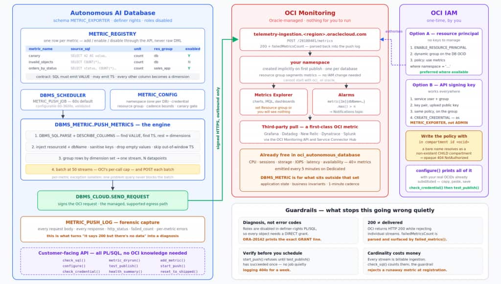

How it fits together
Figure 1: A scheduler job harvests the registry, builds a PostMetricData payload, and posts it signed to OCI Monitoring. Nothing runs outside the database.
The pieces worth calling out:
DBMS_CLOUD.SEND_REQUEST does the signing. OCI’s metrics API requires a signed request, and implementing Signature v1 in PL/SQL would have been most of the work. DBMS_CLOUD handles it — you hand it a credential and it signs. That single built-in is why this is roughly 200 lines of real logic instead of two thousand. It’s also the right choice on Autonomous AI Database generally: DBMS_CLOUD is the managed, supported way to make outbound calls, it authenticates against OCI services natively, and it needs no network ACL wrangling to reach them.
The database already knows who it is. V$PDBS.CLOUD_IDENTITY returns the region, compartment OCID, database OCID and database name as JSON. The exporter reads them at runtime, so nothing is hardcoded and the same script installs unchanged in any tenancy or region.
It’s push, not scrape. The database opens the connection itself — outbound to OCI Monitoring, which stays in your own region and compartment, under your own IAM. Your telemetry never goes to a third-party SaaS endpoint, there’s no vendor account holding your data, and the only credential involved is an OCI identity you already control. There’s also nothing to expose on the way in: no endpoint to secure, no listener, no inbound rule. And because the push starts inside the database rather than arriving through the components in front of it, it keeps reporting when the application tier, the REST layer, or the network path a scraper would have used is the thing that’s broken.
Resource groups give you a free segmentation axis. Each metric can carry a resource group — sales_app, db_health, batch — and you filter on it when reading, charting or alarming. It costs nothing and, unlike a second namespace, it needs no IAM change: the publish policy is scoped to the namespace, so you can reorganise how metrics are grouped without touching a policy. It’s the right place to separate application metrics from database ones.
resourceId and dbName are injected on every metric. resourceId is the database’s own OCID, which is what lets you put your custom metric on the same dashboard as the platform metrics for that database. dbName is what you’ll scope alarms by.
You choose the cadence, down to 60 seconds. Platform metrics on Dedicated are published at five-minute resolution, which suits capacity planning and trend analysis. Fast fault detection wants finer resolution: a metric you publish yourself at 60-second cadence supports a one-minute alarm — which, for fault detection, is most of the value.
