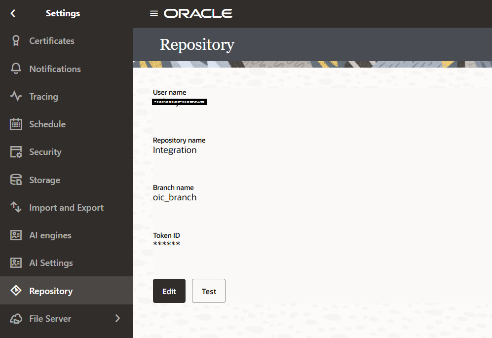

Starting with Oracle Integration release 25.06, you can directly connect Oracle Integration to a GitHub repository. This integration allows you to export (push) and import (pull) projects and their deployments between your Oracle Integration service instance and GitHub, enabling tighter integration with version control and CI/CD workflows.
To make it work, connect with your GitHub Repository under settings section of Oracle Integration.

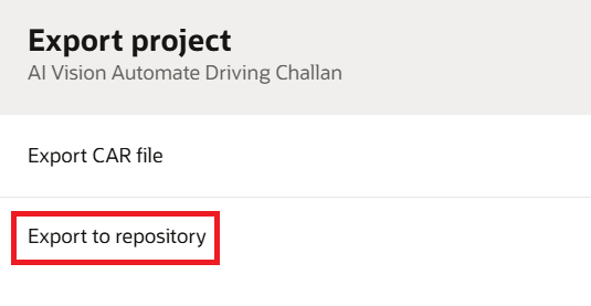

Export to a repository: Export the the project and deployment to the connected GitHub repository.

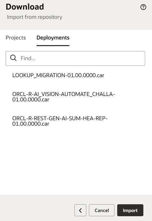

Import from repository: Import the projects / deployments from the connected repository.

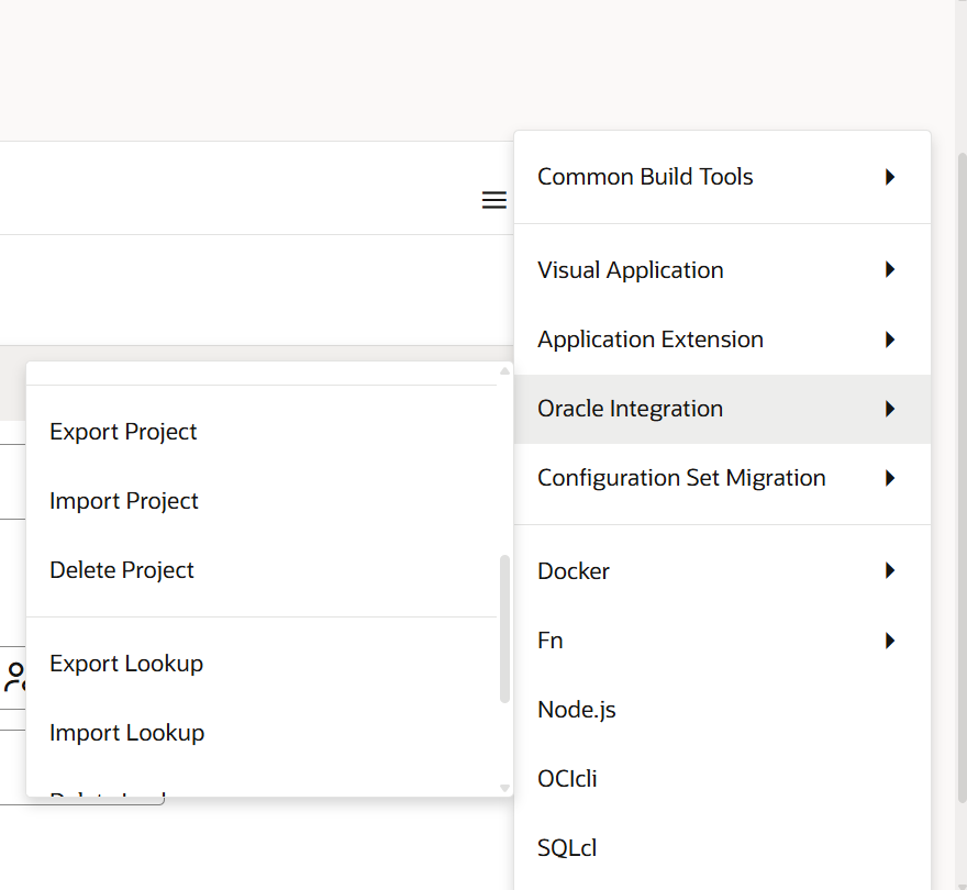

VB Studio natively support various actions to migrate artifacts from one environment to another.
You can create jobs and pipelines in VB Studio to automate the deployment of Integration Project .

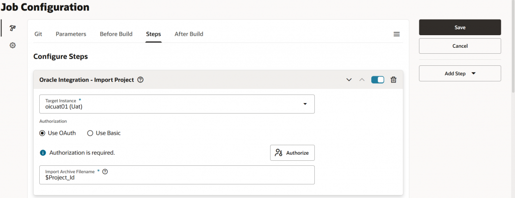

  1. Job to Export Project: VB Studio natively supports an action called Export Project, which enables the export of Integration Project and archive the exported Project into VB Studio internal directory.
  1. Job to Import Project: VB Studio natively supports an action called Import Project, which allows you to import Integration Project that was exported through the Export Project job.

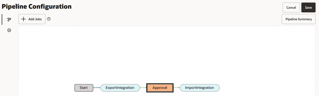

  1. Hookup Jobs into Pipeline: Build a pipeline in VB Studio to automate the execution of Export and Import Project jobs sequentially, eliminating the need for manual execution. Additionally, you can configure approvers to review and approve the process before the Import job begins.
Run the pipeline, and provide the Project Id as Project_Id is one of the parameters in the Export Project Job. Once the Pipeline is successfully executed, the project will be promoted from source environment to the target environment.

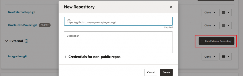

A VB Studio can be connected to the external GitHub repository as well.
Following are the high level steps for this approach:
  1. Link Oracle Integration and VB Studio to a single GitHub repository.
