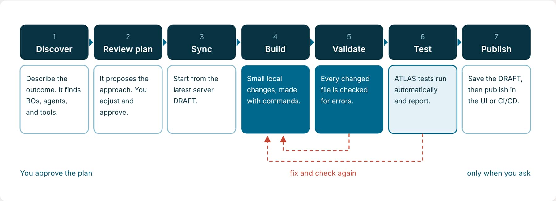

The development lifecycle in seven stages: discover, review plan, sync, build, validate, test, and publish. Validation and test failures go back to build.
Figure 1. The development lifecycle. When validation or a test fails, the assistant goes back to Build, fixes it, and checks again before reporting to you.
Stage What you do What the assistant does
Discover Describe the business outcome, not the implementation. Looks for the Business Objects, workflow agents, tools, and knowledge sources that can deliver it, and checks they return the data you need.
Review plan Check the scope, dependencies, design, and test approach. Adjust, then approve. Proposes what it will change and how. For apps, it waits at the pre-build checkpoint.
Sync Ask it to pull the latest DRAFT when teammates may have changed it. Fetches the server version and tells you if your local copy differs.
Build Keep each request to one change. Makes the change locally with CLI commands.
Validate Nothing; it’s automatic. Validates every changed artifact and fixes what fails.
Test Read Validation and Insights. Creates or updates the relevant tests, runs them, and reports the results. See Part 10.
Publish Ask it to save the DRAFT, then publish through your release process. Saves the DRAFT. It never publishes workflows from the CLI.
