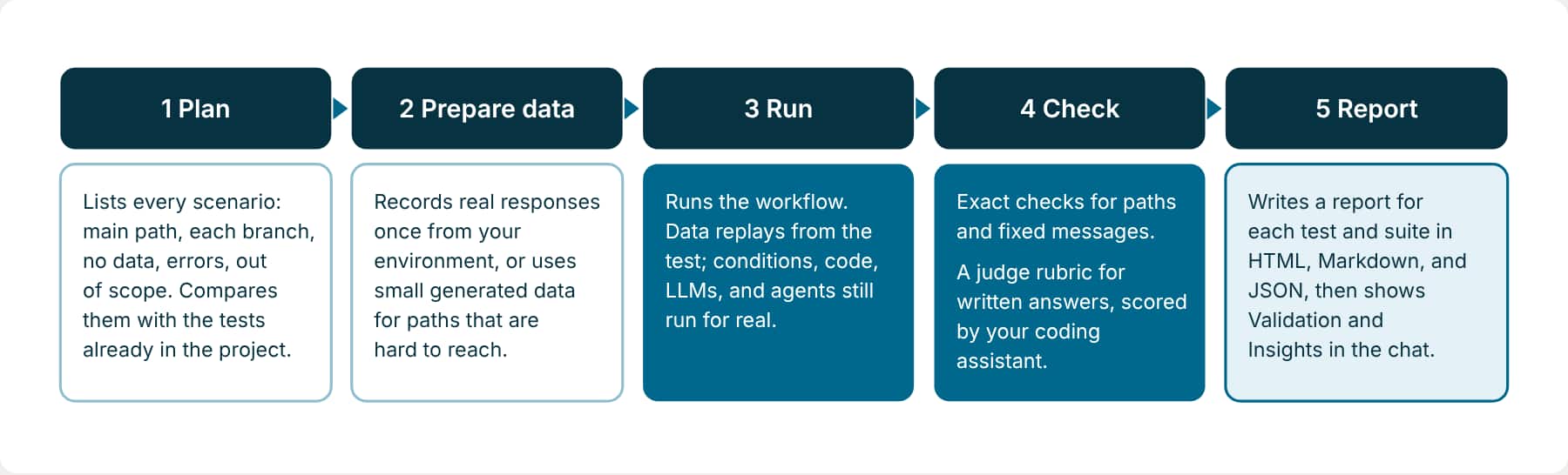

What happens in a test sync
A test sync in five steps: plan which scenarios need tests, prepare the data each test needs, run the workflow, check the results with exact checks and a judge, and write the reports and the Validation and Insights summary.
Figure 1. One test sync, start to finish. If a test fails, the assistant looks at why, fixes the test or tells you the workflow is wrong, and runs it again.
The sync plan marks each scenario with what needs to happen. Covered means a current test already proves it. Create means no test exists yet. Update means the workflow changed in a way that affects the test. Review means a test no longer matches any path, often because a branch was removed, and it waits for your decision. Keep means a test you asked for yourself, which ATLAS never rewrites or deletes.

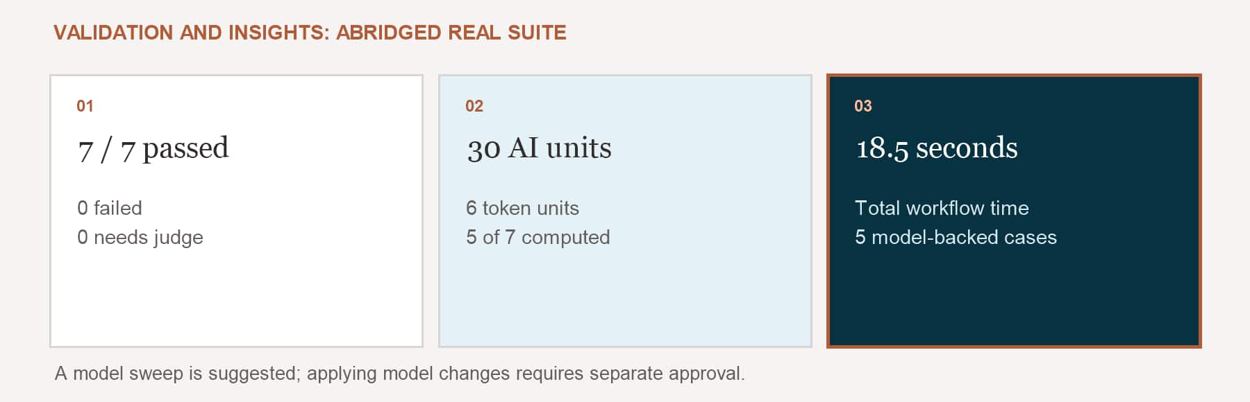

Reading Validation and Insights
Every test run ends with this summary in the chat, and the same content is in the suite report. Here’s an abridged one from a real workflow suite, with the workflow name generalized.
Example · Validation and Insights (abridged)
Workflow test suite passed: 7/7 passed, 0 failed, 0 needs judge.
Reports:
- Workflow suite report: suite-result.html
Metrics:
- AI units: 30 total (6 token units, 5/7 cases computed).
- Latency: total workflow time 18.5s across 5/5 model-backed cases.
Optimization:
- Model optimization is available for this workflow. 5 passing tests exercise model-backed nodes.
- Suggested prompt: Run the model optimization sweep for this workflow and summarize
  the best model placement per LLM node.
- The sweep reports recommendations only. Applying model changes requires a separate approval.
Abridged real ATLAS suite result: seven of seven tests passed, zero failed, zero need a judge; 30 AI units including 6 token units, computed for five of seven cases; 18.5 seconds across five model-backed cases. A model sweep is suggested; applying changes requires separate approval.
Figure 2. Abridged result from a real workflow suite. The optimization sweep is a recommendation, not an applied change.
Test summary
How many tests passed, failed, or still need a judge result, with a link to each report. Open the report for anything that isn’t a pass.
Action Required
Appears only when something needs you, such as a failing test or a scenario that couldn’t be tested. Each item says what to do.
Metrics
AI units, tokens, and time for the run, so you can see what the workflow costs and how fast it is.
Optimization
Suggested next steps, often a model sweep that compares lighter and stronger models on the same tests. It only recommends; nothing changes without your approval.
