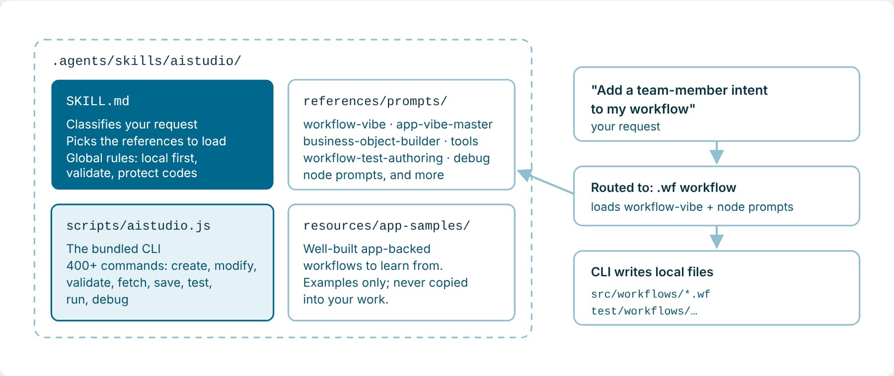

The aistudio skill folder contains SKILL.md with routing rules, references/prompts with one guide per artifact type, scripts/aistudio.js which is the bundled CLI, and resources/app-samples. A request is classified by SKILL.md, the matching reference is loaded, and the CLI writes workflow and test files into src and test folders in this example.
Figure 1. What’s in the skill folder, and how one request moves through it.

The first thing the skill does is classify what you’re asking for. Natural-language phrases decide the artifact; file extensions, paths, and command names override them. If your wording could mean more than one thing, it asks one question, typically: Tool artifact, source artifact, or workflow node?
