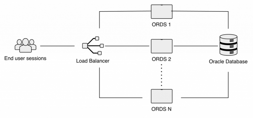

    • ORDS layer. To eliminate potential bottleneck at this layer, we should use multiple ORDS instances connected to the same Oracle Database, with a load balancer working in front of them – to make the configuration transparent to an application.
As a result, we should consider the following architecture:
Picture 2: Highly scalable architecture of MongoDB API
As wired protocol used by a MongoDB applications to interact with the database is stateless, i.e. every request contains complete information about the session, then a single session does not need to be physically bound to a single one network endpoint. Therefore – technically – any type of Load Balancer can be used. For example, technically in case of Oracle OCI both types of OCI load balancers can be used, including NLBs. However – in case of an on-premises deployments we cannot use OCI load balancers. For such deployment models there is need to use a third-party solution, like, for example, very popular HA Proxy.
