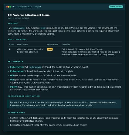

Consider an anonymized customer case: a CSI-backed volume was not attaching to the worker node. The team had inspected the volume repeatedly, but the root cause was still unclear. The breakthrough came from mapping the Kubernetes resources to the backing OCI objects. Once the PVC, Volume Attachment, worker node, VNIC, subnet, and NSG were viewed together, the investigation found that an NSG rule in the environment was blocking the required attachment path. The symptom surfaced at the volume, but the cause was a network rule sitting one layer removed from it.

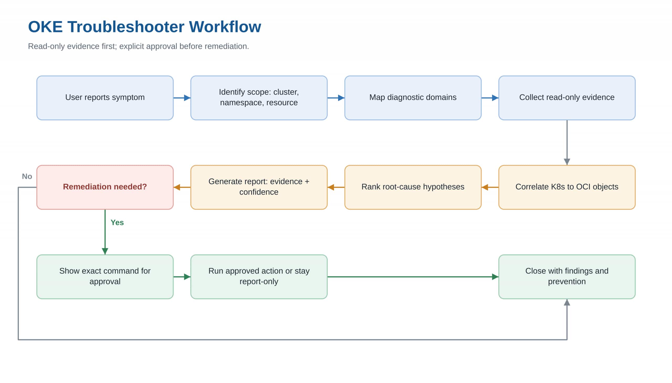

The OKE Troubleshooter follows a phased workflow instead of running a broad set of commands and hoping something stands out.
OKE Troubleshooter Workflow
Figure 1. OKE Troubleshooter workflow: evidence first, approval before remediation.
A typical prompt can be as specific as:
Use the OKE troubleshooter for service web in namespace prod
has no load balancer IP
From there, the skill can inspect the Service, events, endpoints, annotations, OCI load balancer state, subnet and NSG context, route tables, and logs when available.

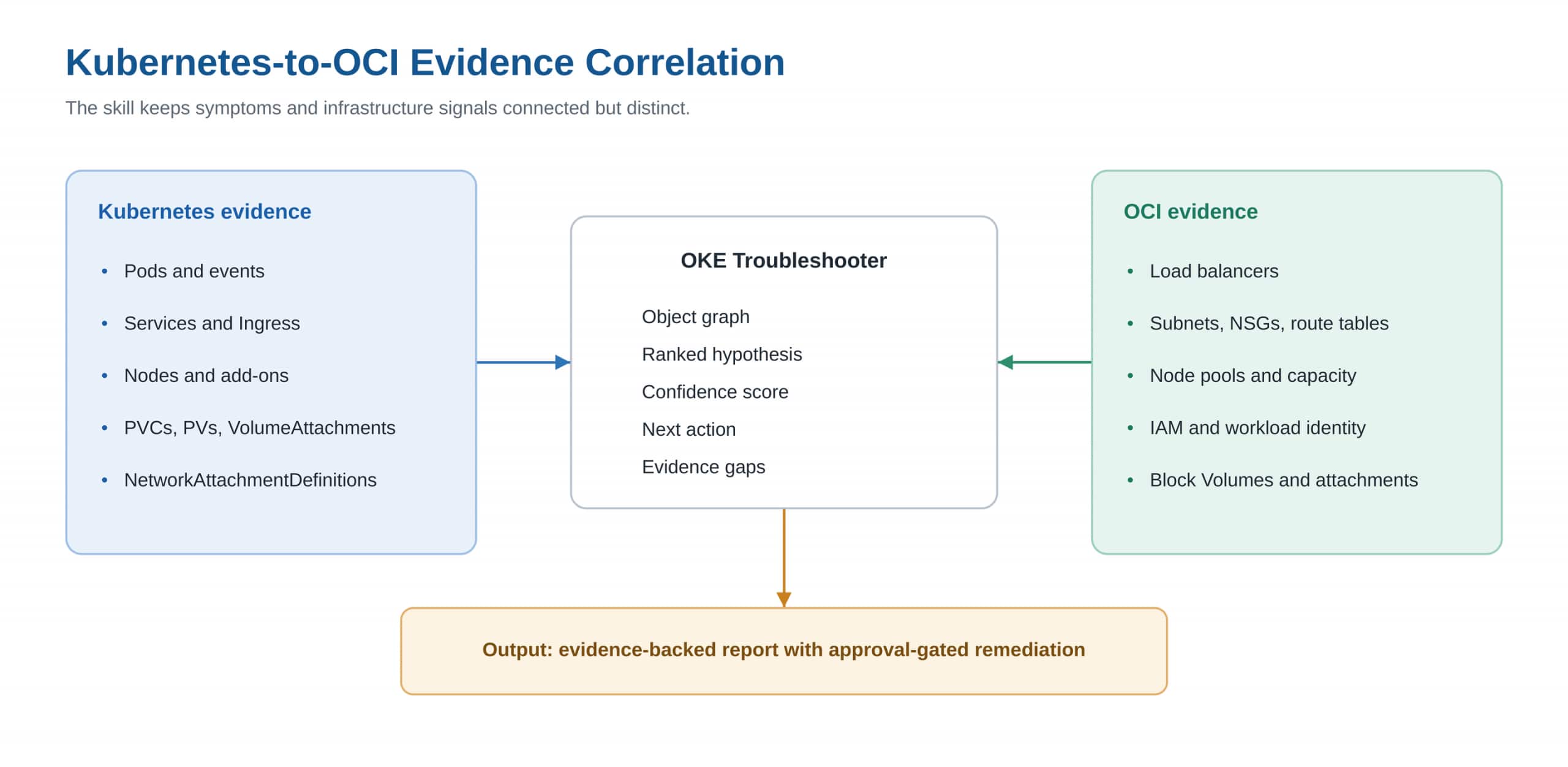

Correlating Kubernetes and OCI
The strongest troubleshooting output comes from connecting Kubernetes symptoms to the OCI resources behind them.
OKE Troubleshoot Workflow
Figure 2. Kubernetes and OCI signals converge into ranked hypotheses, actions, and evidence gaps.
Take a Pending pod. The cause might be taints, resource requests, an autoscaler limit, OCI capacity, or simply a subnet that has run out of IPs. A failing CSI mount pulls in a different cast: the PVC and PV, the VolumeAttachment, the backing OCI Block Volume, where the pod landed, and the IAM and networking in between. Multus is different again, usually a missing NetworkAttachmentDefinition, absent network-status, OCI CNI or IPAM state, or CNI binaries that never made it onto the node.

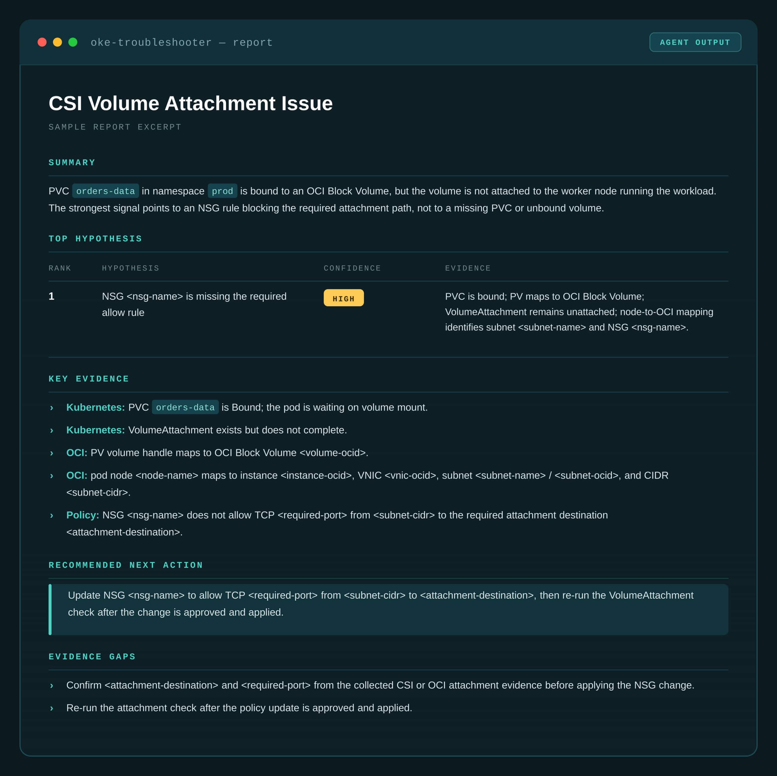

The report is built so you can act on it without re-deriving everything yourself. The most likely root cause sits at the top, with competing hypotheses below it and a confidence level on each. Supporting evidence stays grouped by where it came from, Kubernetes or OCI. Where the picture is incomplete, the report says so. The excerpt below is the report from the CSI volume case in the introduction.
Sample OKE Troubleshooter report for the CSI volume case, as the agent returns it, kept visually distinct from the surrounding blog narrative.
Figure 3. Sample OKE Troubleshooter report for the CSI volume case
Summary
PVC orders-data in namespace prod is bound to an OCI Block Volume, but the volume is not attached to the worker node running the workload. The strongest signal points to an NSG rule blocking the required attachment path, not to a missing PVC or unbound volume.
Top Hypothesis
RankHypothesisConfidenceEvidence
1NSG <nsg-name> is missing the required allow ruleHighPVC is bound; PV maps to OCI Block Volume; VolumeAttachment remains unattached; node-to-OCI mapping identifies subnet <subnet-name> and NSG <nsg-name>.
Key Evidence
  • Kubernetes: PVC orders-data is Bound; the pod is waiting on volume mount.
  • Kubernetes: VolumeAttachment exists but does not complete.
  • OCI: PV volume handle maps to OCI Block Volume <volume-ocid>.
  • OCI: pod node <node-name> maps to instance <instance-ocid>, VNIC <vnic-ocid>, subnet <subnet-name> / <subnet-ocid>, and CIDR <subnet-cidr>.
  • Policy: NSG <nsg-name> does not allow TCP <required-port> from <subnet-cidr> to the required attachment destination <attachment-destination>.
Recommended Next Action
Update NSG <nsg-name> to allow TCP <required-port> from <subnet-cidr> to <attachment-destination>, then re-run the VolumeAttachment check after the change is approved and applied.
Evidence Gaps
  • Confirm <attachment-destination> and <required-port> from the collected CSI or OCI attachment evidence before applying the NSG change.
  • Re-run the attachment check after the policy update is approved and applied.
