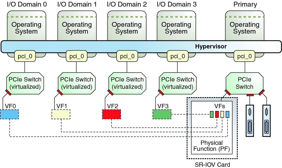

Root Domain SetupIn the case of physical IO, there are several options:  Root Domains, DirectIO and SR-IOV.  Let’s start with SR-IOV.  The most recent addition to the LDom IO options, it is by far the most flexible and the most sophisticated PCI virtualization option available.  Please see the diagram on the right (from the Admin Guide) for an overview.  First introduced for Ethernet adapters, Oracle today supports SR-IOV for Ethernet, Infiniband and Fibre Channel.  Note that the exact features depend on the hardware capabilities and built-in support of the individual adapter.  SR-IOV is not a feature of a server but rather a feature of an individual IO card in a server platform that supports it.  Here are the advantages of this solution:
  • It is very fine grain, with between 7 and 63 Virtual Functions per adapter.  The exact number depends on adapter capabilities.  This means that you can create and use as many as 63 virtual devices in a single PCIe slot!
  • It provides bare metal performance (especially latency), although hardware resources like send and receive buffers, MAC slots and other resources are devided between VFs which might lead to slight performance differences in some cases.
  • Particularily for Fibre Channel, there are no limitations to what end-point device (disk, tape, library, etc.) you attach to the fabric.  Since this is a virtual HBA, it is administered like one.
  • Different than Root Domains and Direct IO, most SR-IOV configuration operations can be performed dynamically, if the adapters support it.  This is currently the case for Ethernet and Fibre Channel.  This means you can add or remove SR-IOV VFs to and from domains in a dynamic reconfiguration operation, without rebooting the domain.
Of course, there are also some drawbacks:
  • First of all, you have a hard dependency on the domain owning the root complex.  Here’s a little more detail: As you can see in the diagram, the IO domain owns the physical IO card.  The physical Root Complex (pci_0 in the diagram) remains under the control of the root domain (the control domain in this example).  This means that if the root domain should reboot for whatever reason, it will reset the root complex as part of that reboot.  This reset will cascade down the PCI structures controlled by that root complex and eventually reset the PCI card in the slot and all the VFs given away to the IO domains.  Essentially, seen from the IO domain, its (virtual) IO card will perform an unexpected reset.  The best way to respond to this is with a panic of the IO domain, which is the most likely consequence.  Note that the Admin Guide says that the behaviour of the IO domain is unpredictable, which means that a panic is the best, but not the only possible outcome.  Please also take note of the recommended  precautions (by configuring domain dependencies) documented in the same section of the Admin Guide.  Furthermore, you should be aware that this also means that any kind of multi-pathing on top of VFs is counter-productive.  While it is possible to create a configuration where one guest uses VFs from two different root domains (and thus from two different physical adapters), this does not increase the availability of the configuration.  While this might protect against external failures like link failures to a single adapter, it doubles the likelyhood of a failure of the guest, because it now depends on two root domains instead of one.  I strongly recommend against any such configurations at this time.  (There is work going on to mitigate this dependency.)
  • Live Migration is not possible for domains that use VFs.  In the case of Ethernet, this can be worked around by creating an IPMP failover group consiting of one virtual network port and one Ethernet VF and manually removing the VF before initiating the migration as described by Raghuram here.  Note that this is not currently possible for Fibre Channel or IB.
  • Since you are actually sharing one adapter between many guests, these guests do share the IO bandwidth of this one adapter.  Depending on the adapter, there might be bandwidth management available, however, the side effects of sharing should be considered.
  • Not all PCIe adapters support SR-IOV.  Please consult MOS DocID 1325454.1 for details.
SR-IOV is a very flexible solution, especially if you need a larger number of virtual devices and yet don’t want to buy into the slightly higher IO latencies of virtual IO.  Due to the limitations mentioned above, I can not currently recommend SR-IOV or Direct IO for use in domains with highest availability requirements.  In all other situations, and definately in test and development environments, it is an interesting alternative to virtual IO.  The performance gap between SR-IOV and virtual IO has been narrowed considerably with the latest improvements in virtual IO.  You will essentially have to weigh the availability, latency and managability characteristics of SR-IOV against virtual IO to make your decision.

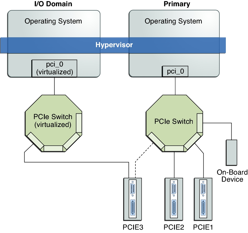

Root Domain SetupNext in line is Direct IO.  As described in an earlier post, you give one full PCI slot to the receiving domain.  The hypervisor will create a virtual PCIe infrastructure in the receiving guest and reconfigure the PCIe subsystem accordingly.  This is shown in an abstract view in the diagram (from the Admin Guide) at the right. Here are the advantages:
  • Since Direct IO works on a per slot basis, it is a more fine grain solution, compared to root domains.  For example, you have 16 slots in a T5-4, but only 8 root complexes.
  • The IO domain has full control over the adapter.
  • Like SR-IOV, it will provide bare-metal performance.
  • There is no sharing, and thus no cross-influencing from other domains.
  • It will support all kinds of IO devices, tape drives and tape libraries being the most popular example.
The disadvantages of Direct IO are:
  • There is a hard dependency on the domain owning the root complex.  The reason is the same as with SR-IOV, so there’s no need to repeat this here.  Please make sure you understand this and read the recommendations in the Admin Guide on how to deal with this dependency.
  • Not all IO cards are supported with DirectIO.  They must not contain their own PCIe switch.  A list of supported cards is maintained in MOS DocID 1325454.1.
  • Like Root Domains, dynamic reconfiguration is not currently supported with DirectIO slots.  This means that you will need to reboot both the root domain and the receiving guest domain to change this configuration.
  • And of course, Live Migration is not possible with Direct IO devices.
DirectIO was introduced in an early release of the LDoms software.  At the time, systems like the T2000 only supported two Root Complexes.  The most common usecase was to support tape devices in domains other than the control domain.  Today, with a much better ratio of slots/root complex, the need for this feature is diminishing and although it is fully supported, you should consider other alternatives first.

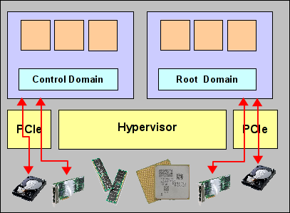

Root Domain Setup Finally there are Root Domains.  Again, a diagram you already know, just as a reminder.
The advantages of Root Domains are:
  • Highest Isolation of all domain types.  Since they own and control their own CPU, memory and one or more PCIe root complex, they are fully isolated from all other domains in the system.  This is very similar to Dynamic System Domains you might know from older SPARC systems, just that we now use a hypervisor instead of a crossbar.
  • This also means no sharing of any IO resources with other domains, and thus no cross-influence of any kind.
  • Bare metal performance.  Since there’s no virtualization of any kind involved, there are no performance penalties anywhere.
  • Root Domains are fully independent of all other domains in all aspects.  The only exception is console access, which is usually provided by the control domain.  However, this is not a single point of failure, as the root domain will continue to operate and will be fully available over the network even if the control domain is unavailable.
  • They allow hot-swapping of IO cards under their control, if the chassis supports it.  Today, that is for T5-4 and above.
Of course, there are disadvantages, too:
  • Root Domains are not very flexible.  You can not add or remove PCIe root complexes without rebooting the domain.
  • You are limited in the number of Root Domains, mostly by the number of PCIe root complexes available in the system.
  • As with all physical IO, Live Migration is not possible.
Use Root Domains whenever you have an application that needs at least one socket worth of CPU and memory or more and has high IO requirements, but where you’d prefer to host it on a larger system to allow some flexibility in CPU and memory assignment.  Typically, Root Domains have a memory footprint and CPU activity which is too high to allow sensible live migration. They are typically used for high value applications that are secured with some kind of cluster framework.

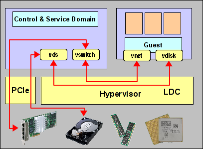

Virtual IO SetupHaving covered all the options for PCI virtualization, there is only virtual IO left to cover. For easier reference, here’s the diagram from previous posts that shows this basic setup.  This variant is probably the most widely used one.  It has been available from the very first version, it’s performance has been significantly improved recently.  The advantages of this type of IO are mostly obvious:
  • Virtual IO allows live migration of guests.  In fact, only if all the IO of a guest is fully virtualized, can it be live migrated.
  • This type of IO is by far the most flexible from a platform point of view.  The number of virtual networks and the overall network architecture is only limited by the number of available LDCs (which has recently been increased to 1984 per domain).  There is a big choice of disk backends.  Providing disk and networking to a great number of guests can be achieved with a minimum of hardware.
  • Virtual IO fully supports dynamic reconfiguration – the adding and removing of virtual devices.
  • Virtual IO can be configured with redundant IO service domains, allowing a rolling upgrade of the IO service domains without disrupting the guest domains and without requiring live migration of the guests for this purpose.  Especially when running a large number of guests on one platform, this is a huge advantage.
  • As with all virtual IO, there is a small overhead involved.  In the LDoms implementation, there is no limitation of physical bandwidth.  But there is a small amount of additional latency added to each data packet as it is processed through the stack.  Note that this additional latency, while measurable, is very small and not typically an issue for applications.
  • LDoms virtual IO currently supports virtual Ethernet and virtual disk.  While virtual Ethernet provides the same functionality as a physical Ethernet switch, the virtual disk interface works on a LUN by LUN basis.  This is different to other solutions that provide a virtual HBA and comes with some overhead in administration, since you have to add each virtual disk individually instead of just a single (virtual) HBA.  It also means that other SCSI devices like tapes or tape libraries can not be connected with virtual IO.
  • As is natural for virtual IO, the physical devices (and thus their resources) are shared between all consumers.  While recent releases of LDoms do support bandwidth limitations for network traffic, no such limits can currently be set on virtual disk devices.
  • You need to configure sufficient CPU and memory resources in the IO service domains.  The usual recommendation is one to two cores and 8-16 GB of memory.  While this doesn’t strictly count as overhead for the CPU resources of the guests, those is still resources that are not directly available to guests.
Some recommendations for virtual IO:
  • In general, use the latest version of LDoms, along with Solaris 11.
  • Other than general networking considerations, there are no specific tunables for networking, if you are using a recent version of LDoms.  Stick to the defaults.
  • The same is true for disk IO.  However, keep in mind what has been true for the last 20 years: More LUNs do more IOPS.  Just because you’ve virtualized your guest doesn’t mean that a single, 10TB LUN would give you more IOPS than 10x1TB LUNs – quite the opposite!  In the special case of the Oracle database: Make sure the redo logs are on dedicated storage.  This has been a recommendation since the “bad old days”, and it continues to be true, whether you virtualize or not.
Virtual IO is best used in consolidation scenarios, where you have many smaller systems to host on one chassis.  These smaller systems tend to be lightweight in most of their resource consumption, including IO.  Hence, they will definately work well on virtual IO.  These are also the workloads that lend themselves best to Live Migration because of their smaller memory footprint and lower overall activity.  This is not to say that domains with moderate IO requirements wouldn’t be well suited for virtual IO, they are.  However, larger domains with higher overall resource consumption (CPU, Memory, IO), tend to benefit less from the advantages of Live Migration and the flexibility of virtual IO.
