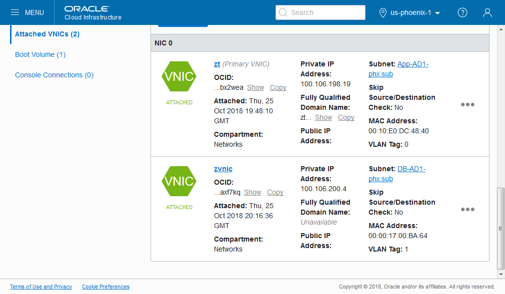

Next, you’ll need to use the OCI console or CLI add a second VNIC to the instance that we’ll use for the zone’s network access.  When you’re done, the instance’s Attached VNICs section in the OCI console should look something like this:

Now it’s time to configure the zone.  The key requirement is to configure the anet resource to use the VLAN tag, IP and MAC addresses assigned to the VNIC by OCI, otherwise there won’t be any network traffic allowed to or from the zone.  Note that you need the prefix length from the VCN configuration. We also set the default router in the zone configuration to ensure it can reach resources outside its local link (by convention the router is the first address on the network).

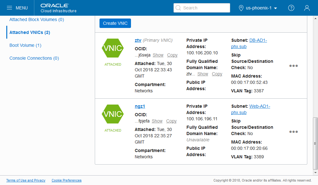

When using a VM as the global zone, the process is slightly different as the hypervisor exposes the VNIC to the guest automatically.  This makes the zone configuration somewhat simpler as we don’t have to worry about VLAN tags (the hypervisor handles that) and can just delegate that physical link as a net resource and configure the allowed address and router.  First, here’s the OCI VNIC configuration for our VM:
