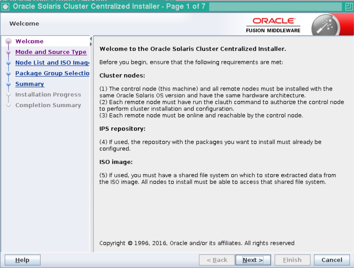

  1. Refer https://docs.oracle.com/cd/E69294_01/html/E69313/gsrid.html#scrolltoc for pre-requisites before you begin the installation.

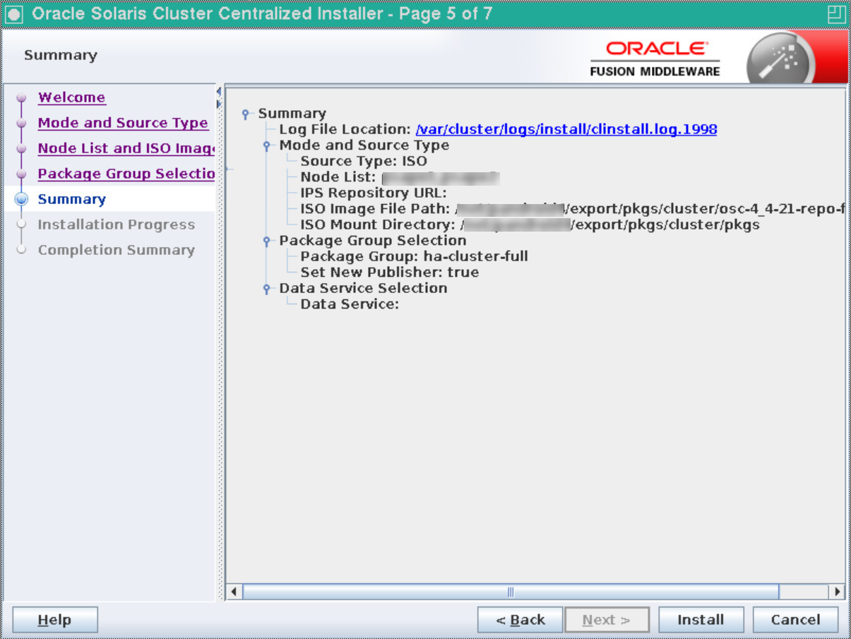

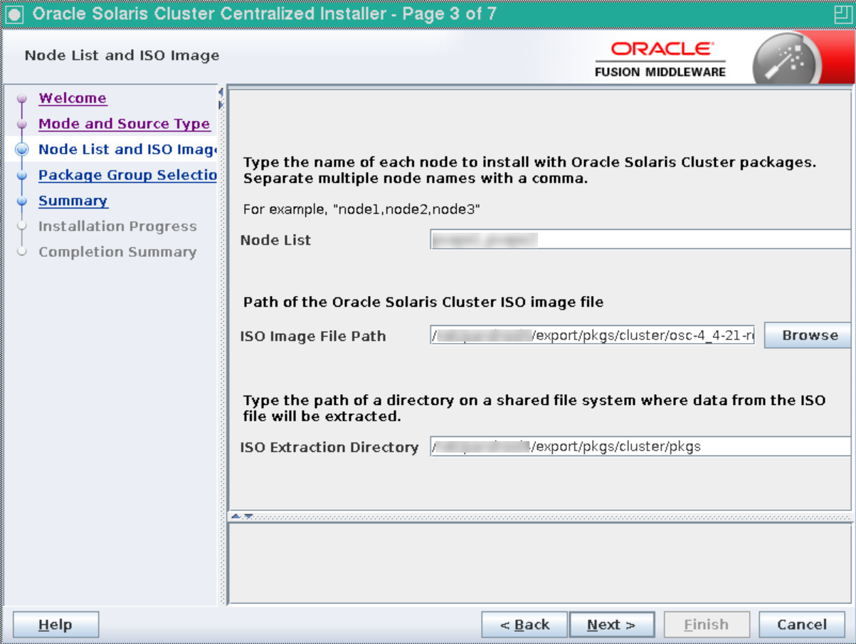

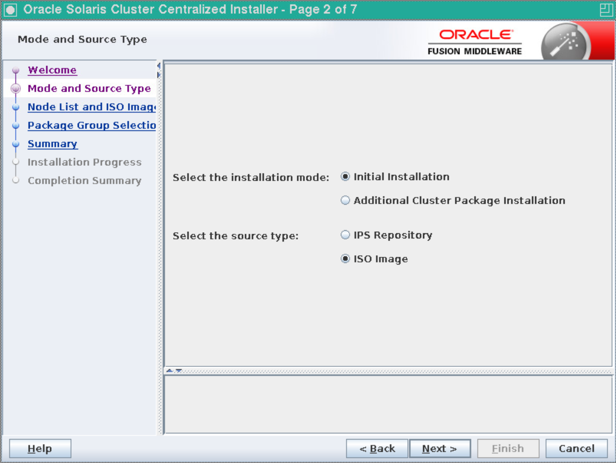

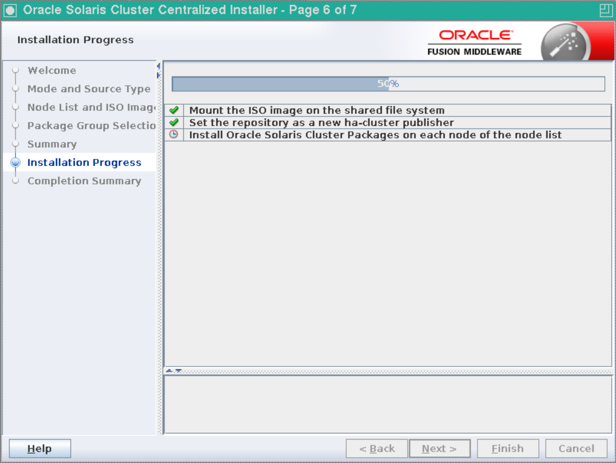

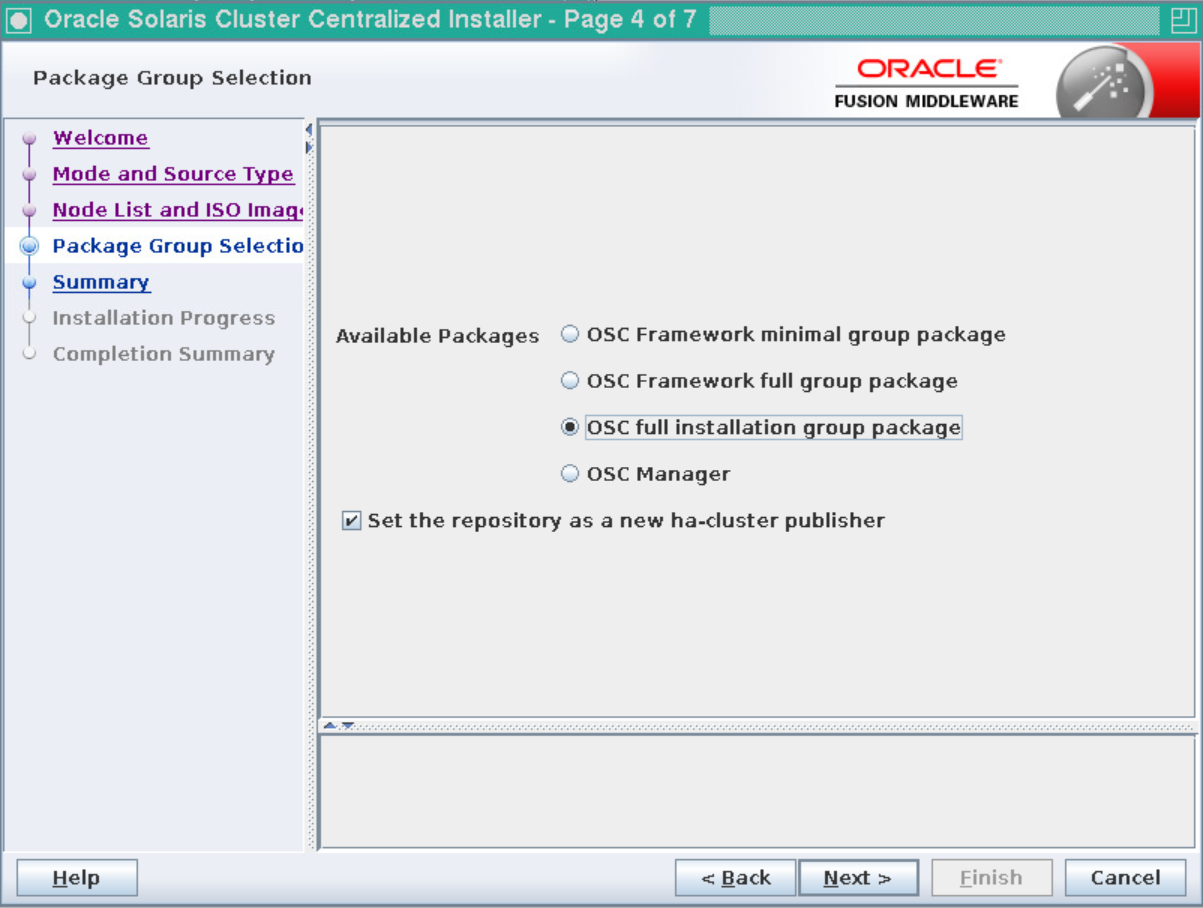

Example 3: Cluster initial installation from ISO image using the graphical user interface (GUI), clinstall with -g option
phys-control# clinstall –g
Upon completion, cluster packages in ha-cluster-full package are installed on phys-control and phys-schost. Administrator can now proceed to do initial cluster configuration.
