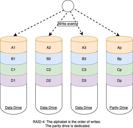

To understand RAID-5, you first need to understand RAID-4.  With RAID-4, we take the data written to disk 1, 2, and 3 and calculate the parity.  We use a dedicated drive to store parity in RAID-4.  Therefore, we have some drawbacks:
  • Every write requires a write to the parity drive.
  • Paritiy drive performance caps overall performance.
  • We need to read all date from other drives to recovery parity.
RAID-4 evenly writes to each disk.  We have single parity drive.
When you are reading data, you need to read all the data drives to access the data because pieces of data are spread across the drives.

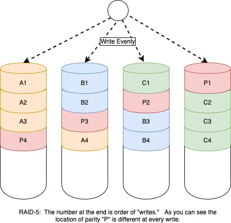

What is RAID-5?
RAID-5 fixed the shortcomings of RAID-4 by changing the parity drive at every write. For understanding the data recovery in RAID, you can consider RAID-5 as RAID-4 for now.
In RAID-5 we shift the writes, so the parity does not depend on a single drive.
