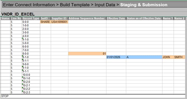

Below is an example of the Staging & Submission tab showing a new effective-dated row with withholding names populated:
In this example:
- A new effective date is added
- Status is set to Active (A)
- Withholding Name 1 and 2 are populated (e.g., JOHN / SMITH)
