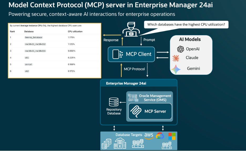

Enterprise Manager as an MCP Server
The Enterprise Manager MCP Server runs within the Oracle Management Service (OMS) alongside Enterprise Manager’s existing management services. Because the MCP Server is built into Enterprise Manager, customers do not need to deploy or maintain separate MCP server infrastructure. It complements, rather than replaces, Enterprise Manager REST APIs by providing an AI-friendly, self-describing interface for MCP-compatible clients.
A key benefit of the EM MCP Server is that it allows AI applications to ground their responses in current Enterprise Manager operational data. Instead of relying only on the model’s general knowledge, an MCP-compatible client can discover an Enterprise Manager tool, retrieve information such as targets, metrics, or jobs, and use that information as context when formulating its response.
For example, when a user asks a question about their environment, an MCP-compatible client can discover the appropriate Enterprise Manager tool, retrieve current information from EM, and use the returned data to generate a response grounded in the customer’s environment.
Figure 1: Model Context Protocol server in Enterprise Manager 24ai

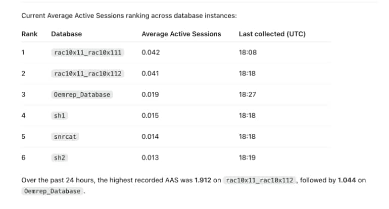

For example, a user could ask:
Show databases with the highest Average Active Sessions
Codex can discover the appropriate Enterprise Manager tool, retrieve the current target information, and use that data to formulate its response.
