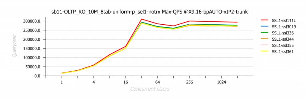

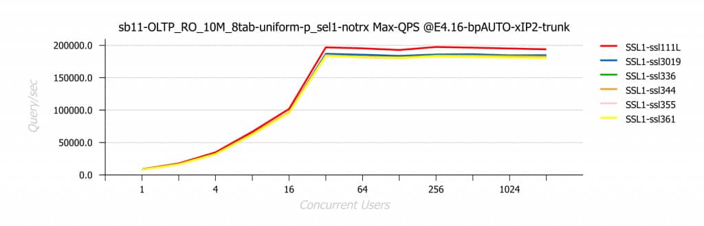

  • Sysbench Point-SELECTs: fastest OLTP Read-Only workload based on Primary Keys (PK) lookups.

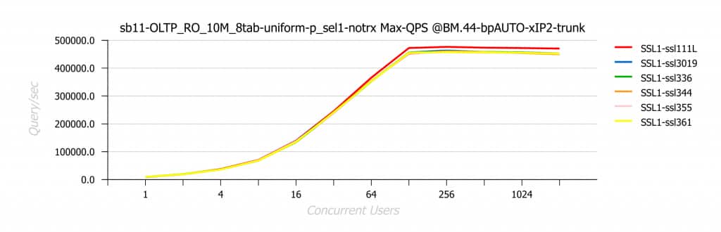

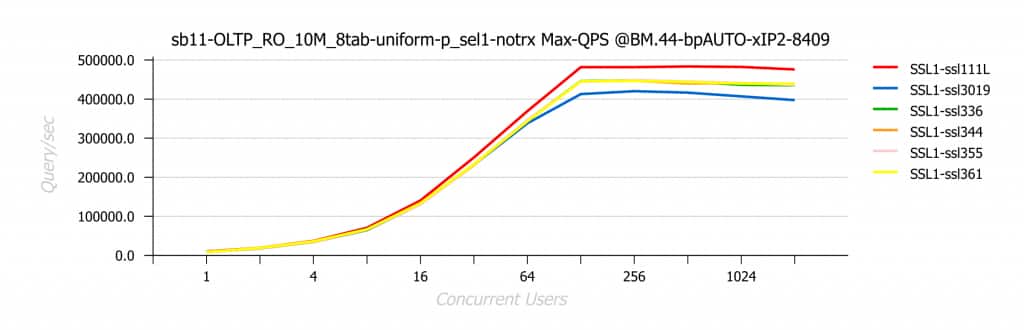

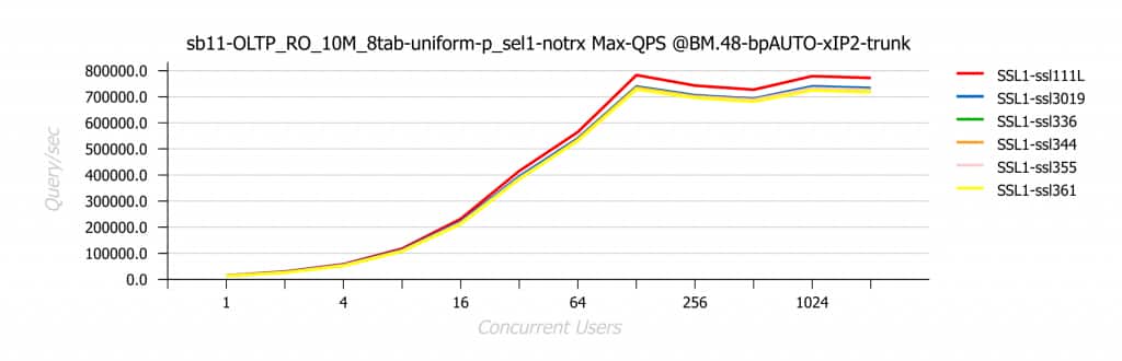

Point-SELECTs Workload | Local-IP
The following are the test results obtained on Point-SELECTs workload executed locally on each server and using local IP-port (loopback 127.0.0.1):
MySQL 9.7 (trunk)
BM.44
BM.48
OCI VM X9.16
OCI VM E4.16

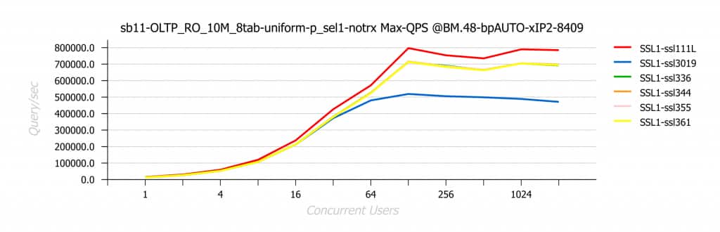

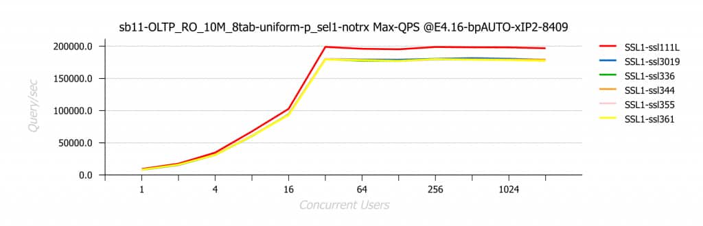

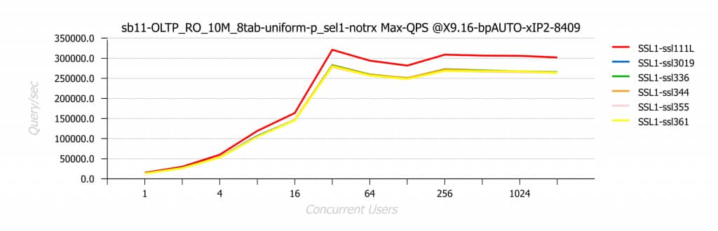

MySQL 8.4.9
BM.44
BM.48
OCI VM X9.16
OCI VM E4.16

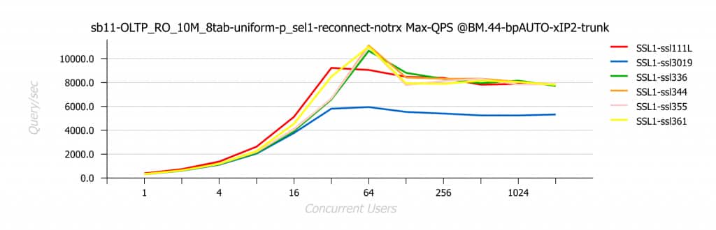

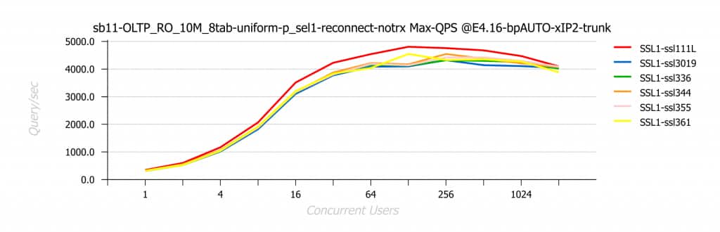

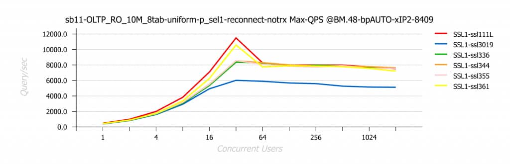

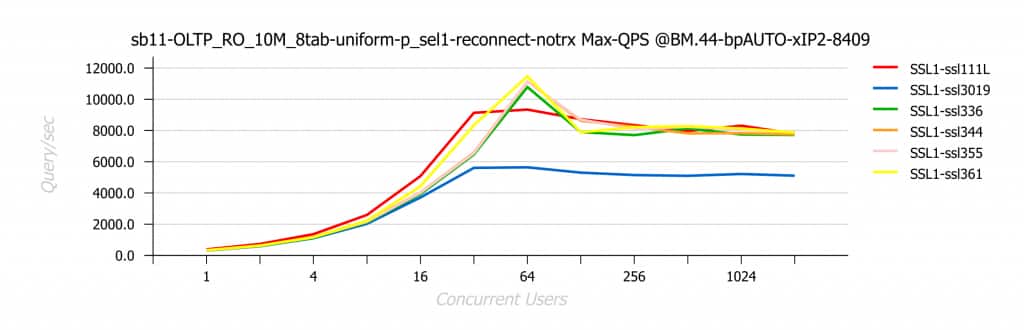

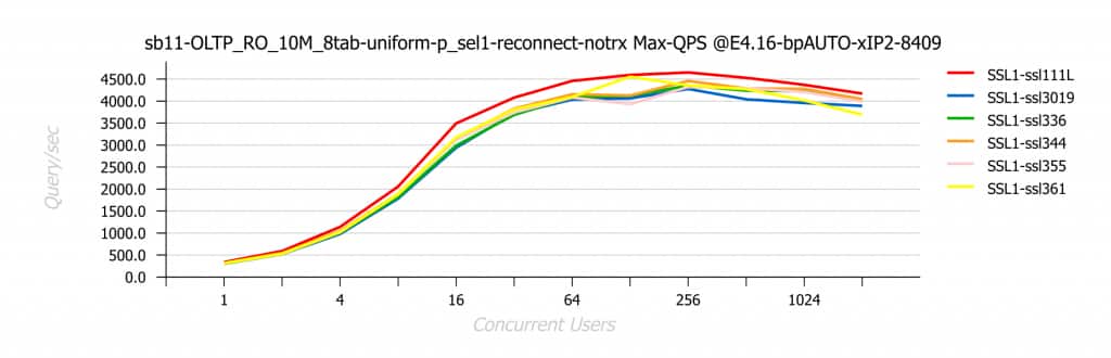

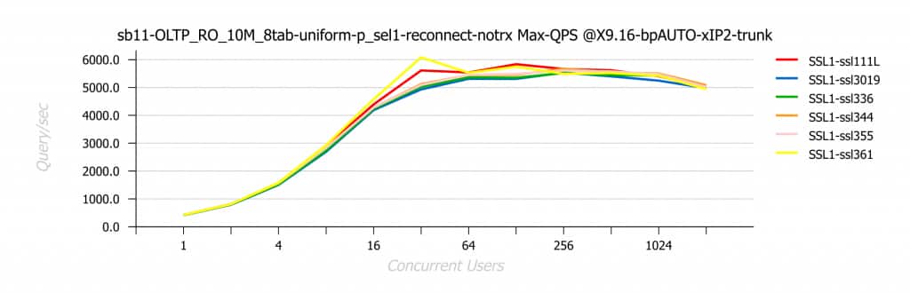

Re-Connects SELECTs Workload | Local-IP
The following are the test results obtained on Re-Connect SELECTs workload executed locally on each server and using local IP-port (loopback 127.0.0.1):
MySQL 9.7 (trunk)
BM.44
BM.48
OCI VM X9.16
OCI VM E4.16
MySQL 8.4.9
BM.44
BM.48
OCI VM X9.16
OCI VM E4.16

From performance perspective, OpenSSL-1.1.1 is generally still the best release delivering highest throughput in majority of cases (but being End-of-Life since 2023).
The good news is that OpenSSL 3.5 shows an improvement over the OpenSSL 3.0, and it’s quite significant in some cases.
Looking at the future, OpenSSL-3.6.1 is giving a hope to see more performance improvements in the next releases, and maybe one day it will catch up to OpenSSL-1.1.1.
