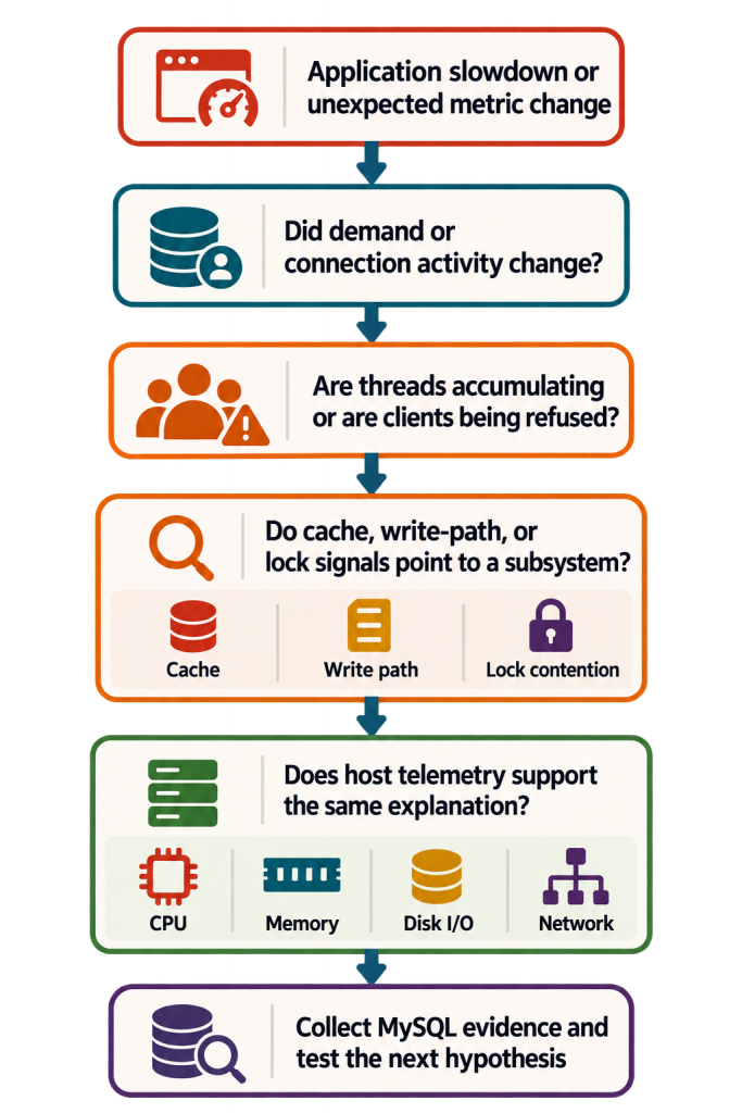

Start with a troubleshooting sequence
Begin with the dashboard question that changes the next decision. A rise in a counter is not enough on its own. Compare it with demand, concurrency, latency, and host context over the same time range.
mysql-troubleshooting-sequence
Figure 1. A troubleshooting sequence that narrows an application slowdown or unexpected metric change into the next MySQL evidence to collect.
Use a narrow time window first, then widen it to compare with the normal pattern. If application traces or application latency metrics are available, align them with the MySQL and host series. OpenTelemetry makes that shared time range practical; it does not eliminate the need to understand the server.

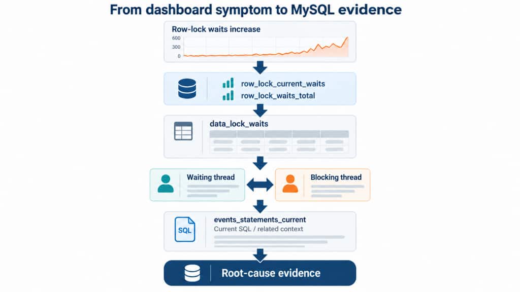

Scenario 5: Row-lock waits point to a blocking relationship
Lock metrics are a good example of the handoff from telemetry to MySQL evidence. A rise in row_lock_current_waits or row_lock_waits_total tells you that transactions are waiting. It does not identify the blocking transaction, the locked object, or the SQL involved.
Figure 2. Move from an aggregate dashboard symptom to the waiting and blocking relationship, then to current SQL and related MySQL context.
Signal and hypothesis
row_lock_current_waits{job="mysql/mysqld", instance="$instance"}
rate(row_lock_waits_total{job="mysql/mysqld", instance="$instance"}[5m])
Current waits show whether contention exists now. The rate shows whether wait events are occurring during the selected window. When either rises with application latency, capture MySQL evidence promptly because the blocking relationship can disappear before a later investigation.
Evidence to collect
The Performance Schema data_lock_waits table links waiting and blocking lock requests. Start with the identifiers, then use the thread identifiers to find the currently executing statements and related transaction context.
SELECT REQUESTING_ENGINE_TRANSACTION_ID AS waiting_transaction,
  REQUESTING_THREAD_ID AS waiting_thread,
  BLOCKING_ENGINE_TRANSACTION_ID AS blocking_transaction,
  BLOCKING_THREAD_ID AS blocking_thread,
  REQUESTING_ENGINE_LOCK_ID AS waiting_lock,
  BLOCKING_ENGINE_LOCK_ID AS blocking_lock
FROM performance_schema.data_lock_waits;
SELECT THREAD_ID, EVENT_ID, EVENT_NAME, TIMER_WAIT, SQL_TEXT
FROM performance_schema.events_statements_current
WHERE THREAD_ID IN (/* waiting and blocking thread IDs */);
Use these results to identify the owning sessions, statements, tables, indexes, and transaction boundaries. The remedy depends on the evidence: query design, transaction scope, concurrency pattern, isolation level, and indexing can all matter. Do not treat a lock-wait rate as a command to change one server variable.
