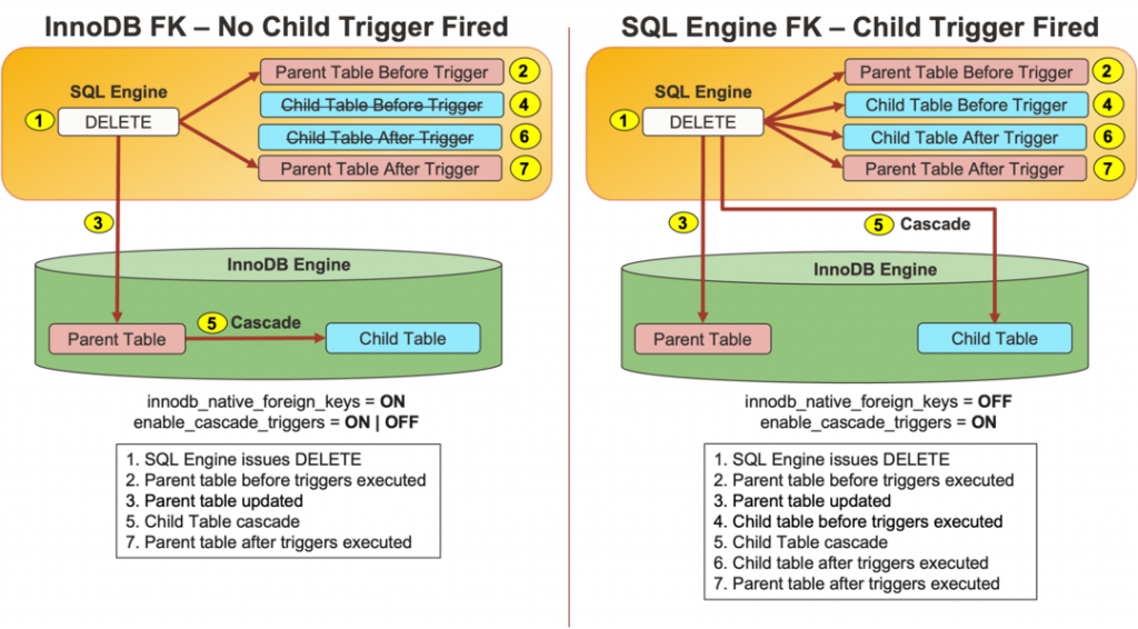

Historically, foreign key cascades were handled inside the InnoDB storage engine. Because triggers are implemented at the SQL layer, engine-level cascades could not invoke triggers.
Starting with MySQL 9.6, MySQL introduced SQL-layer foreign key handling, controlled by server startup variable innodb_native_foreign_keys:
When SQL-layer foreign keys are enabled: innodb_native_foreign_keys = OFF(Default)
  • Cascades are executed in the server layer
  • Trigger dispatch becomes possible
  • Recursion and cascade chains can be tracked
  • Safety limits can be enforced
This architectural change made trigger execution during cascades technically feasible.

Trigger Execution Order
Trigger execution order is important, particularly when both parent and child tables have triggers. When a parent row deletion causes a cascade, MySQL executes triggers in a predictable sequence.
Execution proceeds as follows:
  1. DELETE FROM parent WHERE id = 1
  2. Call BEFORE DELETE trigger of parent table
  3. Cascade to child table
  4. Call BEFORE DELETE trigger of child table
  5. Delete child row
  6. Call AFTER DELETE trigger of child table
  7. Delete parent row
  8. Call AFTER DELETE trigger of parent table
This deterministic ordering ensures that triggers behave consistently and predictably. In case of multi level cascades, parent → child → grandchild, when a parent row is deleted, cascades propagate through the chain following depth-first execution.
