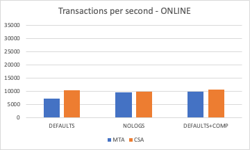

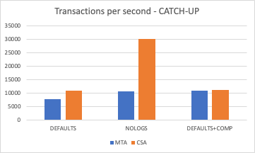

In this Labs benchmark set, results were encouraging, with the strongest backlog gains appearing in lighter durability profiles.
In this section, NOLOGS refers to runs with compression OFF, binlog OFF, redo OFF, and replica-preserve-commit-order OFF. Suffixes such as +REDO and +RPCO indicate which options were enabled for a given run. DEFAULT refers to the fully loaded profile used here, with binlog ON, redo ON, and replica-preserve-commit-order ON, without compression.
Across these 64-worker benchmark runs, the Change Stream Applier usually outperformed MTA in both online apply and catch-up scenarios. In the DEFAULT profile, online throughput improved by about 45% in the 10-update workload (10.5k TPS vs. 7.22k TPS). The largest backlog gains in this set appeared in lighter durability configurations, where representative results included:
  • 54.5k vs. 49.7k in NOLOGS (1 update)
  • 43.8k vs. 36k in NOLOGS+REDO (1 update)
  • 30.2k vs. 10.6k in NOLOGS (10 updates)
  • 25.5k vs. 9.22k in NOLOGS+RPCO (10 updates)
These results suggest that the Change Stream Applier may be especially useful when the goal is to reduce backlog and shorten catch-up time after bursts or maintenance windows, particularly in configurations with less logging and durability overhead.
The results also show that the Change Stream Applier does not outperform MTA uniformly across all tested configurations. Under more durable or compression-heavy configurations, backlog gains were smaller, and in some runs MTA still came out ahead. Resource behavior also varied by workload: in many backlog runs, the Change Stream Applier used more CPU because it completed the work faster.
This benchmark set remains a micro-benchmark, not a full production proxy. It is useful for comparing steady-state throughput and backlog drain behavior, but it does not fully represent conflict-heavy hot rows, multi-channel interference, or long-haul operational tails.
