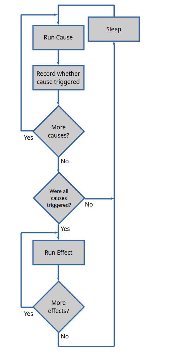

  • Cause – A cause is an event or measurement that can be used to trigger an effect. When a rule contains multiple causes, the causes will be processed in the order they are enumerated in the configuration file. All causes in a given rule are run every loop through adaptived – even if an earlier cause did not trigger. Effects are only invoked if all of the causes in the rule have triggered.
  • Effect – An effect is an action to be taken when the cause(s) in the same rule are triggered. Multiple effects can be connected together in a rule. Baring an error, each effect will run when the associated causes are triggered.
  • Rule – A rule is one or more causes combined with one or more effects. When all of the causes in the rule are triggered, then the effect(s) will be executed. An adaptived configuration file can contain multiple rules.

adaptived’s main processing loop operates as shown in the flow chart below:
adaptived flow chart
