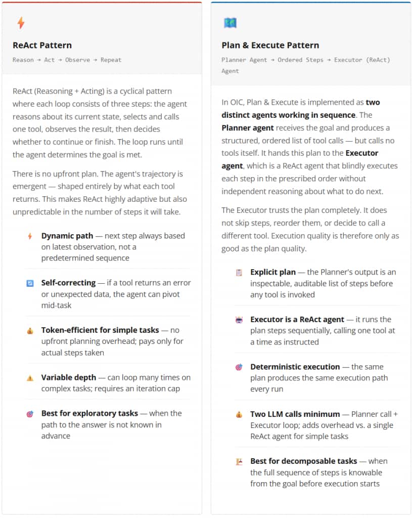

Pattern 01 — Adaptive
⚡ ReAct
Reason + Act — a tight loop where the agent thinks, takes one action, observes the result, then decides the next step. Every action is informed by what just happened.
The agent never has a full plan. It navigates step-by-step, adapting its path in real time based on what tools return.
“I don’t know exactly where this leads — I’ll figure it out as I go.”
Pattern 02 — Methodical
🗺️ Plan & Execute
Plan first, then execute — in OIC, this is implemented as two separate agents: a Planner agent that decomposes the goal into an ordered list of steps, and an Executor agent (itself a ReAct agent) that blindly runs those steps in sequence.
The Planner never calls tools — it only thinks. The Executor never improvises — it only acts on what the Planner prescribed.
“I’ll figure out the full plan first, then hand it off to be executed exactly as written.”
In OIC, Plan & Execute is not one agent — it is two. The Planner thinks without acting. The Executor acts without thinking. Together, they separate strategy from execution.

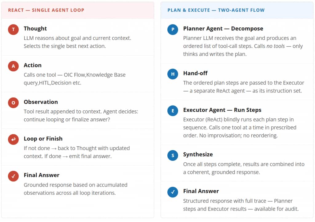

Execution Flow Comparison
execution flow comparison

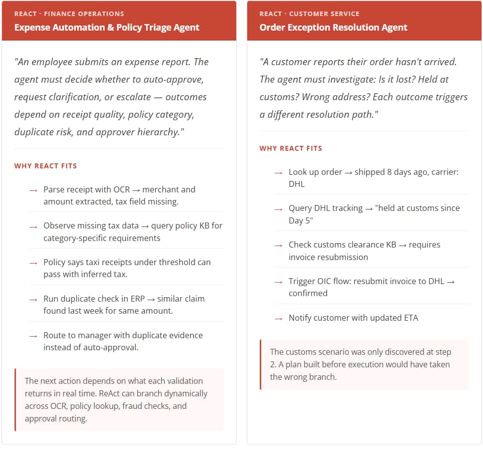

ReAct Use Cases
react usecases

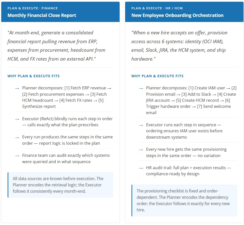

Plan & Execute Use Cases
plan & execute usecases

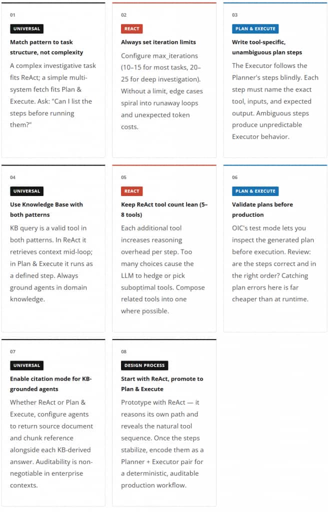

OIC Agent Design Best Practices
These principles apply across both patterns and should guide every agent you build in OIC.
agent design best practices
