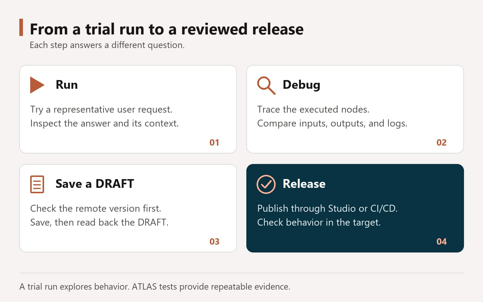

A validated file isn’t a working agent yet. This article covers what happens between your editor and production: trying a workflow with real questions, debugging what it did, saving a DRAFT, and releasing through your pipeline.
Four steps: run a representative request, debug the executed nodes, save a version-checked DRAFT, and release through Studio or CI/CD.
Figure 1. From run to release. Use the trial run, debugger, DRAFT, and release checks for their distinct purposes.
Debugger term: pinned output. Fix one node’s output in the debugger to check downstream nodes without rerunning everything upstream.

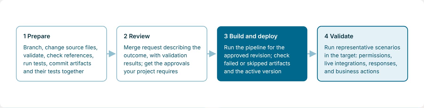

Release through CI/CD
With artifacts and tests as files, they can move through the same Git-based process as code. The process has four stages.
CI/CD in four stages: prepare the change on a branch with validation and tests; submit a merge request with validation results and get approval; build and deploy the approved revision through the pipeline; validate the deployed application in the target environment.
Figure 2. The CI/CD path. Replayed tests prove logic; a live check in the target environment proves the integrations.
