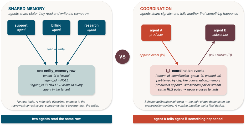

Shared Memory and Coordination
Both of these are top-level categories in the Oracle blog taxonomy because they’re concerns that cut across the type hierarchy. In single-agent systems they collapse into normal LTM scoping. In multi-agent and multi-tenant systems they need separate treatment.
Shared Memory
Shared memory is any LTM row that multiple agents read and write under the same access boundary. The structural definition falls out of the scope columns directly: a row is shared when it sits at a scope broader than a single agent, which means agent_id IS NULL (shared across every agent in the tenant) or agent_id = '<group_id>' (shared across a defined coordination group).
A few examples to make this concrete inside a single SaaS tenant:
  • A support agent learns that “Acme’s production database moved from us-east-1 to eu-west-1.” Writing this as an entity_memory row at (tenant_id = 'acme', user_id = NULL, agent_id = NULL) makes it visible to every agent serving Acme. Whatever the support agent learns, every agent on the tenant can use. Compounding advantage across the whole tenant.
  • A billing agent and a support agent need to coordinate on whether a refund request has been approved. The decision lives in summarization_memory at (tenant_id = 'acme', user_id = :user_id, agent_id = NULL), where both agents can read it, neither agent owns it exclusively.
  • A research-assistant agent maintains a workflow (“how we evaluate competitor papers”) that should be available to every research assistant Acme spawns. The workflow row sits at (tenant_id = 'acme', agent_id = NULL) so any agent instance can find it.
Shared memory doesn’t need a new table type. It’s a write-side discipline: when promoting a candidate to LTM, the manager picks the narrowest scope that’s actually correct, and “actually correct” sometimes means broader than the agent that wrote it. The promotion gate from “From RAG to Memory Systems: Building Stateful AI Architecture” is where that decision belongs. Default to user scope, and promote to tenant scope only when the subject of the fact is the tenant entity itself and the fact has been observed from two independent sources.
What shared memory does need is read-side coordination. Two agents writing facts about the same subject at the same time can produce contradictory rows if the writes overlap. The supersession pattern handles the resolution (later write wins by version), but the agents themselves need to know they might be writing on top of each other. The simplest pattern is optimistic concurrency: the manager’s supersede_fact method checks that the row being superseded is still at the version the caller saw at read time, and raises a retry-able conflict if it isn’t.
Coordination
Coordination is the cross-agent messaging layer. Agent A finishes a step and hands off to Agent B. Agent C broadcasts an event that other agents subscribe to. Agent D queries the system for “who’s working on this customer right now.”
This post doesn’t define a schema for coordination memory because the design space is still wide open. Many different patterns have emerged and new ones are still being experimented with. The right shape depends on the orchestration runtime as much as on the memory layer. The thing worth naming explicitly is that coordination is a separate concern from shared memory. Shared memory is “two agents read the same row.” Coordination is “Agent A tells Agent B that something happened.”
A working baseline for coordination in a multi-tenant SaaS context: events go into a partitioned table scoped by (tenant_id, coordination_group_id, created_at), with the same partitioning strategy as conversation_memory. Subscribers poll or stream from the table; producers append. The table participates in the same RLS policy as everything else, so coordination events never cross tenants by accident.
Side-by-side comparison of two multi-agent patterns. Shared memory shows multiple agents reading and writing the same tenant-scoped entity-memory row. Coordination shows one agent publishing coordination events that another agent reads by polling or streaming. Shared memory exchanges state, while coordination exchanges signals, with tenant isolation enforced in both patterns.
Shared memory and coordination, side by side.

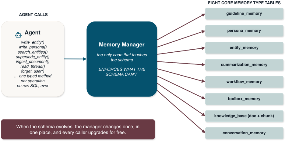

The Memory Manager: one door into the schema
The schema is the contract. The Memory Manager is the only code allowed to touch it. Every read and write goes through the manager, and it enforces what the schema can’t. Every operation carries tenant context, all durable write carry provenance, data lands in the table that matches its type, and supersession runs in one transaction instead of an error prone multi-step process.
The interface is small and shaped exactly like the typed tables it wraps. Eight write methods, eight read methods, one supersession method per supersedable type, one delete method. The one rule worth holding the line on is no escape hatch that bypasses the schema, because the moment one exists, every team that finds it will use it.
 class MemoryManager:
      """One door into the schema. Tenant context comes from scope_ctx and is
      enforced by RLS; the manager adds provenance, dedup, embedding, and
      transactional supersession on top."""
      def __init__(self, db, scope_ctx): ...   # scope_ctx sets the tenant context for RLS
      # WRITES — one typed method per memory type; provenance required on durable types
      def write_entity(self, *, subject, predicate, content, confidence,
                       written_by, source_event_id,
                       user_id=None, agent_id=None, thread_id=None): ...
      # write_guideline, write_persona, write_summarization, write_workflow,
      # write_toolbox, ingest_document, write_conversation_event follow the same shape
      # READS — scoped retrieval; the tenant predicate is applied automatically
      def search_entities(self, query, *, user_id=None, agent_id=None, top_k=10): ...
      # read_active_guidelines, read_active_personas, read_active_toolbox,
      # search_summarizations, search_workflows, search_knowledge_base, read_thread
      # SUPERSESSION — versioned, with optimistic concurrency
      def supersede_entity(self, entity_id, *, new_content, written_by,
                           source_event_id, confidence, expected_version): ...
      # DELETION — right-to-forget, one transaction each
      def forget_user(self, user_id): ...
      def forget_tenant(self): ...
Four invariants show up across every method. Tenant context is read from scope_ctx, never passed by the caller, because the application set it once per request and the database is already enforcing it via RLS. Provenance is a required parameter on durable types; the manager refuses any write to a durable type (entity, summarization, conversation_event) that’s missing its source_event_id. Supersession is one method per supersedable type, and it takes expected_version so concurrent writes get a retry-able conflict instead of silently clobbering each other. And deletion comes in two flavors (user, tenant), both wrapped in a single transaction internally.
The read side has its own invariants, and they’re as important as the write ones. Every read filters the same way: deleted_at IS NULL, valid_until IS NULL or still in the future. A superseded fact carries a stamped valid_until, so the moment a newer version lands the old one drops out of every read without anyone asking for it, and an expired record drops out the same way when its clock runs out. Because that predicate lives in the manager rather than in each caller, there’s no read path that can accidentally surface a stale or superseded row.
Precedence across types is really two questions, and conflating them is where retrieval designs usually go wrong. The first is governance: an authored guideline outranks an inferred preference, every time. Policies load in full into the static prefix because a rule that applies has to apply, and an inferred value carries a confidence the manager can gate against a policy-supplied floor, so a weak guess never overrides an explicit instruction. The second is relevance: when an entity, a summary, and a vector hit all speak to the same query, the manager doesn’t crown a winner. It tags each result with its type and a relevance tier and hands them back for the prompt to slot into the right region. Fusing those evidence types into a single ranking, or reranking across them, is a real pipeline and deserves its own post. The manager’s job is to keep the candidates honest and labeled. Collapsing them comes later, in a stage built for it.
The manager is also the seam where filesystem-style ergonomics meet database substrate. From the agent’s perspective, calling manager.write_entity(...) feels like writing a row to a notebook. The manager handles storage and indexing, the scope check, provenance, dedup, embeddings, supersession bookkeeping, and the tenant boundary. The agent code never writes raw SQL and never sees the schema directly. When the schema evolves, the manager changes in one place and every caller upgrades for free.
Diagram showing a memory manager between agents and eight memory tables. Agents call typed methods such as writing entities, personas, documents, reading threads, and forgetting users. All requests pass through the memory manager, which is the only component that accesses the schema. It routes operations to guideline, persona, entity, summarization, workflow, toolbox, knowledge-base, and conversation memory tables, centralizing schema changes and business rules.
Memory Manager surface.

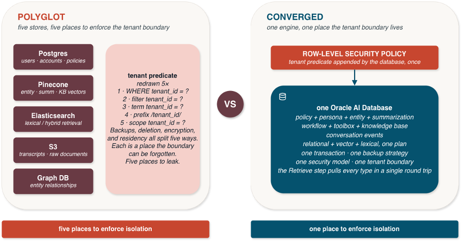

Why one engine wins for multi-tenant SaaS
By this point the schema is eight tables, four scope dimensions, row-level security on every table, transactional lifecycles, and a manager that wraps it all. The remaining question is where to put it. The polyglot persistence trap from From RAG to Memory Systems: Building Stateful AI Architecture applies here with extra force, because every cross-system pain point in a single-org agent compounds in a SaaS provider running thousands of tenants.
The accidental architecture goes the same way it always does. Postgres for users, accounts, and policies, and while Postgres handles vectors and full-text search these days, at multi-tenant SaaS scale the workloads tend to split out anyway. A dedicated vector database for the entity, summarization, and knowledge-base embeddings. Elasticsearch or OpenSearch for the lexical side of hybrid retrieval. Object storage for raw conversation transcripts and ingested documents. Maybe a graph database for entity relationships.
Each component is a reasonable choice for the job it was built for. The pain begins the moment a cross-system operation has to honor tenant boundaries.
Backups split four ways and each one needs a tenant-partitioned strategy. Security models split four ways and each one needs the same tenant predicate enforced. Deletion splits four ways and a partial deletion in one of them is a regulatory finding. Per-tenant encryption splits four ways and key rotation has to coordinate across all of them. Per-tenant data residency (Acme’s data must stay in EU; Globex’s in US) splits four ways and each system has to support the same residency rules independently.
Oracle AI Database is a great choice for this architecture because one engine can host policy data, persona data, entity data with embedding columns, summarization data with embedding columns, knowledge-base documents and chunks, workflow definitions, toolbox definitions, and conversation events, all under one row-level security model that ties tenant isolation to a session context the application sets once per request.
Because it’s all one engine, the agent’s Retrieve step pulls every memory type it needs in a single round trip. Each branch of a UNION ALL returns the same shape (type, vec_score, lex_score, relevance, payload), so guidelines, personas, toolbox definitions, entities, summarizations, workflows, knowledge-base chunks, and the recent conversation tail all come back from a single query plan, with the tenant predicate enforced by RLS on every branch (condensed for brevity):

It collapses to one query plan over one transactional snapshot, governed by a single security model, backup strategy, and tenant boundary. The query optimizer decides whether to apply the JSON predicate before or after the vector ranking. The application doesn’t coordinate across systems because there are no other systems to coordinate with.
A few things still don’t collapse cleanly. High-volume conversation memory at SaaS scale (millions of events per day across thousands of tenants) sometimes belongs in a store tuned for high-cardinality append-only workloads, with the OLTP engine handling everything else. Large blob assets (raw PDFs of ingested documents, generated images, video tool outputs) belong in object storage, with only their metadata living in the database. The collapse that matters is between the seven LTM tables that hold the agent’s actual knowledge (guidelines, personas, entities, summarizations, workflows, toolbox, knowledge base) which is where every meaningful retrieval join lives. Conversation memory and blobs can sit alongside; the join across the seven core types is the one the converged engine wins.
In a multi-tenant SaaS context, “one less system to enforce tenant isolation in” is the load-bearing benefit. Every external system is a place tenant boundaries can be forgotten. Collapsing the join surface into one engine collapses the security surface into one system, and that’s the architectural property that compounds across every feature added afterward.
Side-by-side comparison of polyglot and converged architectures. The polyglot approach stores data across PostgreSQL, Pinecone, Elasticsearch, S3, and a graph database, requiring tenant isolation to be enforced separately in each store. The converged approach uses a single Oracle AI Database with one row-level security policy protecting relational, vector, knowledge, workflow, and conversation data, providing one place to enforce tenant isolation.
Polyglot vs converged in multi-tenant SaaS.

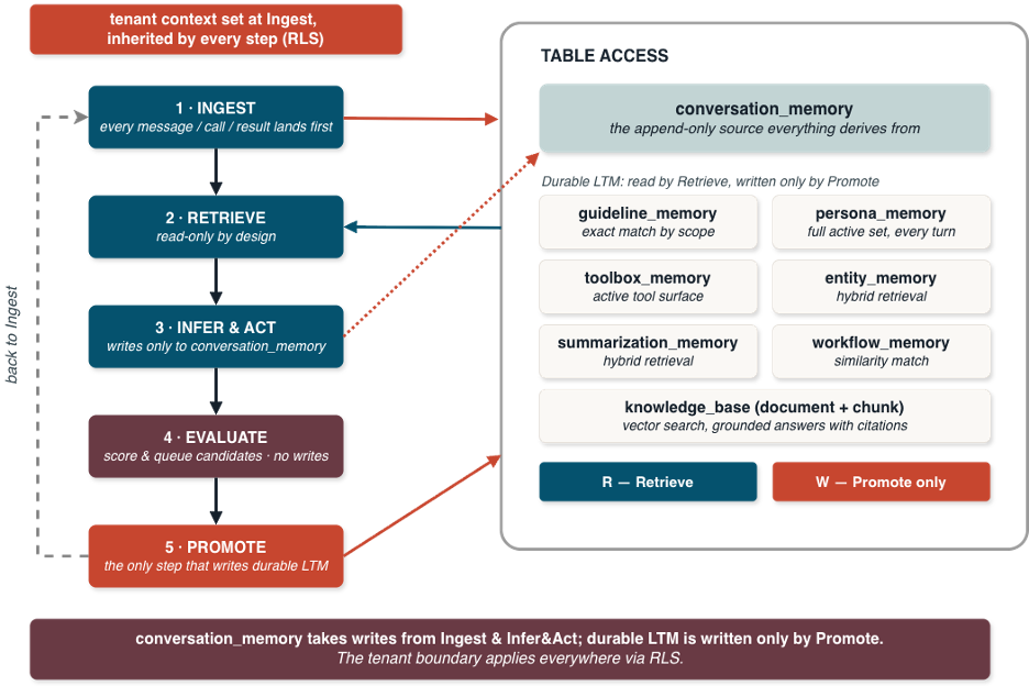

From schema to running agent
The schema doesn’t exist for its own sake. It exists to be read from and written to by the agent loop, in a specific pattern that gives the architecture its predictability. Tying the two together is what turns the design from a data dictionary into an architecture.
The loop has five steps: Ingest, Retrieve, Infer & Act, Evaluate, Promote. Each step reads from and writes to specific tables, and the write rules are deliberately narrow.
Ingest writes to conversation_memory. Every user message, every tool call, every tool result, every model response lands as a conversation row first, before anything else happens. Conversation is the source from which everything else gets derived; if a piece of state didn’t make it into a conversation row, it can’t be reconstructed later.
Retrieve reads from the durable tables. Active guidelines via exact match by scope. Active personas via exact match by scope (the full set, every turn). Active toolbox via exact match by scope. Entities via hybrid retrieval. Summarizations via hybrid retrieval. Workflows via similarity match if the current task looks like one we’ve seen before. Knowledge base via vector search if the query is grounded in reference content. The semantic cache via vector search over recent conversation_memory if the user’s reference points outside the volatile tail. No writes in this phase. Retrieve is read-only by design.
Freshness and conflict deserve a callout here. The manager filters deleted, expired, and superseded rows at read time, so nothing stale reaches assembly. When current rows still disagree, Retrieve doesn’t pick a winner. The canonical typed tables are the source of truth, so a summary or semantic-cache hit ranks below the structured fact it came from. Each candidate comes back tagged by type, with its confidence and provenance, leaving fusion and reranking to a later stage. Guidelines are the exception. They apply in full, above the scored evidence, for the governance reasons the Memory Manager section covers.
Infer & Act reads the assembled context and writes back to conversation_memory (model response, tool calls, tool results, optional session_state events). It does not write to any other table directly. The agent’s reasoning doesn’t get promoted to entity memory by virtue of being uttered; it has to earn its way in through the promotion gate.
Evaluate runs the extraction passes for candidate entities, candidate personas, candidate summarizations, and candidate workflow updates. These get scored and queued. They don’t get written to durable tables yet.
Promote is the only step allowed to call write_entity, write_persona, write_summarization, write_workflow, supersede_*, or ingest_document. The promotion gate lives here. Each candidate gets type-specific verification, dedup, scope assignment, and a transactional write. Promote is the only step that modifies the durable LTM layer.
This narrow write rule is why provenance works. Every durable write happens inside the Promote step, which means every durable write has a clear source_event_id (the conversation event the candidate was extracted from) and a clear written_by (the agent that ran the extraction, or 'promotion_job' if it ran in a background worker). Writing to durable memory from inside Infer & Act is a code-review smell worth catching every time.
Diagram showing a five-stage agent memory lifecycle: Ingest, Retrieve, Infer and Act, Evaluate, and Promote. Tenant context is applied at ingest and enforced throughout with row-level security. Conversation memory receives writes during ingestion and inference. Durable memory tables, including guideline, persona, entity, workflow, toolbox, summarization, and knowledge base, are read during retrieval and written only during the Promote step.
Loop steps and table access in a multi-tenant context.
