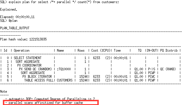

Px In Memory
This plan note is only related to IMPX and not related to DBIM. It shows whether the statement uses IMPX or not. If you see yes here it means some or all of the tables in the query are accessed through the buffer cache rather than doing direct reads from disk. IMPX looks at the table sizes and the buffer cache size and decides whether to read the blocks into the buffer cache or not. Once the blocks are in the buffer cache subsequent parallel statements can read the data from there rather than going to the disk. In the case of RAC, IMPX makes sure that PX servers are allocated on the nodes where table blocks reside, as a result of this cache fusion is not used to transfer blocks between nodes which in turn makes performance better.
This plan note in SQL Monitor maps to the note parallel scans affinitized for buffer cache in the DBMS_XPLAN output. Here is an example showing IMPX will be used.
The first access to the CUSTOMERS table will read the data from the disk to the buffer cache, subsequent accesses to this table will read data from the buffer cache. The term affinitized here means that specific blocks are assigned to specific nodes and PX servers on those nodes will read the data through the buffer cache.
You will see this note if IMPX is used independent of whether you are on a single-instance database or a RAC database.
So, if you see the note parallel scans affinitized for buffer cache in the DBMS_XPLAN output you will see Px In Memory=yes in SQL Monitor.

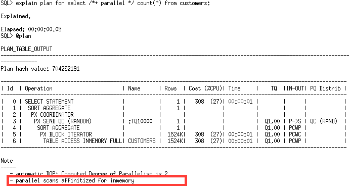

Px In Memory Imc
This plan note is only related to DBIM and not related to IMPX. IMC here means In-Memory Columnar which indicates DBIM. The IMC store provides metadata that shows which part of an in-memory table is in which node’s memory in a RAC database. Parallel Execution uses this information to allocate PX servers on those nodes so that they can read the data from the IMC store without going to disk. The plan note Px In Memory Imc shows whether the statement accesses an in-memory table and whether PX servers are affinitized to RAC nodes. This does not indicate if DBIM is used or not, that is indicated by the operations in the plan like TABLE ACCESS INMEMORY FULL.
This note maps to the note parallel scans affinitized for inmemory in the DBMS_XPLAN output. Here is an example showing in-memory affinity is used.
In a single-instance database you will not see this note because any PX server can read the data from the single node’s IMC store and there is no concept of affinity of PX servers to nodes.
So, if you see the note parallel scans affinitized for inmemory in the DBMS_XPLAN output you will see Px In Memory Imc=yes in SQL Monitor.

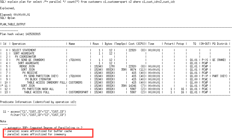

One or The Other?
It is possible to have parallel statements using both IMPX and DBIM. If your statement accesses both in-memory tables and tables determined to be read via the buffer cache you can see both notes in the plan output.
In this example, CUSTOMERS table is an in-memory table and since this is a RAC database PX servers are affinitized to nodes. CUSTOMERSPART table is not an in-memory table but Parallel Execution decided to read it through the buffer cache.
