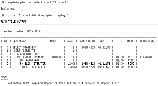

Let’s look at a statement accessing the large table.
The DOP is capped at 4 even though PARALLEL_DEGREE_LIMIT is 128. This is because CPU_COUNT * PARALLEL_THREADS_PER_CPU is 4

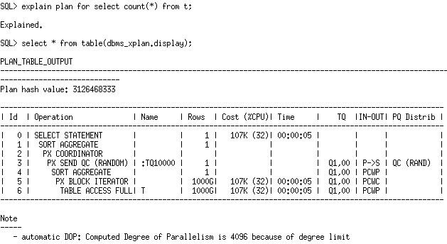

The only caveat with parallel_max_degree is it can only show values up to 4095 (4K-1). Above this number is starts over from 0. If you bump up one of the variable in the formula, like CPU_COUNT, you will see cases like below.

In these cases the maximum DOP you can get will be different than parallel_max_degree.
So, you can rely on this value if your CPU_COUNT is not in the two thousands range! If you have such a huge system use the formula given above to calculate max DOP allowed. And please let me know how you are using parallel execution in such an environment 🙂
