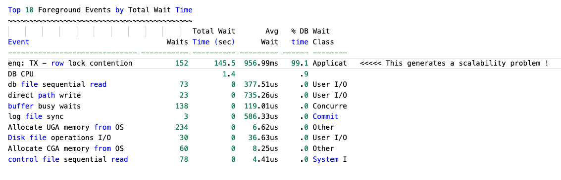

Take care to collect an AWR snapshot before and after running this code. Then generate an AWR report between these two snapshots.
This is the AWR output for the TOP 10 foreground events:
Top10 foreground events with standar row locking
You can observe that more than 99% of the DB Time was spent on event “enq: TX – row lock contention”, which will generate a clear scalability problem. This is because of the standard row locking mechanism: updating a row requires acquiring an exclusive lock on this row.
And because of the 1sec think time, this lock is held 1sec during each update operation.

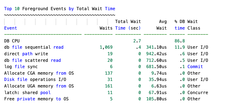

Top10 foreground events using reservable columns
Observe how the waits on “enq: TX – row lock contention” disappeared: as the exclusive lock is only required on commit, the application sessions don’t spend think time holding an exclusive lock on the row they want to update!

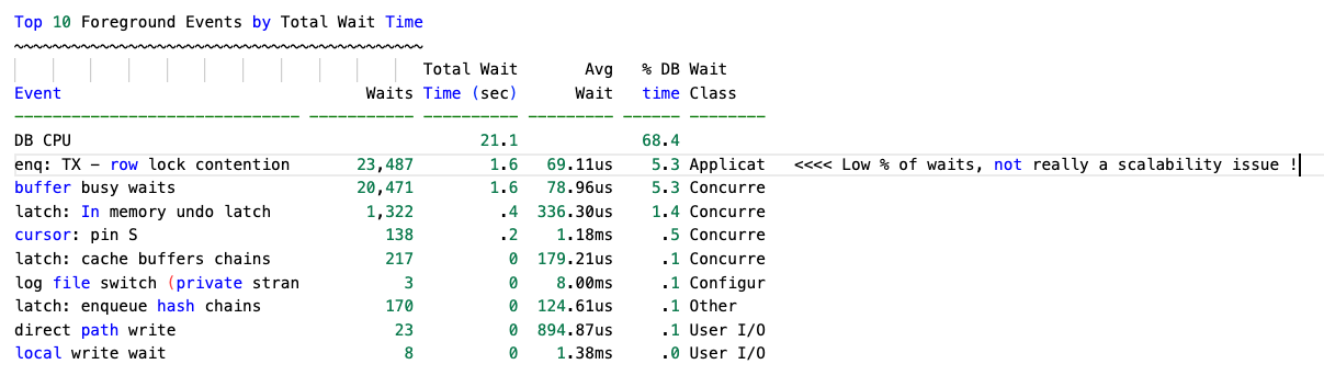

Top10 foreground events - Standard locking with batch processing
Observe that even if there are waits on event “enq: TX – row lock contention”, their percentage of the DB time is not representing a scalability problem. It’s because as there is no think time, the exclusive lock is held very short time (70 microseconds on average vs almost 1 sec on average during Test 1).

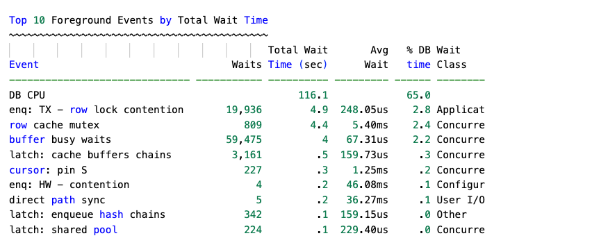

This is the AWR output for the TOP10 foreground events:
Top10 foreground events - Reservable column in Batch mode
In this case, we observe no real mitigation on the “enq: TX – row lock contention” wait event. We observe 4.9 sec waiting on “enq: TX – row lock contention” event, versus 1.6 sec during the previous test, being the lock held on average 248 microseconds versus 70 microseconds during the previous test. And the CPU time was significantly higher during this test: 116 sec versus 21 sec during the standard locking test.
