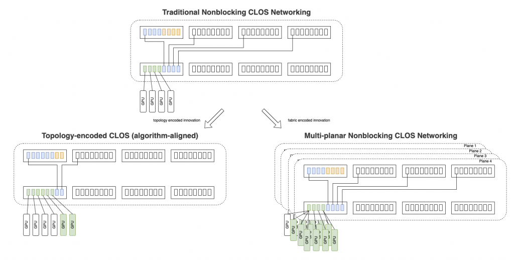

To push GPU clusters beyond these limits, two architectural directions have emerged.
The first is topology-encoded, blocking RDMA networking, which scales by embedding collective communication assumptions directly into hardware topology—often described as fractal or hierarchical designs. This approach favors specialization and fixed communication patterns to extend scale.
The second is multi-planar, non-blocking fabric-encoded networking, which preserves non-blocking semantics while extending scale through system-level innovation. Rather than hard-coding assumptions into topology, it introduces additional planes and coordination mechanisms to maintain predictable performance as clusters grow.
In this blog, we examine both approaches and explain how OCI addresses this challenge. We show how multi-plane networking, together with purpose-built Acceleron RoCE hardware, enables scaling beyond single-fabric limits—while preserving flexibility, predictability, and operational stability for the next generation of AI workloads.

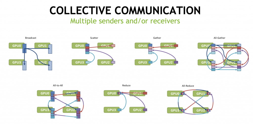

Modern AI training relies heavily on collective communication operations such as AllReduce, ReduceScatter, and AllGather. Libraries like NCCL implement these collectives using structured patterns—rings, trees, and hierarchical combinations—to balance bandwidth utilization, synchronization cost, and GPU efficiency.
Fig. 2. Collective Communication Basics.
Image from https://images.nvidia.com/events/sc15/pdfs/NCCL-Woolley.pdf
These collective algorithms implicitly define a communication graph: a structured, repeating pattern of data exchange executed at every training step.
Fractal, or topology-encoded, AI networking emerges when this communication graph is materialized directly in hardware topology. GPUs are organized into tightly coupled local domains, and those domains are recursively composed into larger structures. Global collectives are decomposed into staged operations that closely follow this physical hierarchy, minimizing long-distance traffic and concentrating communication along predefined paths [ref 4, 5, 9–12].
In this model, topology follows the algorithm.
This approach is a rational response to physical constraints. As GPU clusters grow, building a single, flat, fully non-blocking RDMA fabric becomes increasingly difficult. Switch ASIC buffers must absorb in-flight packets to preserve lossless behavior, and buffering requirements scale with bandwidth × latency × hop count. At extreme scale, these requirements exceed what a single fabric can practically provide.
To address this, some systems intentionally introduce blocking CLOS behavior, using topology and scheduling to constrain traffic patterns rather than allowing unconstrained all-to-all communication. By shaping the network to match expected collective behavior, fractal designs reduce contention, lower buffer pressure, and improve efficiency for large-scale language model training.
The term fractal reflects this recursive geometry: small, tightly connected groups repeat at multiple scales, mirroring both the structure of collective algorithms and the hierarchical decomposition of communication.
When workloads are stable, parallelism strategies are fixed, and placement is predictable, fractal networking can be extremely efficient—often enabling scale beyond what a flat non-blocking fabric could support.

However, flexibility alone is not sufficient. At extreme scale, even the best non-blocking fabric eventually encounters hard physical limits. To continue scaling, flexibility itself must scale beyond a single fabric.
Scaling Beyond Physical Limits: Multi-Plane Networking
As AI clusters grow toward hundreds of thousands—and eventually millions—of GPUs, a fundamental limitation emerges: switch ASIC buffer capacity.
Lossless RDMA requires buffering in-flight packets. Buffer demand increases with bandwidth, latency, and hop count. Beyond a certain scale, no single switch ASIC can provide enough buffering to sustain lossless behavior—regardless of topology [ref 3].
OCI’s answer is multi-plane networking.
Fig. 3. Multi-planar Network.
Image from: https://blogs.oracle.com/cloud-infrastructure/first-principles-oracle-acceleron-multiplanar
Rather than forcing all traffic through a single logical fabric, OCI distributes traffic across multiple independent network planes. Each plane operates as its own non-blocking, lossless fabric with independent buffering, congestion control, and fault domains.
From a system perspective, this achieves a critical outcome: buffering capacity scales with the number of planes, rather than being capped by a single ASIC.
This is not a simple “add more links” solution. Multi-plane networking introduces real challenges, including traffic distribution and packet ordering across planes, preserving lossless semantics end-to-end, preventing congestion coupling, and maintaining predictable latency under dynamic, multi-tenant workloads. These challenges must be solved holistically—across hardware, firmware, and software—to behave as a single coherent system.
