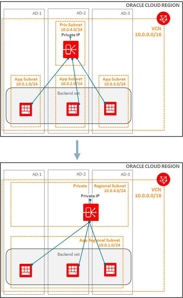

The following diagrams, taken from the Oracle Cloud Infrastructure documentation, show the difference between how the availability-domain-specific load balancer works and how the new regional load balancer works. In the first diagram, the private subnet with the CIDR range of 10.0.4.0/24 exists only in AD-2, and would therefore not be fault tolerant if AD-2 were to go completely offline. In the second diagram, that the same private subnet, deployed as a regional subnet, is available across all three availability domains. This configuration enables the load balancer’s IP address to float between all three availability domains.
Notice the different outcome if a failure causes AD-2 to go offline. In the first diagram, the load balancer’s IP address also goes offline and your workload likely stops receiving requests. However, if you’re using a private regional load balancer, as in the second diagram, the private IP address can move or failover to a different availability domain and continue to serve requests. This functionality helps to increase the availability of your load balancers and provide additional stability to your workload.

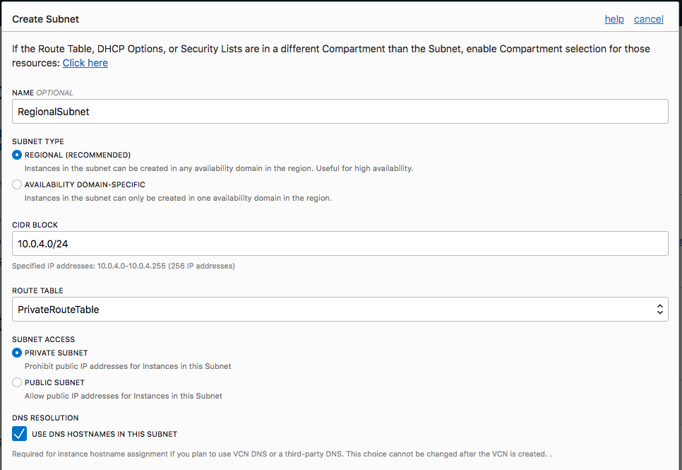

The following screenshot shows that the default (recommended) option for subnet creation in the Oracle Cloud Infrastructure Console is now Regional. When you select this option, you don’t select an availability domain for the subnet. These are the only differences between creating a regional subnet and an availability-domain-specific subnet.

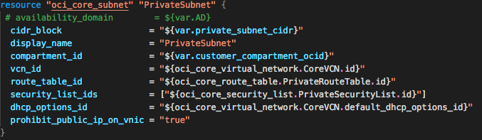

When you deploy a regional subnet from Terraform, you no longer add the availability_domain attribute, as you would with an availability-domain-specific subnet. This is shown in the following screenshot:
Note: Removing this attribute in the Terraform code for an existing availability-domain-specific subnet initiates a destroy operation and does not succeed on any subnet that has any VNIC-attached resources.
We encourage you to try it. See a full Terraform sample to expedite your success.

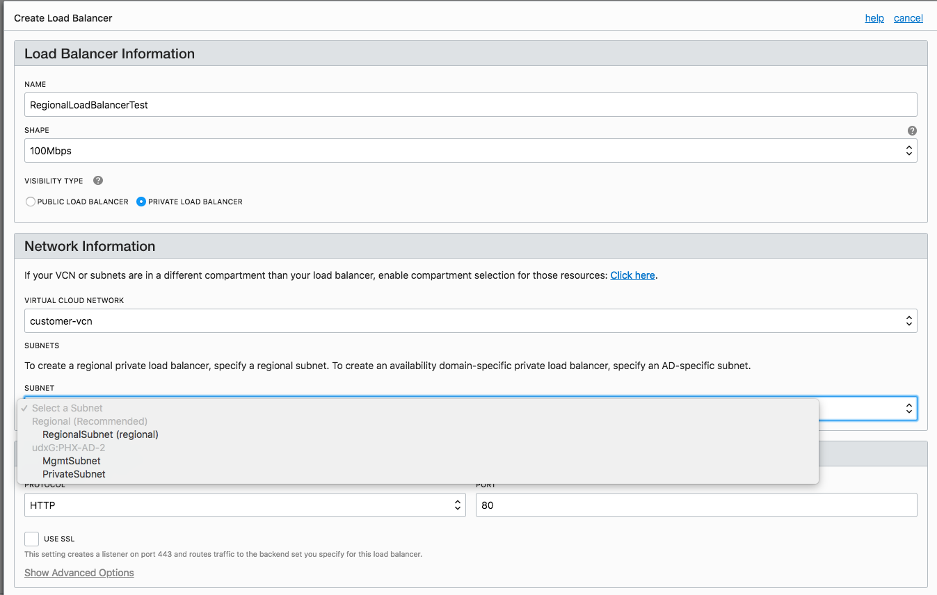

The following screenshot shows that the Subnet field now has a Regional (Recommended) section. Instead of selecting an availability-domain-specific subnet, you now select the new regional subnet.

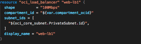

When you perform this operation in Terraform, you don’t need to modify your template. Simply ensure a regional subnet is selected, and the load balancer will be regional as well.

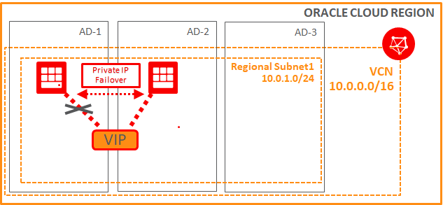

In addition to load balancing, many other applications and clustering solutions use the concept of a virtual “floating” IP address failover. In these scenarios, a cluster of machines is typically connected via a heartbeat, and a failover mechanism causes the IP to move back and forth because of changes in the “active” node that clients use. Before regional subnets, during a failover operation you could move the virtual IP address to an instance only in the same subnet. Now you can move that private IP address to an instance in any of the availability domains.
This design allows your application to be redundant between availability domains with virtual IP failover. For an example of how you can move a virtual IP between two different instances in a cluster setup by using Pacemaker, Corosync, and Oracle Cloud Infrastructure, see the Automatic Virtual IP Failover on Oracle Cloud Infrastructure blog post.
