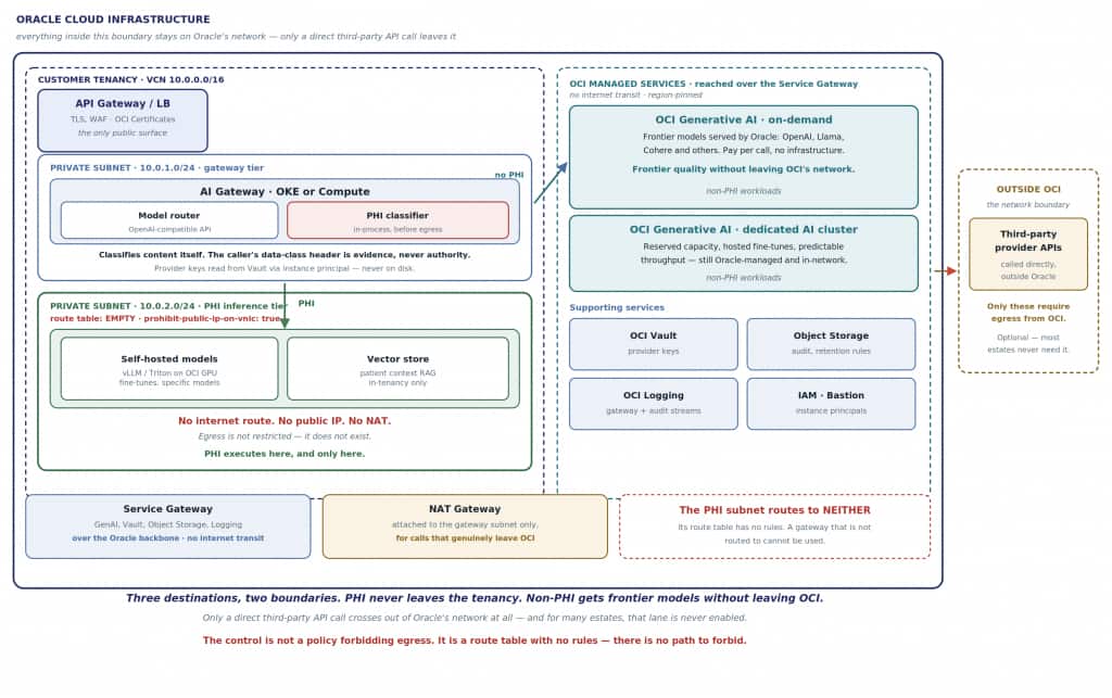

The architecture
PHI for regulated AI on OCI
Walking the OCI constructs that make it work, and why each is load-bearing:
The empty route table
The PHI inference subnet is attached to a route table containing no rules. No internet gateway, no NAT gateway, no service gateway.
This is the control. Everything else supports it.

Gateways attached to subnets, not to the VCN
An easy misconception: a NAT gateway is a VCN-level resource, so surely everything in the VCN can use it?
No. A gateway is only reachable if a subnet’s route table points at it. The NAT gateway here serves the gateway tier only — the subnet that legitimately needs to reach approved external providers. The PHI subnet’s route table does not reference it, so for that subnet it may as well not exist.
A gateway that is not routed to cannot be used.
Service Gateway, and the boundary people draw in the wrong place
The gateway tier needs OCI Vault for provider credentials, Object Storage for audit records, and OCI Logging. Under a naive design, all of that means internet egress.
The Service Gateway routes to OCI services over Oracle’s backbone without traversing the internet. So a tier can be fully functional — secrets, audit, logs — while never having a route to a public network.
This is also where OCI Generative AI sits, and it is the thing most architecture diagrams get wrong.
The instinct is to draw two categories: my instances and everyone else. So managed models end up next to third-party APIs, both outside the boundary. That is the wrong cut.
The boundary that matters for a regulated workload is not “is this my instance?” It is “does this API call leave Oracle’s network?”
By that measure there are three destinations, not two:
DestinationWhere it runsLeaves OCI?
Self-hosted models in your subnetYour GPUs, your VCNNo — and no route out at all
OCI Generative AI, on-demand or dedicated clusterOracle-managed, region-pinnedNo — Service Gateway, Oracle backbone
Third-party provider APIsSomeone else’s cloudYes — this is the only true egress
That middle row is the one worth dwelling on, because it is where the story gets better rather than more restrictive. OCI Generative AI serves frontier models — OpenAI, Llama, Cohere and others — on demand, and dedicated AI clusters for reserved capacity and hosted fine-tunes. Frontier quality, Oracle-managed, and the request never leaves OCI’s network.
So the non-PHI lane does not have to mean “send it to a third party”. For many estates it means managed OCI models, and the third-party lane is never enabled at all.
Self-hosting then earns its place for specific reasons — a particular model, a fine-tune you control, or an explicitly customer-owned execution environment for regulated data — rather than being the only option that keeps data in bounds.
