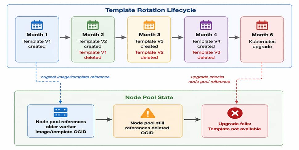

Worker images and Kubernetes upgrades are often managed on different schedules. As a result, a node pool can continue referencing a worker image that has been retired or deleted. The issue may remain hidden until a worker node upgrade or node cycling operation occurs, at which point OKE may fail because the node pool still references an image that no longer exists.
This article examines why the issue occurs and presents a recovery workflow, validated in an OKE Enhanced Cluster, that allows a managed node pool to be recovered while preserving worker node metadata.
Why This Happens
A worker image is assigned to a managed node pool and later replaced by newer images as part of routine lifecycle management. Over time, older images may be retired or deleted while the node pool continues referencing the original image. When a worker node upgrade or node cycling operation is initiated, OKE may attempt to use the stale image reference, causing the operation to fail even though the upgrade itself is valid.

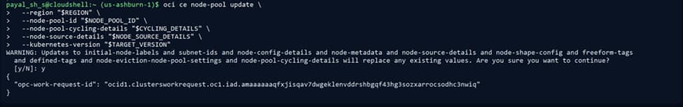

Step 5: Update the Node Pool
oci ce node-pool update \
--region "$REGION" \
--node-pool-id "$NODE_POOL_ID" \
--node-pool-cycling-details "$CYCLING_DETAILS" \
--node-source-details "$NODE_SOURCE_DETAILS" \
--kubernetes-version "$TARGET_VERSION"

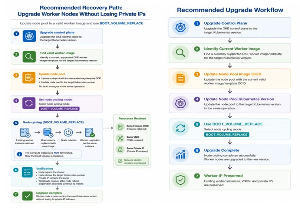

Recommended Recovery Workflow
If a managed node pool references a deleted worker image or template, update the node pool to use a valid worker image before upgrading the worker nodes. In environments where preserving worker node network identity is important, use BOOT_VOLUME_REPLACE during node cycling and validate node readiness after the upgrade completes.
Below Figures illustrate the validated recovery workflow and upgrade sequence used during testing. This approach removes the stale image dependency before OKE attempts worker node cycling.
