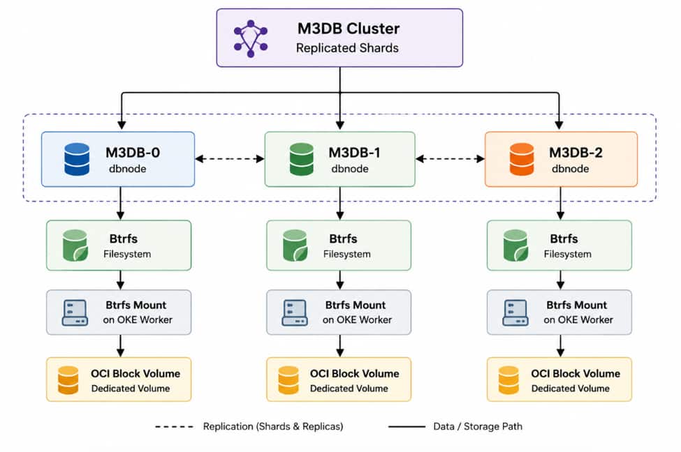

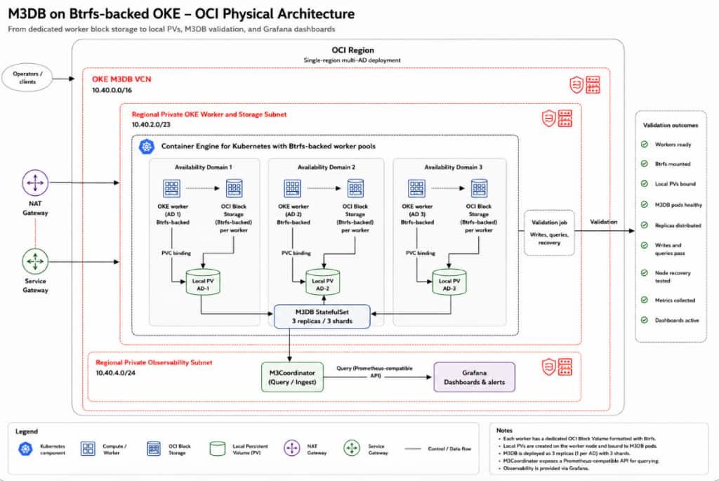

Architecture
The architecture combines three primary layers: storage, the M3DB application tier, and observability.
Each M3DB storage worker uses a dedicated OCI Block Volume formatted with Btrfs. Kubernetes exposes the worker-local storage to M3DB through Local PersistentVolumes and PersistentVolumeClaims.
M3DB dbnodes form the persistent database tier, while M3Coordinator provides the interface for writing and querying time-series data. M3DB replication distributes data across the participating dbnodes.
Grafana provides the visualization layer and queries M3Coordinator through its Prometheus-compatible API. A separate Prometheus Server was not deployed in the validated environment.
Figure 1. Validated architecture showing dedicated Btrfs-backed OCI Block Volumes on OKE workers, Kubernetes local persistent storage, the replicated M3DB tier, and Grafana-based observability.
Validated Environment
The validation environment used an OKE cluster created using the Quick Create workflow and configured as an enhanced VCN-native cluster using the OCI VCN-Native CNI.
The Btrfs-backed M3DB storage workers used E6.Ax compute shapes with dedicated OCI Block Volumes. Karpenter was used for dynamic node provisioning, with E6.Flex or E6.Ax configured as eligible shapes based on workload requirements and capacity availability.
These compute, networking, and cluster choices reflect the validation environment and are not requirements for every deployment. Production implementations should be adapted to the availability, networking, security, storage, and performance requirements of the target OCI environment.

The validated configuration used three M3DB dbnodes distributed across three Btrfs-backed OKE workers.
M3DB container → PVC → Local PV → Btrfs → OCI Block Volume
M3Coordinator provides the write and query interface, while the M3DB dbnodes form the persistent database tier.

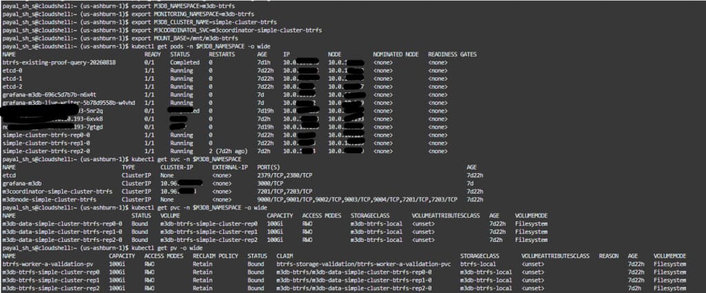

Before generating workload, verify the M3DB deployment itself.
Start with Kubernetes:
kubectl get pods -n <M3DB_NAMESPACE> -o wide
kubectl get pvc -n <M3DB_NAMESPACE>
kubectl get pv
Confirm that:
- all expected M3DB pods are Running and Ready
- each dbnode is scheduled onto the intended worker
- each PVC is Bound
- each Local PersistentVolume is associated with the expected worker
- M3Coordinator is reachable
- M3DB placement is initialized
- the expected shards are available
This establishes the baseline before data is written.

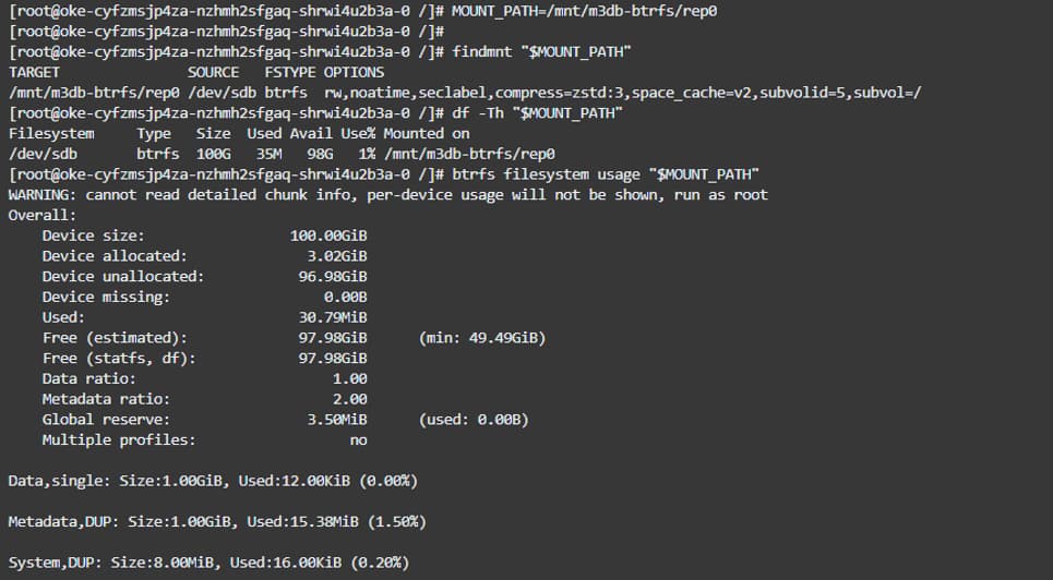

Proving Data Reaches Btrfs
Application success does not by itself prove that M3DB is using the intended storage. On each dbnode worker, verify the Btrfs mount:
findmnt <MOUNT_PATH>
df -Th <MOUNT_PATH>
btrfs filesystem usage <MOUNT_PATH>
Compare filesystem usage before and after ingestion to confirm that the M3DB workload is consuming the intended Btrfs-backed storage.

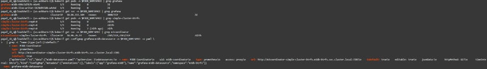

Verify Grafana:
kubectl get pods -n <M3DB_NAMESPACE> | grep grafana
kubectl get svc -n <M3DB_NAMESPACE> | grep grafana
The Grafana data source points to M3Coordinator on port 7201.

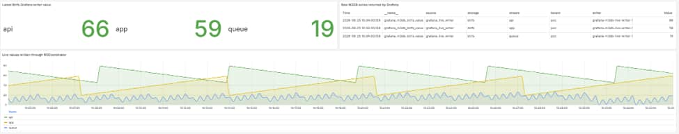

Grafana Dashboard Validation
Grafana dashboards were used to confirm that metrics written through M3Coordinator could be queried and visualized.
Access Grafana locally:
kubectl -n <M3DB_NAMESPACE> port-forward svc/grafana-m3db 3000:3000
Open http://127.0.0.1:3000 and verify that the dashboard displays the M3DB workload metrics.
