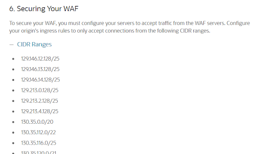

Before you implement a web application firewall (WAF) in Oracle Cloud Infrastructure (OCI), you need to configure your web server to accept traffic from the WAF servers. The WAF documentation gives a list of CIDR range that you need to add into your security list.
A screenshot of the Securing your WAF section in the documentation with CIDR ranges.
So, how can you add all these entries to your security list manually?

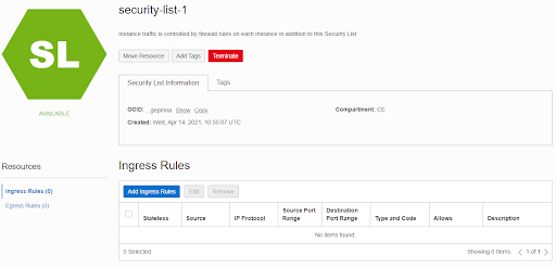

First, create a security list. It has no rules by default.
A screenshot of a new security list created in the OCI Console.

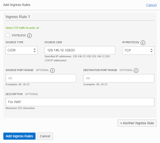

To add an ingress rule into the security list, click Add Ingress Rules.
A screenshot of the Add Ingress Rules page with detail fields filled out.
To add a list of WAF IP ranges, you can repeat this step multiple times.

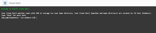

  1. Launch Cloud Shell. If the OCI CLI is installed and configured to connect to your tenancy, you can use any Linux instance.
    A screenshot of Oracle Cloud Shell.

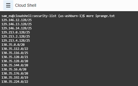

  2. Prepare a list of IP address in a text file. You can copy the CIDR ranges from the documentation.
    A screenshot of the selected CIDR ranges in Cloud Shell.

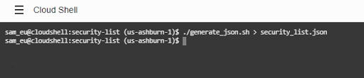

  4. To generate a json file to update your security list with all the entries from WAF nodes, run the generate_json.sh script.
    A screenshot of Cloud Shell creating the json file.

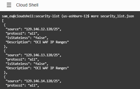

  5. Check the contents of the json file.
    A screenshot of the json file in Cloud Shell.

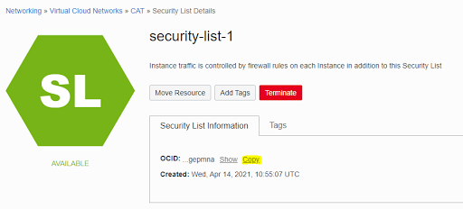

  6. Get the OCID of the security list that you created.
    A screenshot of the Security List Details page with the Copy button for the OCID highlighted in yellow.
