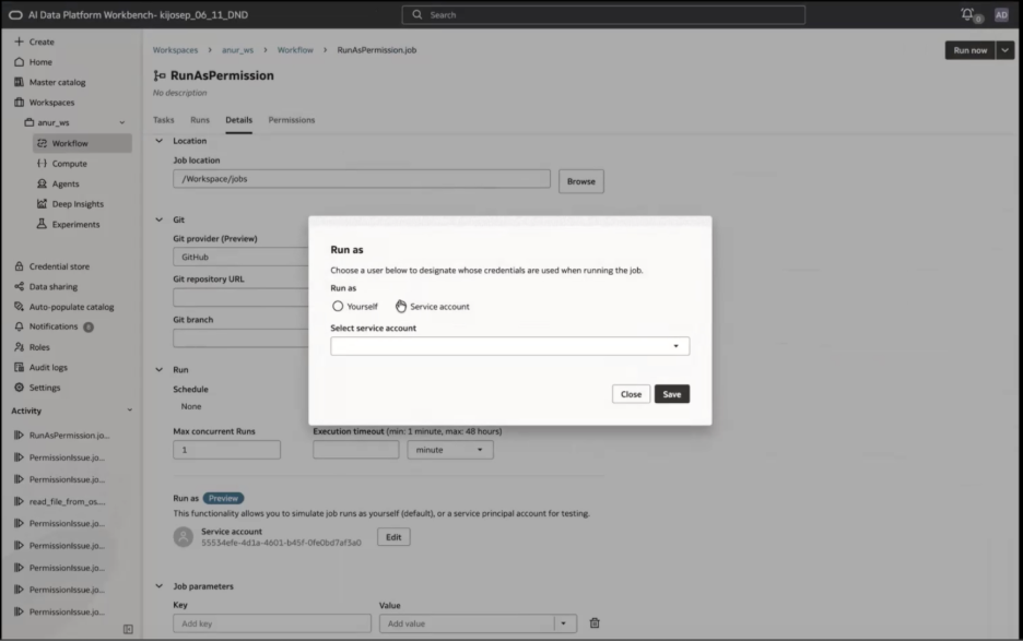

Run as your user identity is the default and is the natural fit while you’re building, testing, and iterating. At run time, AI Data Platform looks for a matching entry in your Credential Store; if one exists, the job uses it independent of your current browser session. If you don’t have a stored credential, AI Data Platform falls back to your IAM identity which is fine for a manual run, but that fallback is exactly what breaks on a schedule, since there’s no session for the scheduler to fall back on.
Run as a service account replaces your personal identity with a governed, non-person identity meant to outlive any one person’s session. AI Data Platform resolves the service account’s own stored credential on every run, so the job’s authentication no longer depends on who built it, whether they’re still on the team, or whether they’re logged in. Figure 1 shows the Run As section on a job’s Details tab, where the current execution identity here, a service account is set and can be changed. A service account only appears as a selectable option to users who already have permission to use its credential.  When a job set to Run As a service account fires, it authenticates using that service account’s credential and the run shows up on the Runs tab with the service account listed as the identity that executed it, so you can always confirm after the fact which identity a given run actually used.

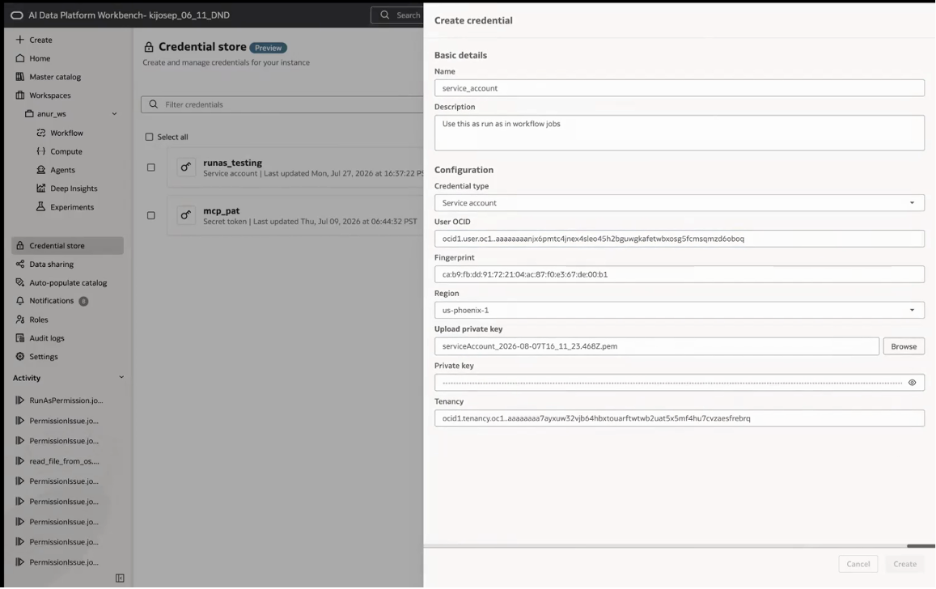

Run As is only as good as the credential behind it, and that credential lives in Credential Store. Credential Store supports a few credential types, including a secret token and a Service account type built specifically for this use case. A service account credential captures the pieces needed to authenticate independent of any session: the service account’s user OCID, its API key fingerprint, the private key itself, the tenancy OCID, and the region.
Figure 2 – A Service account credential in Credential Store
This is the detail worth calling out: simply pointing Run As at a different identity does nothing on its own. Run As only resolves a credential that already exists for that identity in Credential Store. If the selected user or service account has no stored entry in the credential store or if it gets deleted then the job has nothing to authenticate with, scheduled or not.

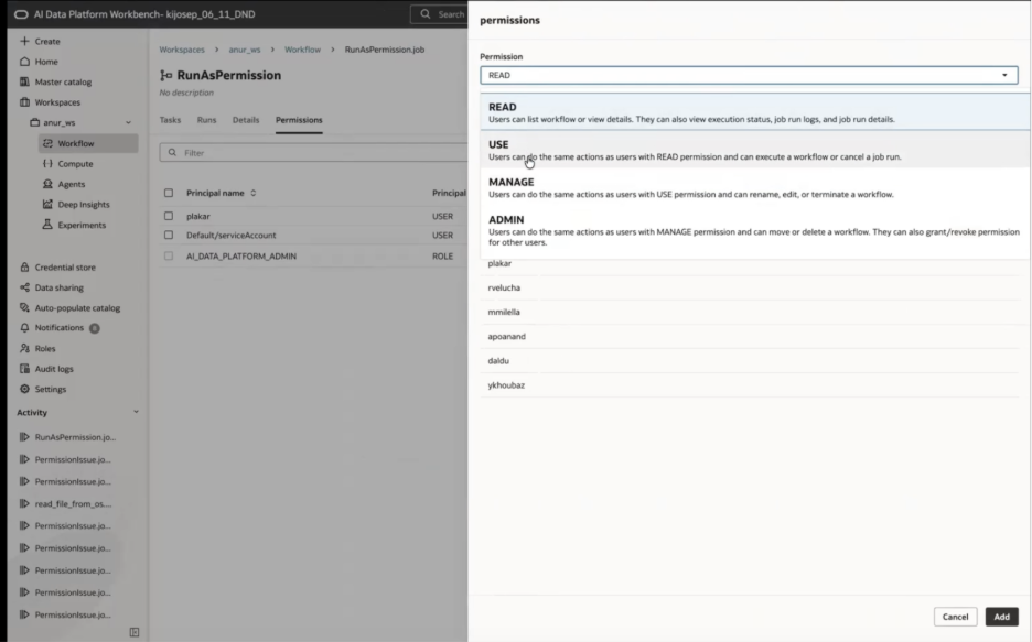

Run As doesn’t hand out blanket access. AI Data Platform applies a similar four-tier permission model – READ, USE, MANAGE, ADMIN to credentials, and other resources within a workspace. Read this blog for more information.
Figure 3 – Permission levels in AI Data Platform: READ, USE, MANAGE, and ADMIN, shown here on a workflow’s Permissions tab.
Turning on a service account for a scheduled job means granting access twice, to two different principals and this is the part that’s easy to miss. First, whoever configures the job needs permission to select the service account in the first place. Second, the service account itself becomes a principal the moment it’s chosen as Run As, and it needs its own access to execute i.e. it isn’t borrowing the job owner’s access, it’s using its own. To simply put,
  • To let someone configure a job with a service account, a USE permission on the service account’s entry in Credential Store is required.
  • For the service account to run the job once selected, a Service account needs explicit permissions on the resources it is trying to access, including its own credentials in Credential store.
That second grant is why a job’s Permissions tab in Figure 3 typically lists the service account as an entry, alongside any human collaborators, rather than inheriting whatever access the job’s owner happens to have.
This layered model is what keeps Run As from becoming an impersonation shortcut which means a service account is only ever available to people who’ve been explicitly granted the right to use it, and a service account needs explicit permissions at every layer it touches.

  1. Register it in Credential Store as a Service account credential, using the OCID, fingerprint, private key, and tenancy captured in step 1.
