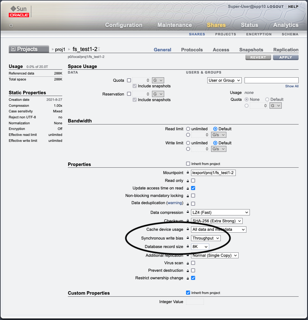

The property is set in the Share Properties just above database recordsize. You might need to unset the Inherit from projet checkbox in order to modify the settings on a particular share:
