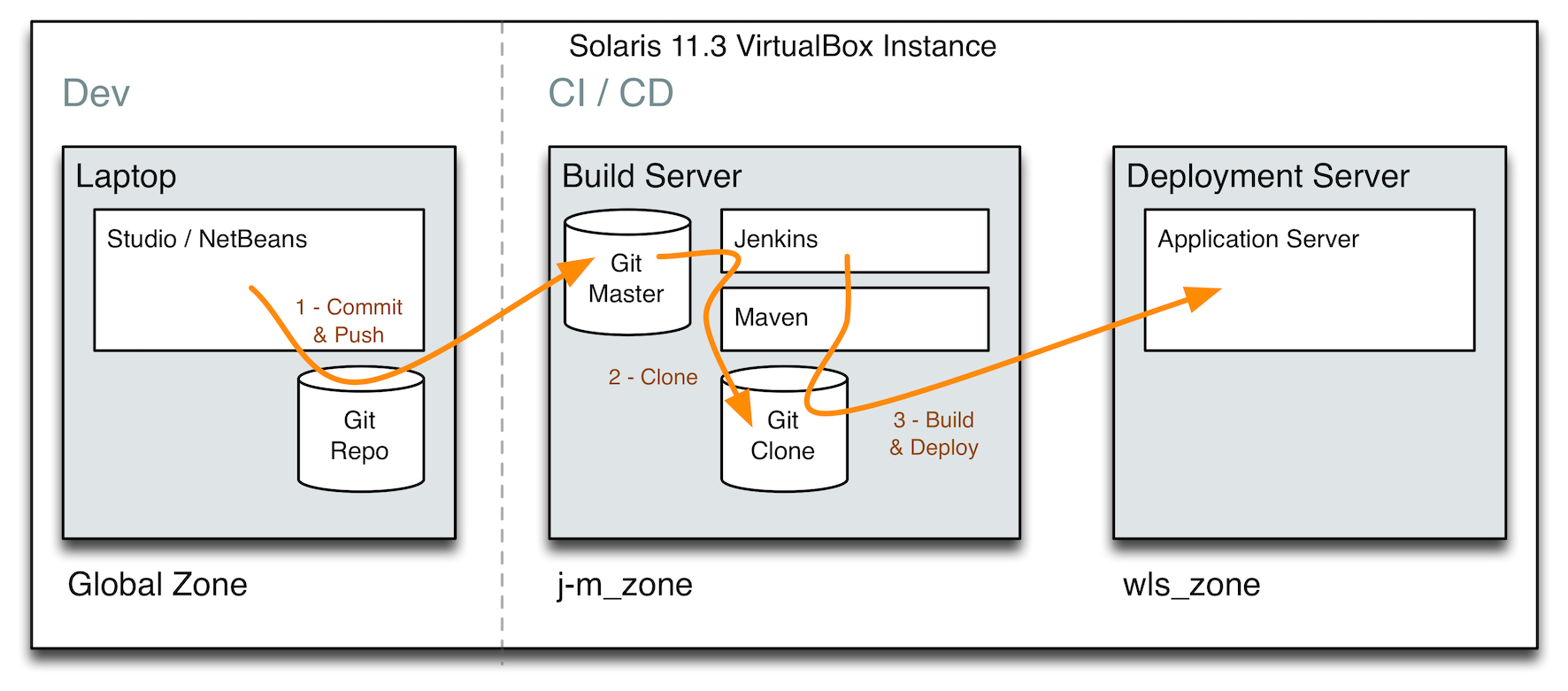

As one of the Hands on Lab sessions at Oracle OpenWorld this year participants ran through the install of a simple DevOps toolchain, where at the end they had a fully functioning toolchain from Netbeans with a Git repository, through Jenkins and Maven, the automatically deployed their sample application onto a WebLogic instance every time they committed and pushed a change to Git. It looked like this:
Because the session at two hours was pretty long I’ve decided to split the Hands on Lab out over several blog posts. Also because the VirtualBox image with Oracle Solaris 11.3 in it had a bunch of things it that were prebuilt to save time. In these blog posts we’ll walk through the full install.
This blog post will cover the first step they made: Installing and configuring Oracle WebLogic Server inside a Solaris Zone.

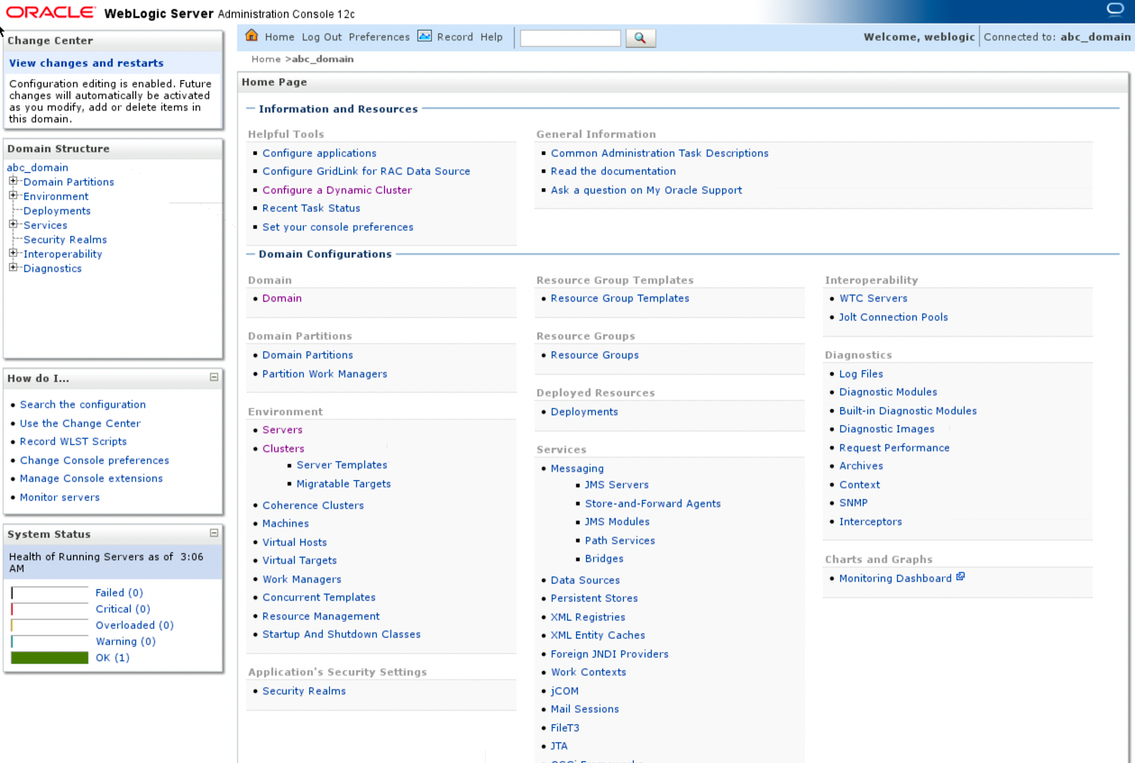

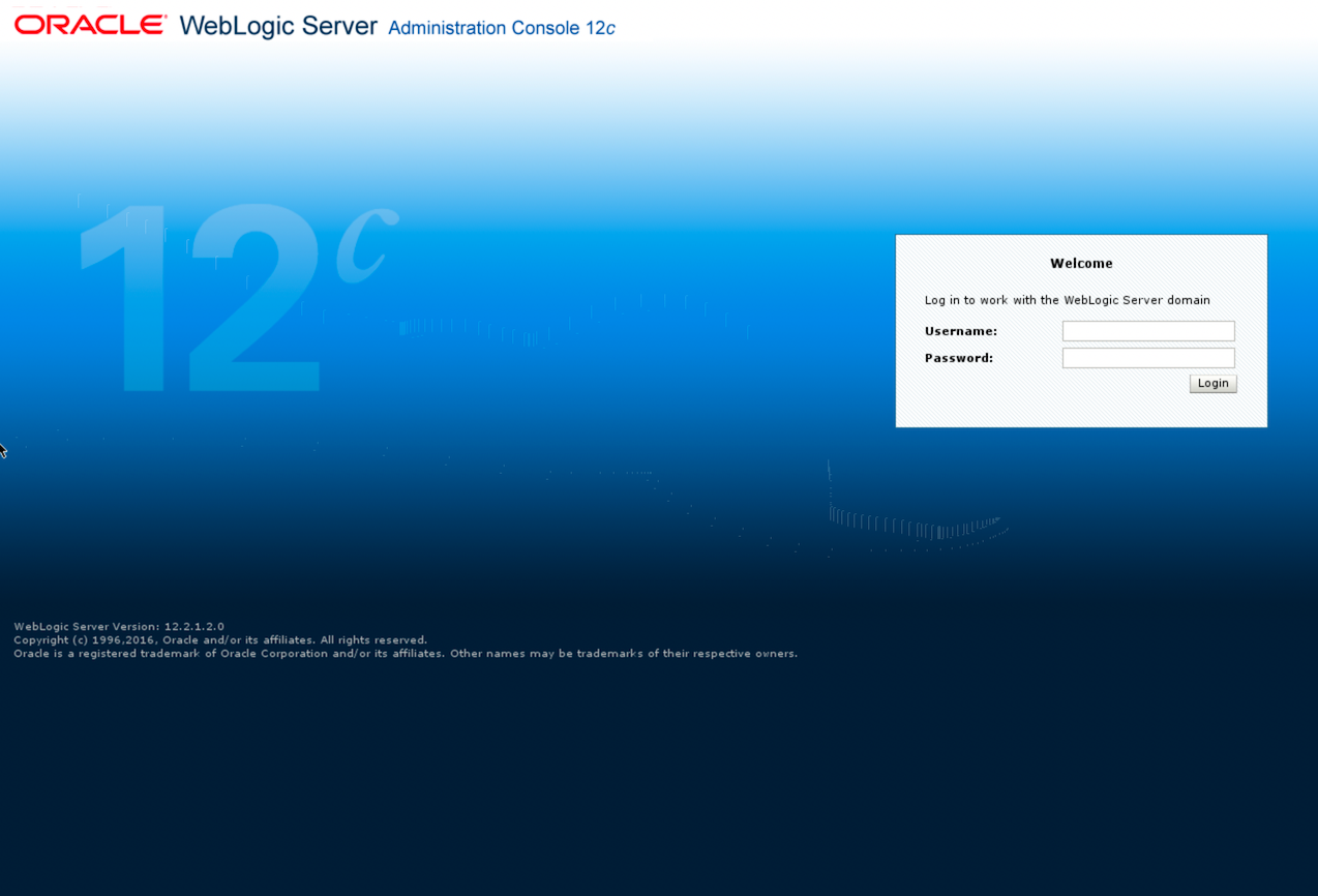

At this point the new domain is up and running and we can check if we can log in as the administrator through the BUI. For this you’ll need to find the IP Address of the wls_zone, this can easily be done by running ipadm inside the zone. If you’re root in the Global Zone you can use zlogin to run it directly in the context of the zone:
root@solaris:~# zlogin wls_zone ipadm
NAME              CLASS/TYPE STATE        UNDER      ADDR
lo0               loopback   ok           --         --
   lo0/v4         static     ok           --         127.0.0.1/8
   lo0/v6         static     ok           --         ::1/128
net0              ip         ok           --         --
   net0/v4        dhcp       ok           --         10.0.2.16/24
   net0/v6        addrconf   ok           --         fe80::8:20ff:fe35:d14/10
To do this start Firefox in Global Zone and point it to http://<wls_zone-IP_address> :7001/console to point it to port 7001 of the wls_zone. Then use weblogic and welcome1 to login:
Which should give you the WebLogic Server admin home page:
At this point the WebLogic Server instance is up and running. Of course you can have a look as the createAndStartEmptyDomain.sh script and alter it to fit your needs. At this point all the regular WebLogic commands will work in the ways you’d expect them to.
