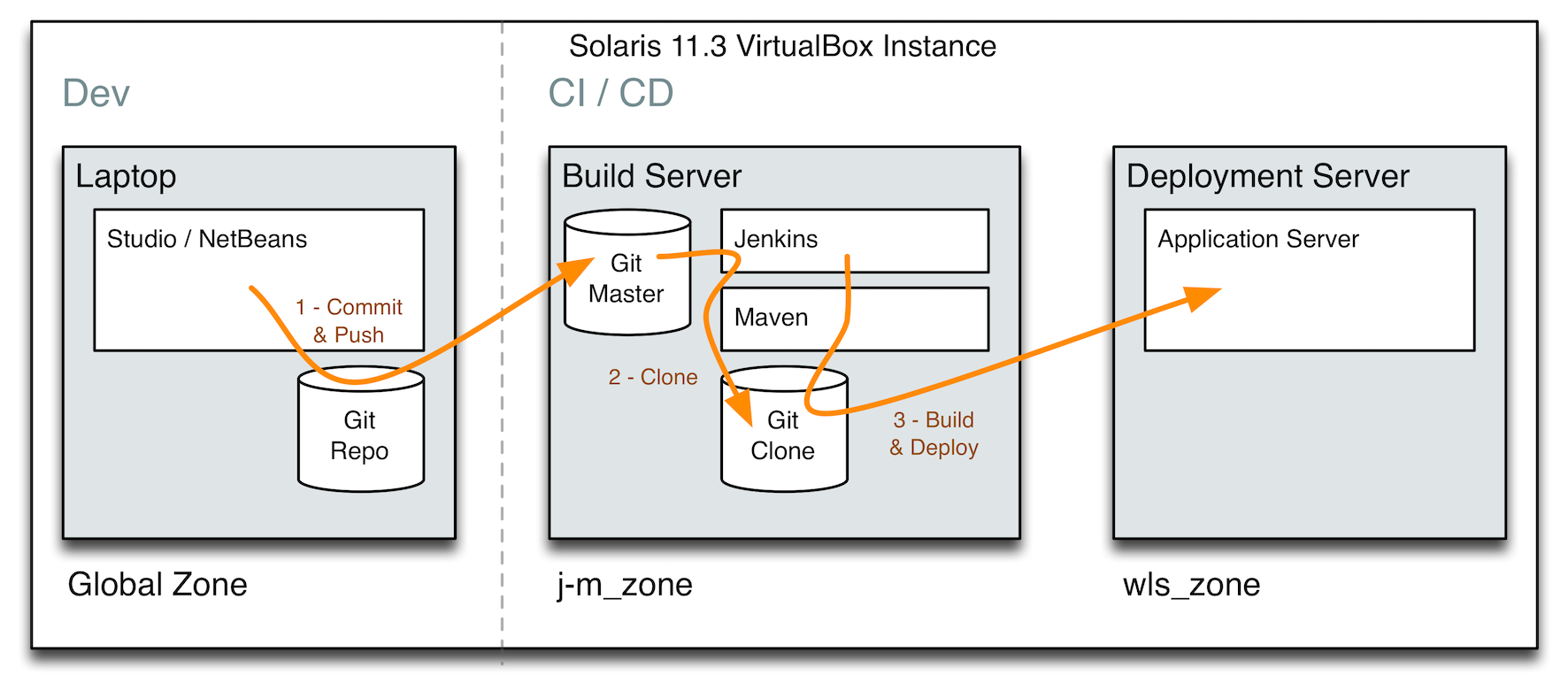

Continuing on from last week’s DevOps toolchain Part 1 blog. This is Part 2 on how to set up a simple DevOps toolchain on Oracle Solaris with tools like Jenkins, Maven, Git, and WebLogic Server. This is based on a Hands on Lab we did at Oracle OpenWorld this year and the toolchain at the end  of the Hands on Lab basically looks like this:
In this second part we’ll be installing Maven and creating and loading the Oracle Maven Plugins for Oracle WebLogic Server.
To achieve this we’ll first install the second Solaris Zone called j-m_zone and then install Java, Git, and Maven. At this point we can create/build the Oracle Maven Plugins for Oracle WebLogic Server with the WebLogic install in the wls_zone, pull them across and then use them to create, upload, and test a WebLogic demo application.
The basic assumption is that you’re continuing on working in the same environment as with Part 1, because we’ll need the WebLogic install to be there to create the plugins and later connect to.
1. Installing the Jenkins-Maven Zone
This procedure is very similar to the earlier install of the wls_zone so we’ll only do the abbreviated version here.

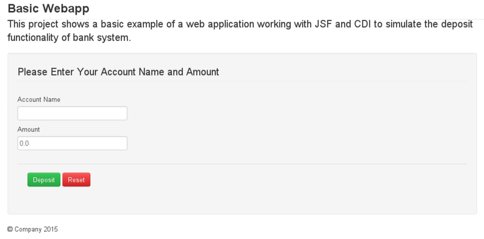

Now to test if the web app is up and running go to http://<wls_zone>:7001/basicWebapp in Firefox and you should see something like this:
At this point Maven has been set up to be able to connect to the WebLogic instance and control it. In this case we’ve done a simple build and deploy by using the pre-integration-test goal but there are many other goals you can use, even to create new WebLogic domains and starting and stopping them. For more information check out the Oracle documentation on the different types of goals.
