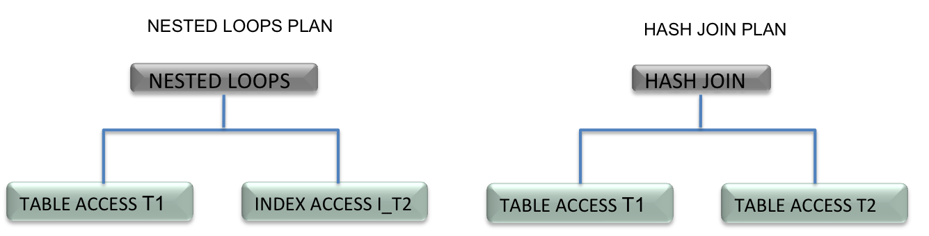

An adaptive plan allows certain decisions in a plan to be postponed until runtime, in case runtime conditions different from optimizer assumptions. For the purposes of explaining concepts, we will consider a plan for a simple two table join, where the join method is adapted. The diagram below shows the two options for this plan.
An adaptive plan consists of a default plan, which is the plan that the optimizer picks based on the current statistics, as well as alternatives to various portions of the plan. In our example join, let’s assume the default is the nested loops plan, and the alternative is the hash join. Each alternative portion of a plan is referred to as a “subplan”. A subplan is a set of related operations in a plan. For instance, the nested loops operation and the index scan consist of one subplan; the alternative subplan consists of the hash join node and the table scan on the right of it.For each decision that can be adapted, the plan contains two or more alternative subplans. During execution, one of those alternatives is chosen to be used, in a process called “adaptive plan resolution”. Adaptive plan resolution occurs on the first execution of a plan; once the plan is resolved, future executions of the same child cursor will use the same plan.

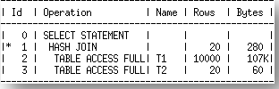

When EXPLAIN PLAN generates a query plan, none of the adaptive subplans have been resolved, so we see the default plan when displaying the plan through DBMS_XPLAN.DISPLAY. For example, if the optimizer thinks that nested loops join plan is best, then EXPLAIN PLAN and DBMS_XPLAN.DISPLAY would display the nested loops join plan as shown below.
During execution, suppose that the plan resolves to a hash join instead. Then the plan displayed by DBMS_XPLAN.DISPLAY_CURSOR would show the final plan, containing the hash join with full table scan on the right.
