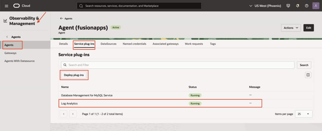

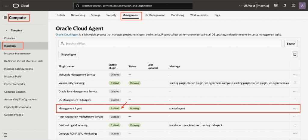

On the Compute instance, enable the Management Agent plugin through Oracle Cloud Agent. Ensure the Log Analytics plugin is deployed as part of the installation.
You should see the Management Agent in an Active state in the OCI Console before continuing.
Enable the Management Agent plugin on the OCI Compute instance
Verify that the Management Agent is active and the Log Analytics plug-in is running

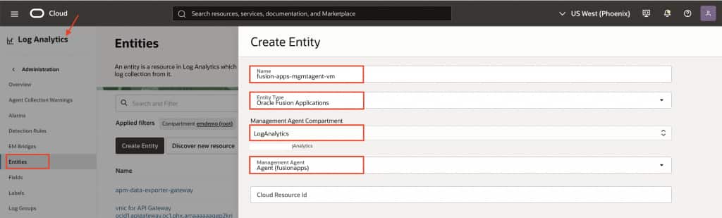

3. Create an Oracle Fusion Applications entity
In the OCI Console, go to Observability & Management > Log Analytics > Administration > Entities.
Create an entity with the following configuration:
FieldValue
Entity typeOracle Fusion Applications
Management AgentThe Management Agent installed on the Compute instance
login_urlFusion Applications login URL
pod_urlFusion Applications pod base URL
proxy_urlOptional proxy URL, if required
Source typeREST API
Select the same Management Agent where you registered the FA-CREDS credential. The agent uses this credential when it calls the Fusion REST API endpoints.
Use a meaningful entity name, such as fusion-apps-mgmtagent-vm or fusion-prod, so the environment is easy to identify in Log Explorer and dashboards.

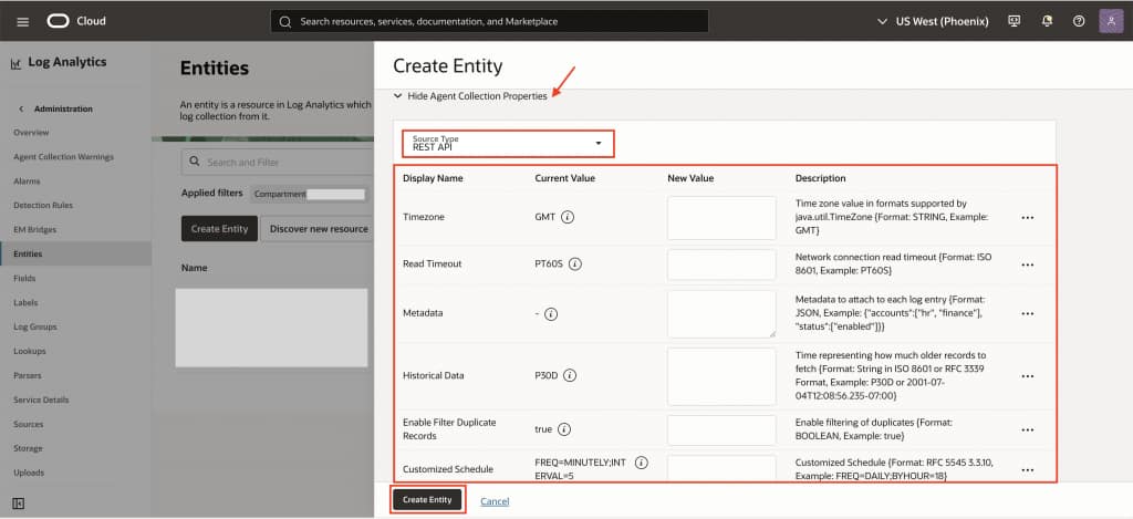

In the entity’s agent collection properties, configure the REST API collection schedule, historical-data collection, and duplicate-record filtering based on your operational requirements.

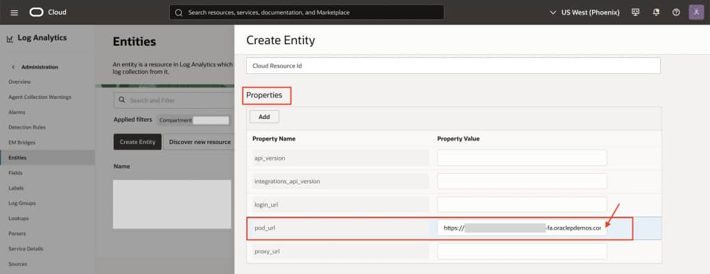

Create an Oracle Fusion Applications entity and select the Management Agent
Configure the Fusion login_url, pod_url, and optional proxy_url entity properties
Configure REST API agent collection properties for the Fusion entity

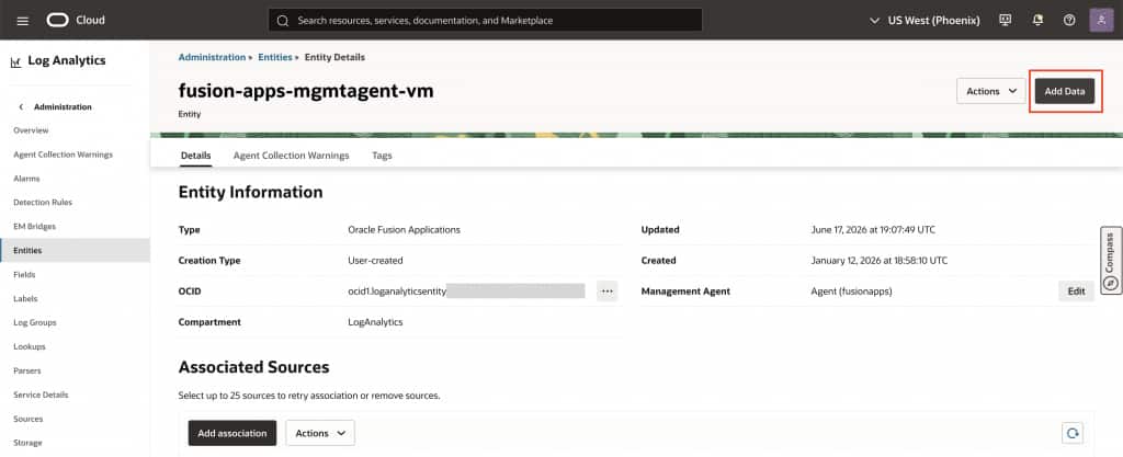

4. Associate Oracle-defined Fusion sources

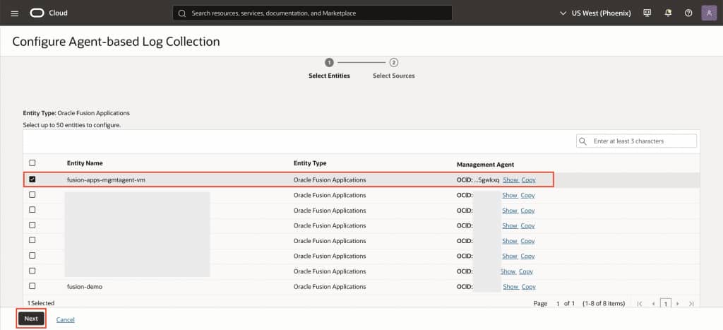

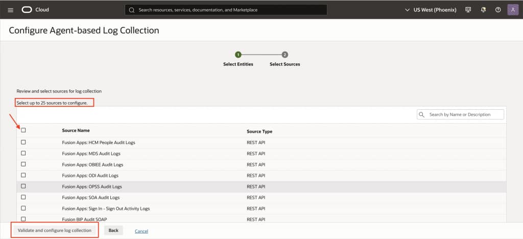

On the entity details page, select Add Data and search for Fusion Apps: Select the Oracle-defined sources that support your use cases, choose a log group, and validate the configuration before starting collection.
Start with the sources most relevant to your immediate needs:
Use caseOracle-defined source
ESS job requests, status, and performanceFusion Apps: Enterprise Scheduler Service Request Logs
HCM business-object auditFusion Apps: HCM People Audit Logs or Fusion Apps: HCM Payroll Audit Logs
Metadata and customization auditFusion Apps: MDS Audit Logs
Role, policy, and permission auditFusion Apps: OPSS Audit Logs
Fusion workflow and service-oriented process activityFusion Apps: SOA Audit Logs
When prompted for a REST API credential, select FA-CREDS. Validation should complete successfully before you configure the association.

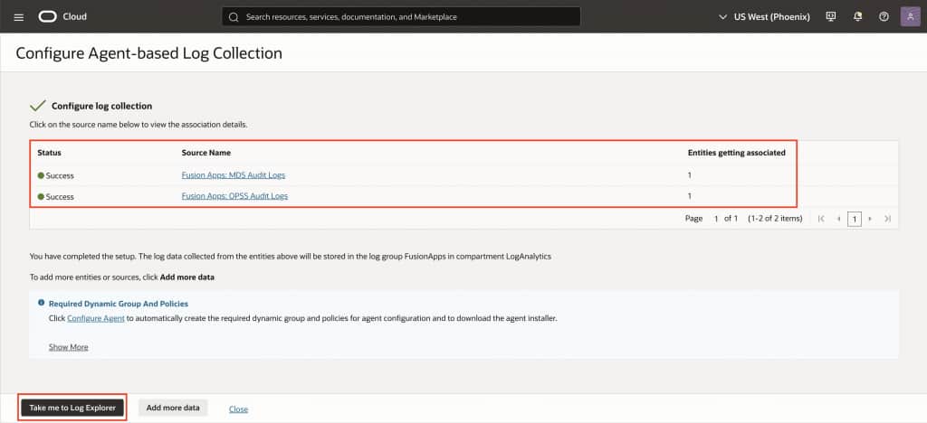

After validation succeeds, configure the association. The Management Agent begins collecting data from the selected Fusion REST API sources.
Start agent-based log collection by selecting Add Data for the Fusion entity
Select the Oracle Fusion Applications entity for log collection
Select Oracle-defined Fusion log sources and validate the log-collection configuration
Confirm successful source association and open Log Explorer

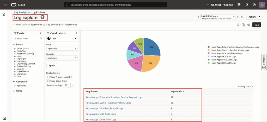

5. Verify data in Log Explorer
After collection starts, go to Observability & Management > Log Analytics > Log Explorer.
Set a recent time range and run a query similar to this:
'Log Source' in (
  'Fusion Apps: Enterprise Scheduler Service Request Logs',
  'Fusion Apps: OPSS Audit Logs',
  'Fusion Apps: MDS Audit Logs',
  'Fusion Apps: SOA Audit Logs'
| stats count as logrecords by 'Log Source'
| sort -logrecords
If the query returns records, collection is working. You can then open the appropriate Oracle-defined dashboard, select the compartment and time range, and begin investigating the data.
For example, open Fusion ESS Request Logs Analysis after ESS records arrive, or Oracle Fusion Apps: OPSS Audit after OPSS audit records are collected.
Verify that Fusion log records are arriving in Log Explorer
A successful result returns one or more log-record counts by log source. If the result is empty, continue to the troubleshooting section.

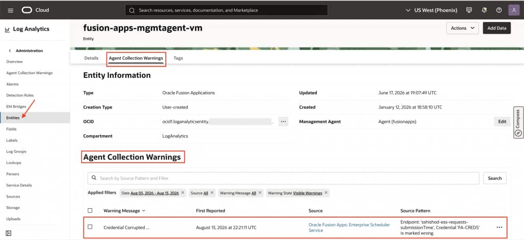

Troubleshooting:
If data does not appear in Log Explorer, check the following:
  • The Management Agent is active.
  • The Compute instance can reach the Fusion Applications endpoint.
  • The entity contains the correct login_url and pod_url.
  • The credential name in the source configuration matches the credential registered with the agent.
  • The Fusion-side API roles and privileges were configured as described in Part 1.
  • The OCI IAM policies allow the Management Agent to upload log records.
  • The source-entity association completed successfully.
  • The selected time range includes the collection period.
Review Agent Collection Warnings when log collection does not succeed
