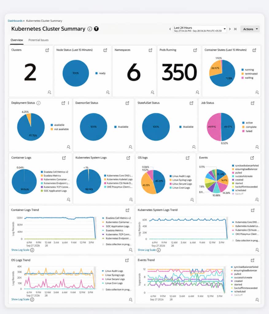

Understand the Environment with Cluster Summary-Overview
Kubernetes Clusters Overview dashboard
Kubernetes Clusters Summary-Overview dashboard
The Overview tab provides a cluster-wide operational summary. It combines:
  • Cluster, namespace, and running-pod counts
  • Recent node and container states
  • Deployment, DaemonSet, StatefulSet, and Job status
  • Container, Kubernetes system, OS, and event-log distribution
  • Historical log and event trends
Use it when the scope of a change or incident is unclear. It can show whether increased activity is confined to application containers or accompanied by Kubernetes system, OS, or event signals. To refine your view, use the Scope Filter to select the exact cluster for which you want to view the summary and potential issues.

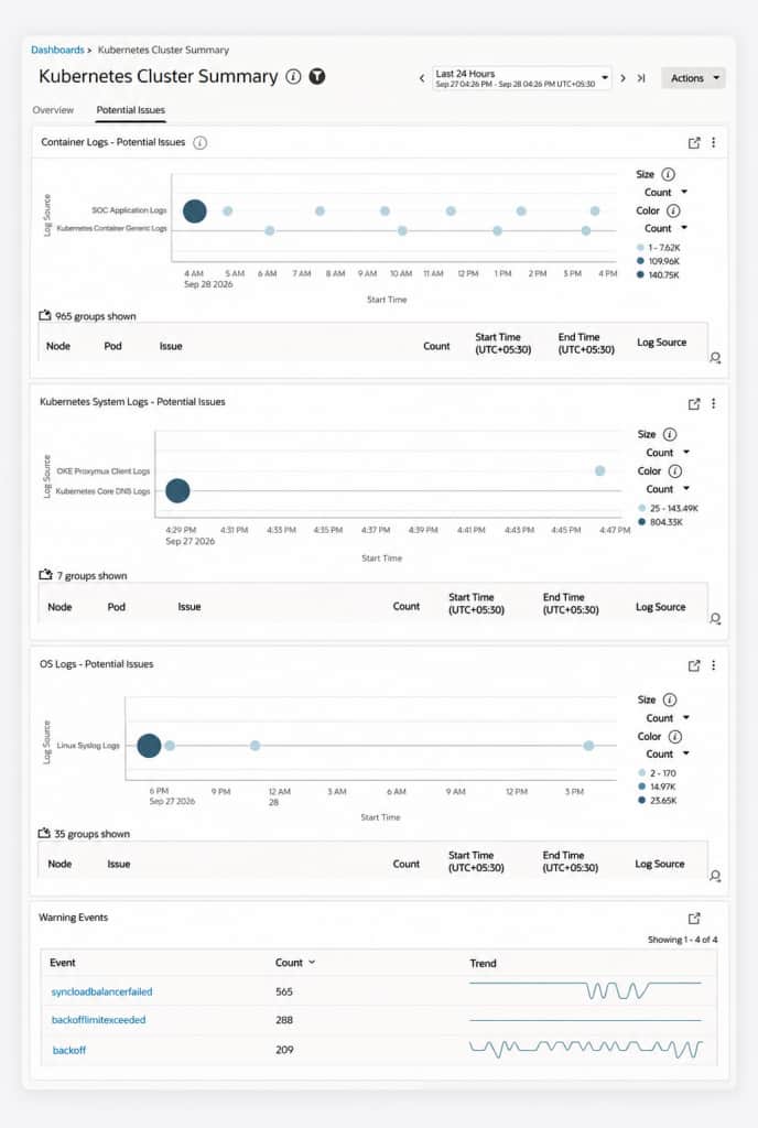

Prioritize Signals with Cluster Summary-Potential Issues
Kubernetes Clusters Summary Potential Issues
Kubernetes Clusters Summary- Potential Issues dashboard
The Potential Issues tab highlights suspicious activity across:
  • Container logs
  • Kubernetes system logs
  • OS logs
  • Kubernetes warning events
Its visualizations show when potential issues occurred, their frequency, and the originating log sources. Tables add affected nodes or pods, issue samples, occurrence counts, and start and end times. To refine your view, use the Scope Filter to select the exact cluster for which you want to view the summary and potential issues.
Example scenarios
  • Payments: Intermittent failures, cross-layer correlation
  • Telecommunications: Recurring versus isolated signals
  • Web applications: Repeated error patterns
  • Shared platforms: Common node or pod causes

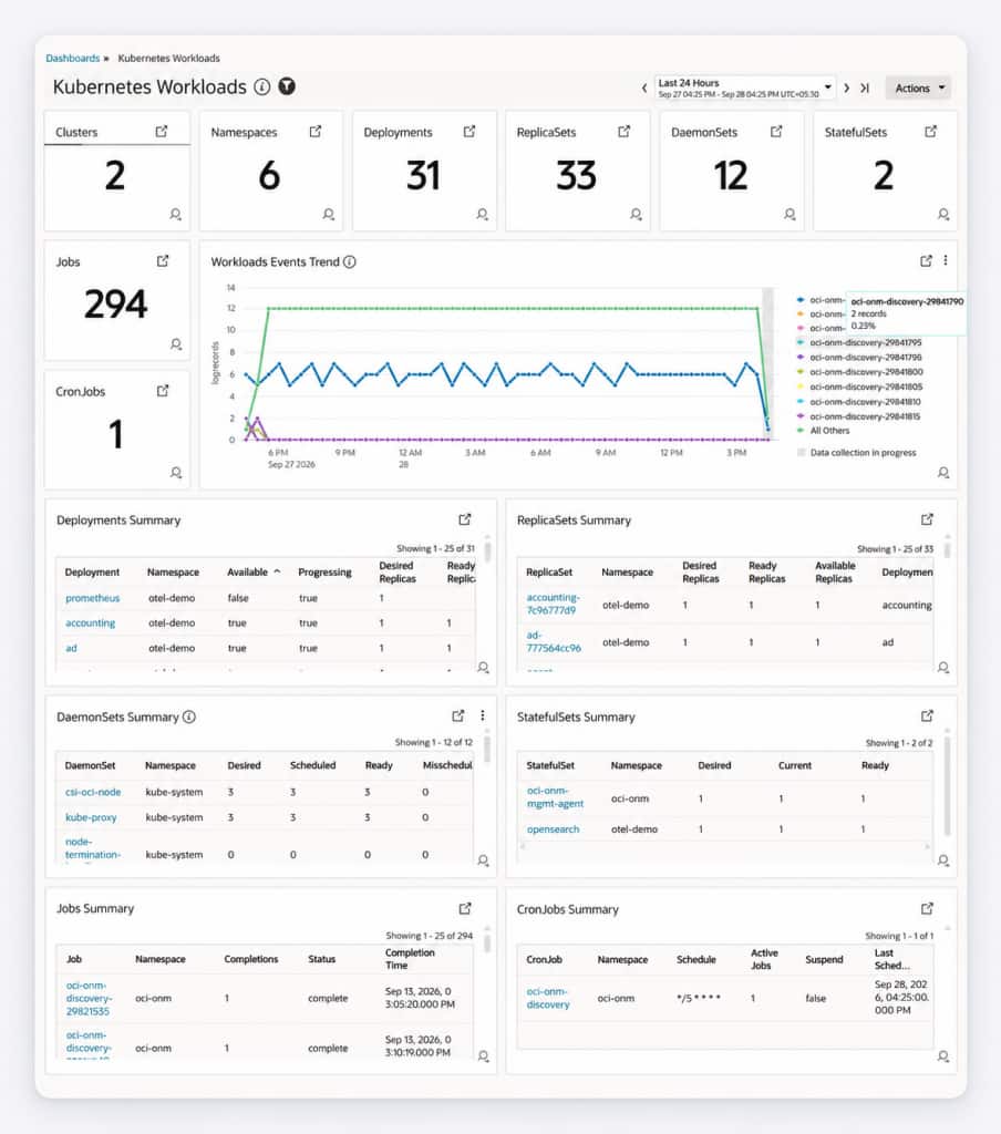

Validate Application State with Kubernetes Workloads
Kubernetes Workloads dashboard
The Kubernetes Workloads dashboard covers Deployments, ReplicaSets, DaemonSets, StatefulSets, Jobs, and CronJobs. It combines resource counts, an events trend, and summaries of desired, scheduled, ready, available, or completed states. To refine your view, use the Scope Filter to select the exact cluster and namespace for which you want to view the workload details.
Typical questions include:
  • Did a rollout reach its desired replica count?
  • Are all expected StatefulSet instances ready?
  • Are DaemonSets scheduled across the required nodes?
  • Did a Job complete?
  • Is a CronJob active, suspended, or delayed?
Example scenarios
  • Web applications: Deployment and replica readiness
  • Stateful services: Current and ready instances
  • Platform services: DaemonSet coverage
  • Data pipelines: Job completion, CronJob schedules
  • CI/CD: Post-release workload events

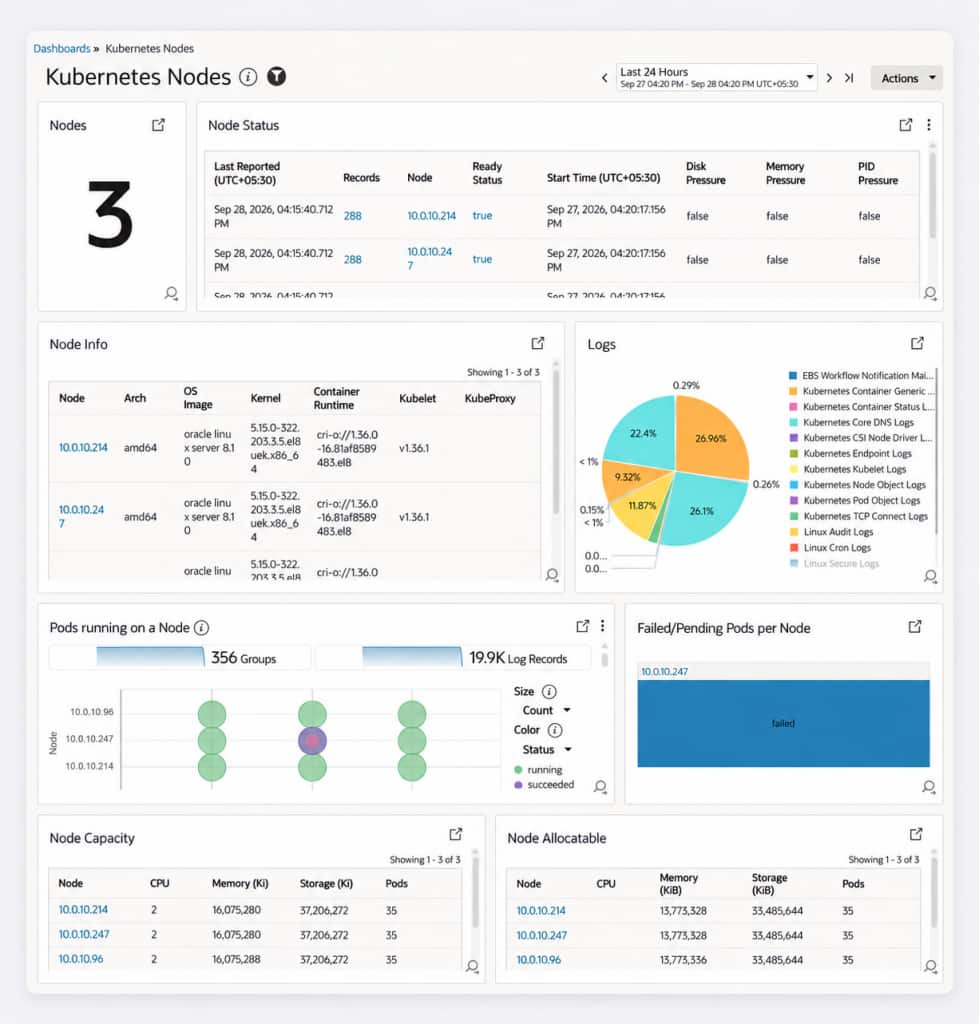

Investigate Infrastructure with Kubernetes Nodes
Kubernetes Nodes dashboard
The Kubernetes Nodes dashboard brings together node health, configuration, capacity, and workload placement. It includes:
  • Readiness and pressure conditions
  • OS, kernel, container runtime, kubelet, and kube-proxy information
  • Node-related log distribution
  • Pods running on each node
  • Failed or pending pods by node
  • Capacity and allocatable resources
Use it when pods from different applications fail on the same node, new pods cannot be scheduled, or node capacity may be affecting a workload. To refine your view, use the Scope Filter to select the exact cluster and worker nodes for which you want to view the details.
Example scenarios
  • Retail: Peak-readiness planning
  • AI and machine learning: Resource availability, workload concentration
  • Telecommunications and edge: Localized node conditions
  • Regulated environments: Software-version consistency
  • Shared platforms: Cross-application node failures

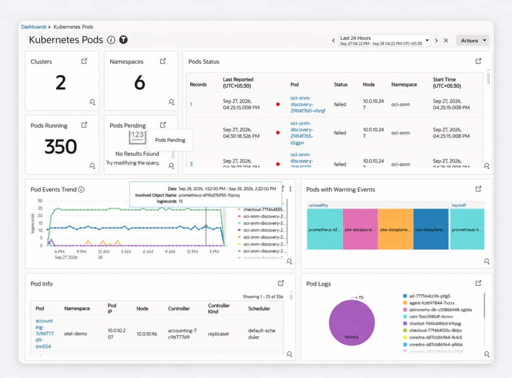

Examine Runtime Instances with Kubernetes Pods
Kubernetes Pods dashboard
The Kubernetes Pods dashboard provides the most granular view. It shows running and pending counts, individual pod status, warning events, event trends, scheduling information, controller relationships, and log distribution.
It can help teams:
  • Identify a failed replica
  • Distinguish pending from failed pods
  • Locate node-specific warnings
  • Find pods generating unusual log volumes
  • Trace a pod to its controller and workload
To refine your view, use the Scope Filter to select the exact cluster and namespace for which you want to view the pod details.
Example scenarios
  • Microservices: Individual replica failures
  • Media and streaming: Distributed pod warnings
  • Batch processing: Pending versus failed execution
  • Customer-facing services: Pod-specific error volume
  • Platform engineering: Scheduling and controller context
