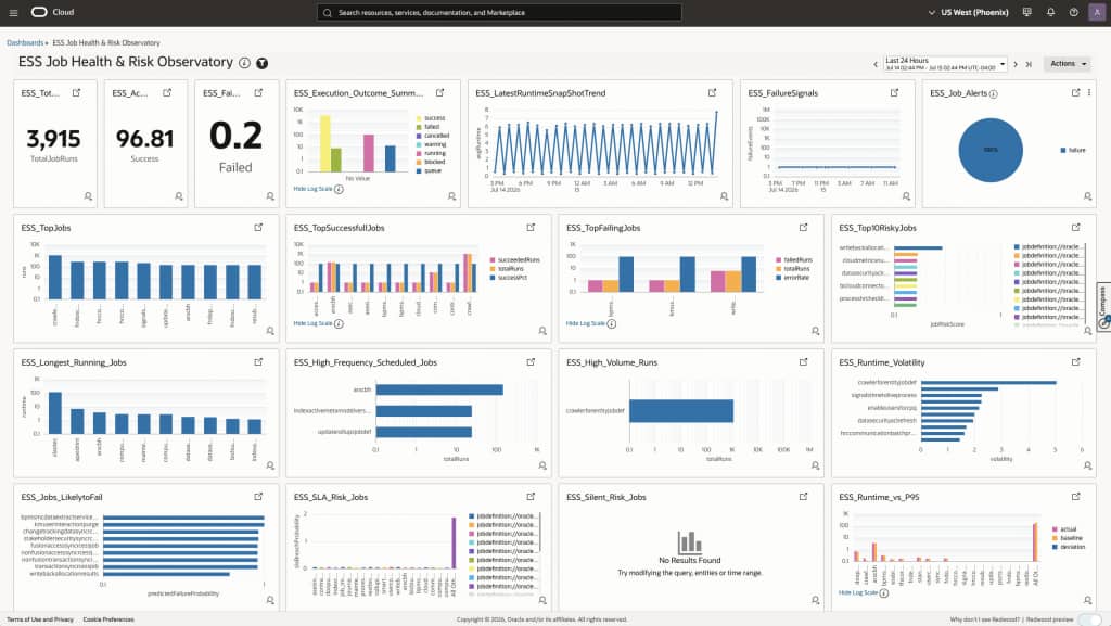

Get Operational Insights into Fusion Enterprise Scheduler Job Requests

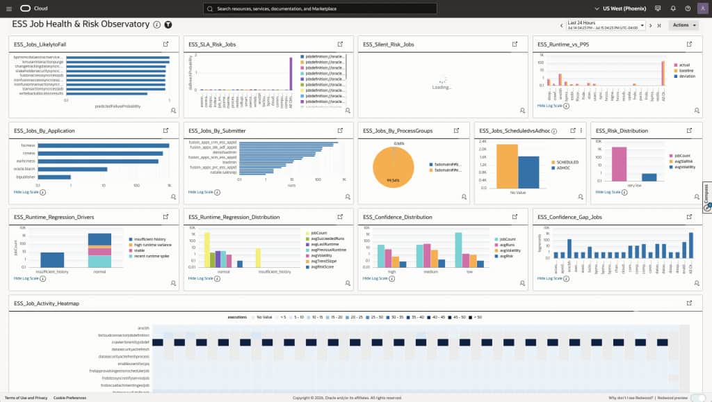

The immediate value of the new collection paradigm is the operational insight it provides into Fusion Enterprise Scheduler job requests. The ESS Job Health & Risk Observatory turns the collected ESS activity, performance baselines, and calculated health signals into a consolidated operational view.
Figure 2: ESS Job Health and Risk Observatory showing execution outcomes, success and failure rates, runtime behavior, and job risk
The dashboard helps Fusion Applications operations teams answer the questions they most frequently ask about ESS workload health:
  • Measure the ESS execution success rate. Understand the percentage of ESS executions that completed successfully during the selected period.
  • Track the ESS failure rate. Determine whether failures are isolated events or indicate a broader degradation in ESS workload health.
  • Find the top failing jobs. Rank jobs by failed executions and error rate so that the most persistent failures can be investigated first.
  • Detect high-volume runs. Find jobs with the greatest execution volume and determine whether unexpectedly frequent runs are contributing to system load.
  • Analyze runtime volatility. Identify jobs whose execution durations vary significantly and may therefore be difficult to predict or schedule reliably.
  • Identify long-running jobs. See which jobs have the longest runtimes, including the job name or definition and the observed runtime that requires investigation.
  • Find the applications with the most ESS activity. Understand which Fusion Applications generate the greatest ESS job volume and where operational attention may be concentrated.
Together, these dashboard views allow an operator to move from service-level health to workload patterns and then to the specific jobs that require attention. Success rate, failure rate, execution outcomes, and high-volume runs summarize activity within the selected reporting period. Long-running, runtime-volatility, regression, and risk views combine the latest job state with historical execution baselines.

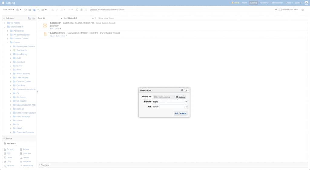

Open the BI Publisher catalog, navigate to /shared/Custom, and select Unarchive. In the Unarchive dialog, select the downloaded ESSHealth.catalog file, as shown in Figure 3.
Figure 3: Select ESSHealth.catalog in the BI Publisher Unarchive dialog
For this direct SOAP implementation, unarchive the catalog under /shared/Custom rather than the Human Capital Management folder. Verify that the operation creates /shared/Custom/ESSHealth and that the ESSHealth data model and ESSHealthRPT report are present.

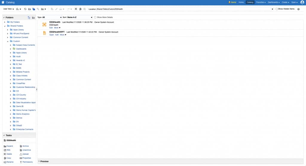

Figure 4: Verify the ESSHealth data model and ESSHealthRPT report under the imported catalog folder
The imported Log Analytics source calls this exact report path:
/Custom/ESSHealth/ESSHealthRPT.xdo
Run ESSHealthRPT in BI Publisher with a short period containing known ESS activity. Confirm that the report completes and returns job health records before continuing.

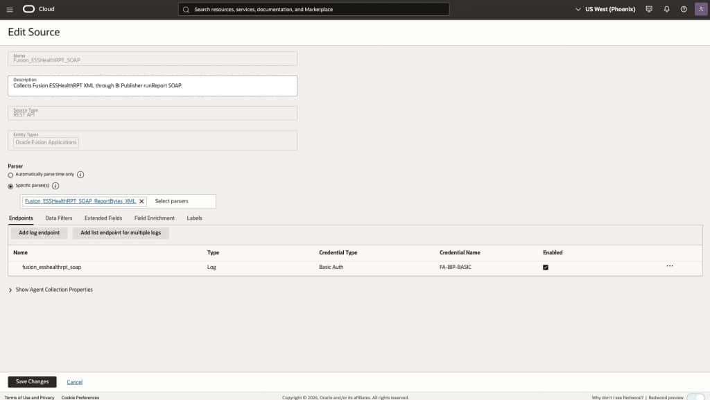

Step 7: Import the ESS Health SOAP source
In Log Analytics, navigate to:
Administration
  -> Administration Overview
  -> Import Configuration Content

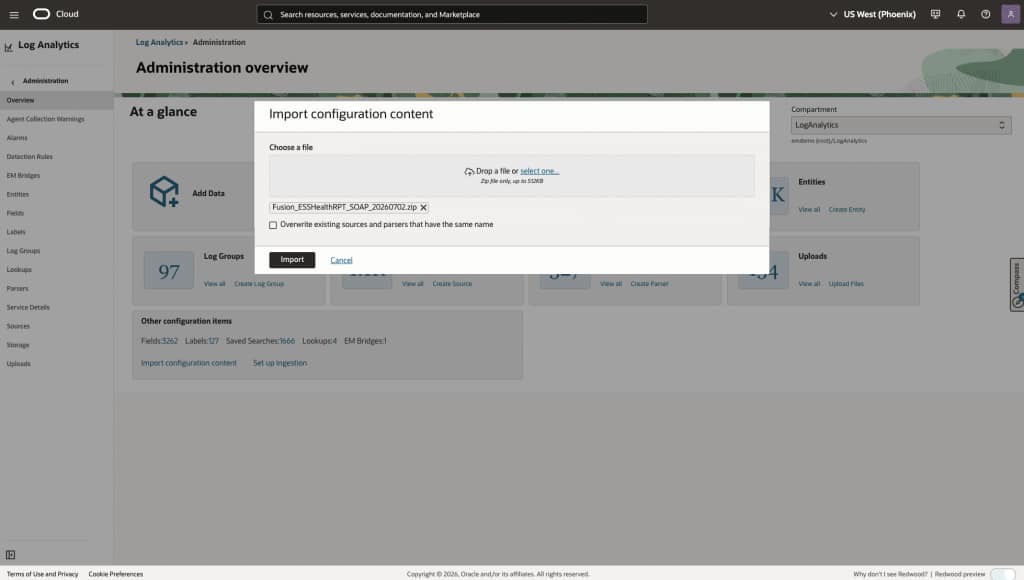

Download Fusion_ESSHealthRPT_SOAP_1784581422642.zip from GitHub and import the log source:
Figure 6: Select the Fusion ESS Health SOAP configuration package for import
After the import, verify these objects:
Source:         Fusion_ESSHealthRPT_SOAP
Wrapper parser: Fusion_ESSHealthRPT_SOAP_ReportBytes_XML
Decoded parser: Fusion_ESSHealthRPT_Decoded_XML
Open the imported source and confirm these settings. The endpoint resolves pod_url from the associated Fusion Applications entity, so the package does not contain a tenant-specific Fusion hostname.
Source type:          REST API
Entity type:          Oracle Fusion Applications
Endpoint name:        fusion_esshealthrpt_soap
Method:               POST
Endpoint URL:         https://{pod_url}/xmlpserver/services/v2/ReportService
Request content type: application/xml
Response content type: application/xml
Credential:           FA-BIP-BASIC
Report path:          /Custom/ESSHealth/ESSHealthRPT.xdo
Collection interval:  10 minutes
Figure 7: Verify the imported REST API source, SOAP wrapper parser, and endpoint configuration
The source supplies the report window with these Log Analytics macros:
P_FROM_TIMESTAMP = {START_TIME:yyyy-MM-dd'T'HH:mm:ss.SSS.TZ=UTC}
P_TO_TIMESTAMP   = {CURR_TIME:yyyy-MM-dd'T'HH:mm:ss.SSS.TZ=UTC}
The wrapper parser extracts runReportReturn/reportBytes and invokes the Base64-decoding subparser. The decoded report XML is then passed to Fusion_ESSHealthRPT_Decoded_XML, which creates one Log Analytics record for each /DATA_DS/ROWS/G1 element and maps REQUEST_EVENT_TIME to the Log Analytics Time field.

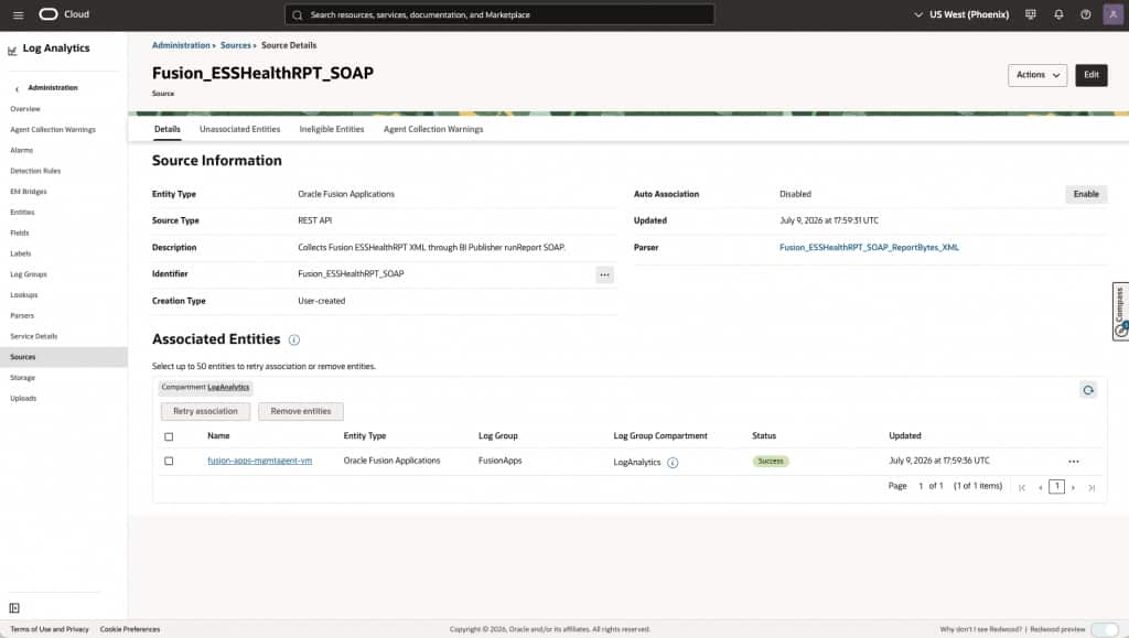

Step 8: Associate and validate the source
Associate and validate the source as follows:
  1. In Log Analytics, navigate to Administration, select Entities, and open the Oracle Fusion Applications entity managed by the collection agent.
  2. Edit the Agent Collection Properties. For the first collection, set Historical Data to ten minutes or one hour and set Enable Filter Duplicate Records to true.
  3. Navigate to Administration, select Sources, and open Fusion_ESSHealthRPT_SOAP.
  4. Select Unassociated Entities, click Add Association, and select the Fusion Applications entity.
  5. Select the Log Analytics log group and submit the association.
Start with a bounded historical interval rather than a large interval such as P30D. A large initial START_TIME range can make the BI Publisher report exceed the Management Agent read timeout.
Confirm that the entity moves to Associated Entities and that its association status is Success.
Figure 8: Verify the successful association between the ESS Health SOAP source and Fusion Applications entity
After the first ten-minute collection interval, run:
'Log Source' = Fusion_ESSHealthRPT_SOAP
| timestats count as Records by 'Log Source'
Inspect several parsed records, not only Original Log Content. Compare request IDs, job names, applications, submitters, execution counters, and timestamps with the bounded BI Publisher report output from Step 5.

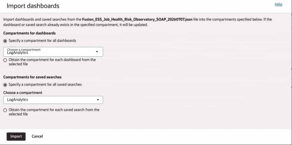

Step 9: Import the ESS dashboard
Dashboards
  -> Overview
  -> Import dashboards
Import Fusion_ESS_Job_Health_Risk_Observatory_SOAP_20260707.json. Select the target compartment for the dashboard and the target compartment for its saved searches, and then select Import.
Figure 9: Select the dashboard and saved-search compartments before importing the ESS Job Health and Risk Observatory
Open Fusion ESS Job Health & Risk Observatory - SOAP and confirm that its widgets return data from Fusion_ESSHealthRPT_SOAP.
To deploy the complementary broad ESS workload dashboard, download the dashboard from GitHub and repeat the import procedure with Oracle_Fusion_Apps_ESS_Analysis_SOAP_20260708.json.
Analyze ESS Workload Distribution and Runtime Behavior
After importing and validating both dashboards, begin with Oracle Fusion Apps Enterprise Scheduler Service (ESS) Analysis - SOAP for broad workload health, then use the ESS Job Health & Risk Observatory to prioritize the job definitions that require investigation.
Figure 10: ESS workload volume, execution health, runtime behavior, and prioritized job risk
Figure 11: ESS workload distribution by application, submitter, process group, execution pattern, and time
After identifying an unusual workload or runtime pattern, operators can use the distribution widgets to determine where that activity originates.
  • Locate workload concentration.
    • ESS_Jobs_By_Application and ESS_Jobs_By_ProcessGroups show which Fusion Applications and processing groups account for the greatest execution volume.
  • Identify workload submitters.
    • ESS_Jobs_By_Submitter identifies the user or service-account identities submitting the most ESS work.
  • Compare execution patterns.
    • ESS_Jobs_ScheduledvsAdhoc shows the balance between scheduled and ad hoc activity.
  • Find recurring workload peaks.
    • ESS_Job_Activity_Heatmap shows when individual jobs are most active, helping operators recognize recurring peaks and overlapping execution patterns.
  • Investigate runtime regression signals.
    • ESS_Runtime_Regression_Drivers and ESS_Runtime_Regression_Distribution distinguish observations associated with recent runtime spikes, high runtime variance, stable behavior, or insufficient history.
  • Assess risk-signal confidence.
    • ESS_Risk_Distribution, ESS_Confidence_Distribution, and ESS_Confidence_Gap_Jobs show how broadly risk is distributed and where limited execution history may weaken confidence in the calculated signals.
  • Investigate jobs that remain alerted.
    • ESS_Active_Alerts shows the latest job-level health record for each alerted job definition, including its current status, recent failures, maximum running duration, severity, alert cause, calculated failure, SLA-breach and stuck-job probabilities, confidence, and request identifiers. A running status alone does not mean that a job is stuck; confirm the signal against its duration, historical baseline, repeated state, and underlying Fusion request.
Together, these widgets provide a practical investigation path: locate workload concentration, identify abnormal runtime behavior, determine the affected application and submitter, and prioritize the jobs that require further analysis.
The activity heatmap represents observed executions rather than configured schedule definitions. Runtime-regression drivers classify the conditions associated with a signal; they do not prove its root cause. Predicted failure probabilities and risk scores are prioritization signals rather than guaranteed outcomes, so operators should confirm the underlying ESS request details before taking corrective action.
For detailed definitions of the report fields, computation scopes, parameters, thresholds, and formulas behind these widgets, see the Report Columns, Query Parameters, and ESS Job Health Signal Calculations sections in Ranveer Tiwari’s ESS Job Health & Risk Observatory article. That article documents the original OIC-based design; use the direct Management Agent SOAP procedure in this article for deployment.
