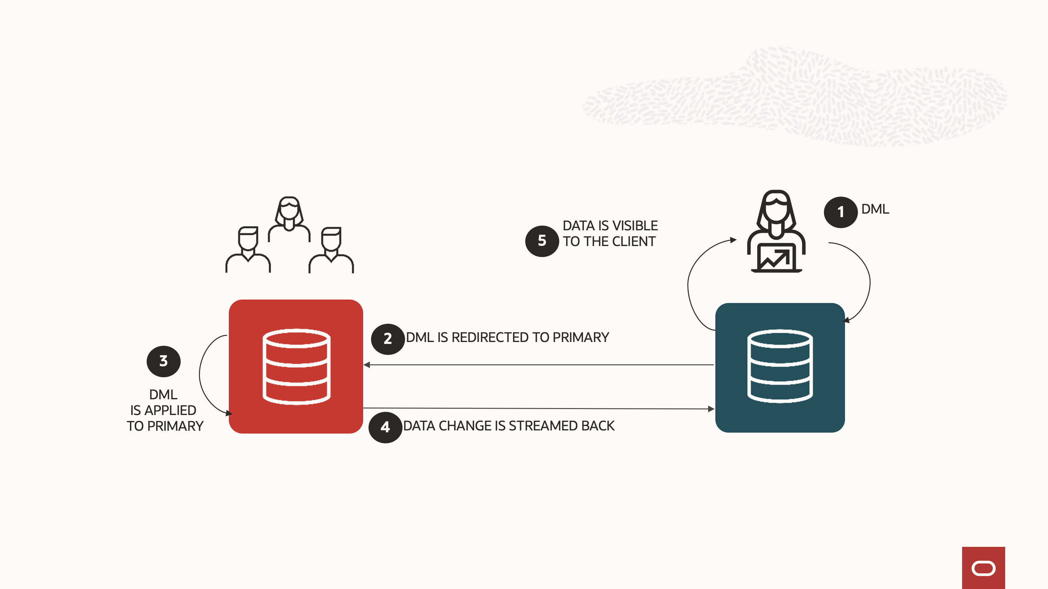

Since Oracle Database 19c, Oracle Active Data Guard further crushes the competitors by letting the applications manipulate data (DML statements) while connected to the standby database. Under the hood, Oracle DML redirection redirects the DMLs to the primary database. The transactions appear to be executed on the standby database but are executed on the primary database. DML redirection guarantees ACID compliance: while the transaction is active, only the session on the standby database can see the modified data until it commits the transaction.
As shown in the image below:
  1. A session connected to the standby database issues the DML statement
  2. The DML is redirected to the primary database using a database link transparently created by DML redirection
  3. The DML is applied to the primary database
  4. The change is streamed back to the standby database with the normal Data Guard replication
  5. The result of the DML is visible in the privacy of the transaction started by the session
  6. Once the session commits the transaction, the data will be visible to the other sessions on the primary and standby databases.
A DML executed by a session on the standby database is transparently redirected to the primary database
